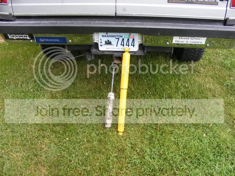

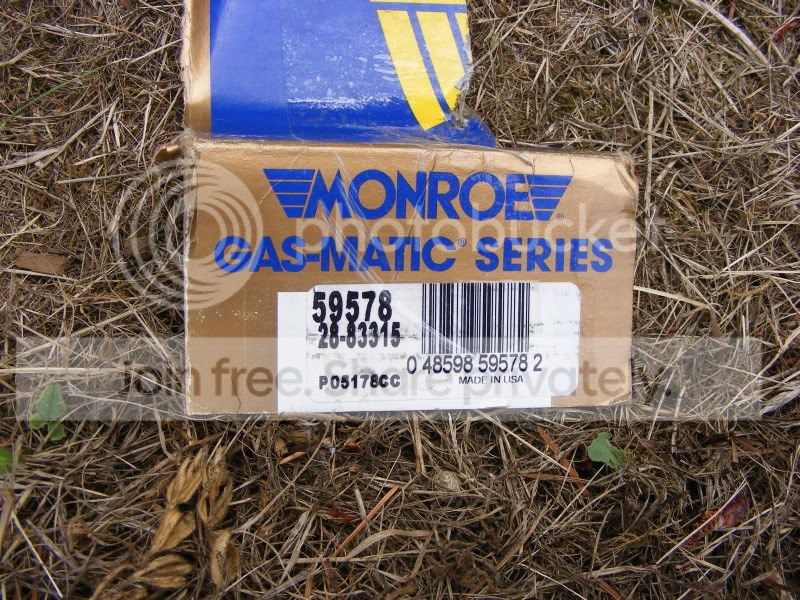

I got tired of the sh!tty procomp hydro shocks I had on my rig so after reading Shawn's bit about stupid duty rear shocks working I went off to the parts store.. settled on a set of Monroe Gas-Matics for an '02 F350 Super Duty c&c 4x4 w/ 7.3L, part number 59578 $25.99 @ Shucks. I decided to only do the fronts for now, the rears seemed okay but they will be next.
And here's a comparison of the 4" lift Pro-Comp versus the Stupid Duty shocks:

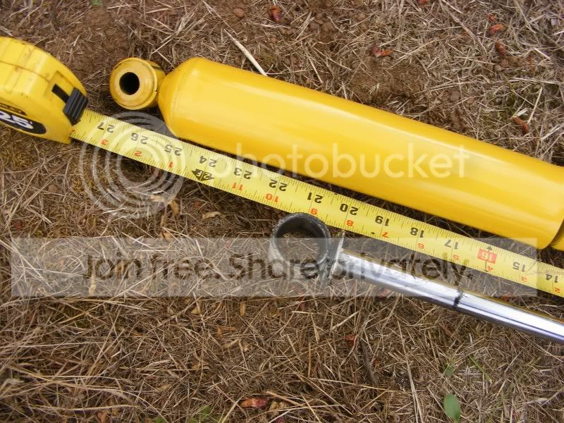

The Monroe's were a good 6" longer than the Pro-Comps.. they measured roughly 27" expanded and 17" collapsed measured center of the eyes.
The only difference between these and the shocks ment for the Chevy is the sleeve in the lower shock eye is slightly too small, I think it must be a 12mm. I took a 1/2" drill bit and drilled them out a bit and it worked. I think my shocks had sat for a while since I couldn't remove the sleeves, but that didn't matter. I had to source my own sleeves for the upper eye but I just scavenged them off the old shocks.
I played with the travel flexing on a few things. Seems to be enough for my needs and my springs are now the limiting factor in my wheel travel, not my shocks, and the ride is 10x better than with the crappy pro-comps.
