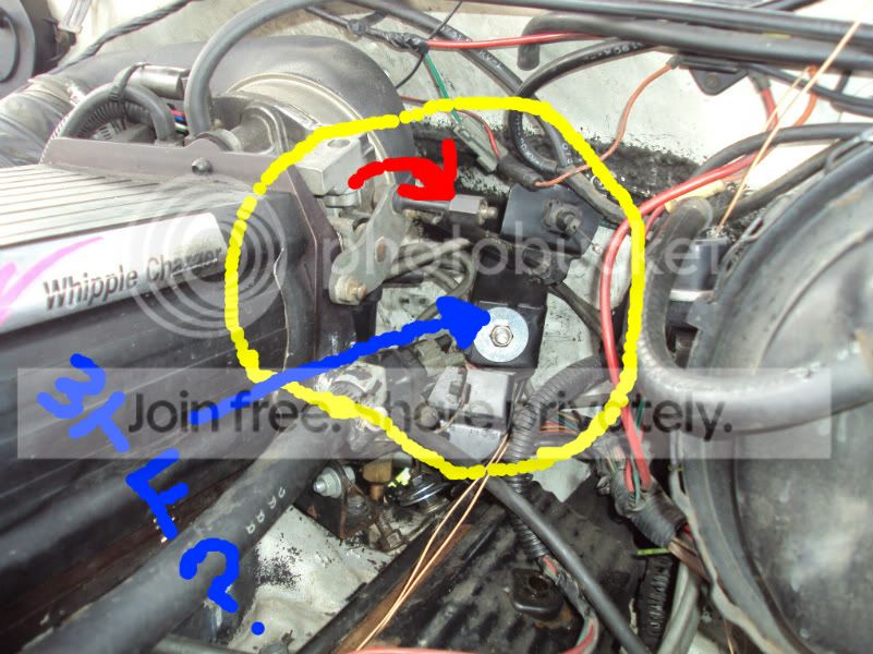

I just snapped a few more photo's. This is kinda why I was considering ditching the SC, return to stock, and selling it for other "upgrades".
I certainly DO NOT want any tranny failures. It seems as the cables are a precise addition to good tranny shifting. Not that i wouldn't mind purchasing the Transmission Valve Body, But as y'all might see in the pics, the situation as of now is less than ideal!:confused:
I am looking for direction at this point. I have been searching for awhile now and can seem to find an appropriate bracket, nor do I think fabing one up would yield the precision required.
The blue indicated the PO's hand work of a bracket.
Anyone want to enlighten me as to the function of the two cables? Is one the TV and the second (disconnected) a drop down cable?
The red arrow obviously indicates the rotation of the linkage, has mostly slack on the connected cable about 70% of the way .
Thanks for everyone's patients and help!
Kyle
Your probably right. I didn't even think to check. I assumed it would have a ridged rod type connection lol So that would mean the 2nd cable would be the TV cable. Which is not connected!
