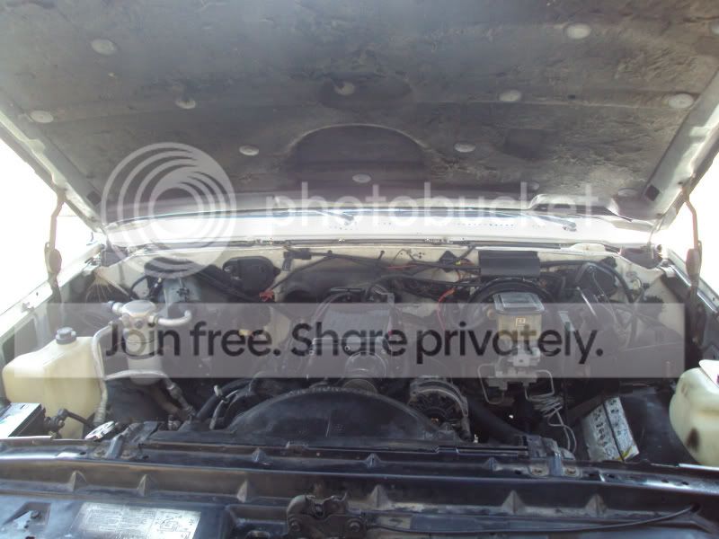

I wasn't able to see the pics on the earlier pages. Do you have an overall pic of the engine bay?

How's that?? I will most certainly be posting how how it all works out! I have had a chevy truck before but never a burb, I can tell ya i like the way it felt on the way home :waytogo:
I took out the POS intake set up the PO had in it before so it's obviously not in the pic. I am currently building one outta PVC between the SC and the air filter, true cold/cool air! :thumb:

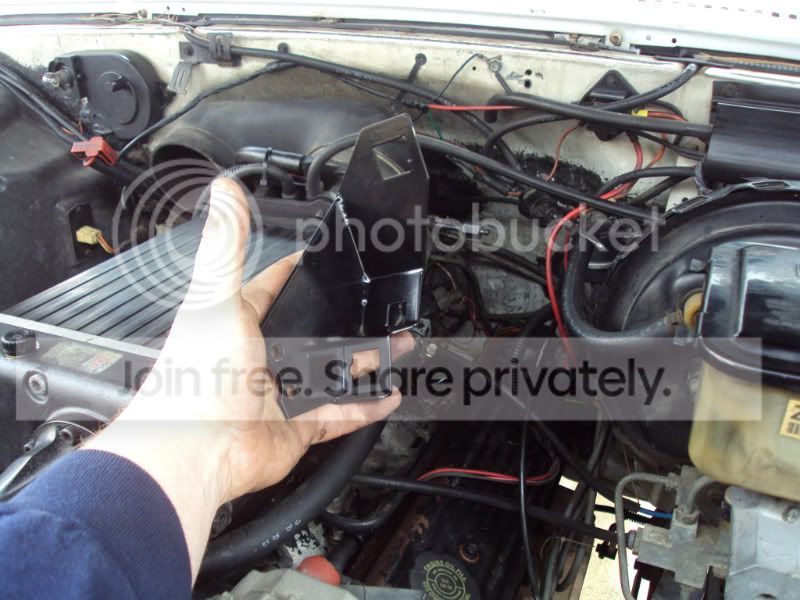

Super charger bracket arrived!

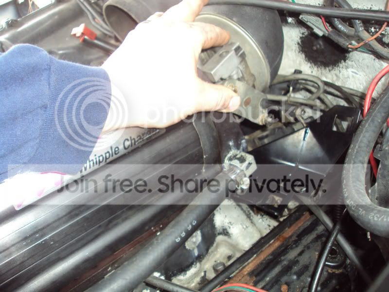

Ok so the man brings my supercharger throttle bracket today! No, for the life of me I cant piece the dang thing together!
The install manual says:
" Step 38: All of the control cables route under the main wire loom. Route the cruise control cable under the power brake vaccum tube and replace the bracket bolt. NOTE; Install all of the cables to the throttle bracket before attatching the bracket to the throttle body adapter. If readjustment is neccessary after reattaching the cables consult a G.M. Shop Manual."
" Step 39: Install the throttle bracket, supplied with the kit,to rear the rear supercharger manifold, just below 90 deg. water fittings with the two 1/4" studs and lock nuts."
That is a direct quote and all it says in the whole manual. :dunno:
Y'all see something I'm not seeing???? Anyone have a pic of there stock TBI cable setup by chance? Man this is frustrating me :crazy:
Oh BTW, I found the original, exact same bracket I just ordered welded to the old Cruise control :whistle:
wtf, kinda english class did these people take? :eek1:
are there any corresponding bolt spots on the rear, or rear side of the charger itself, that match up to the 2 holes where your palm is? that is the implication, install some studs, holes are 1/4... thats certainly not something you'd bolt to the last 2 bolts of the intake like most brackets.. the holes aren't even close to right...

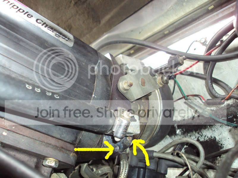

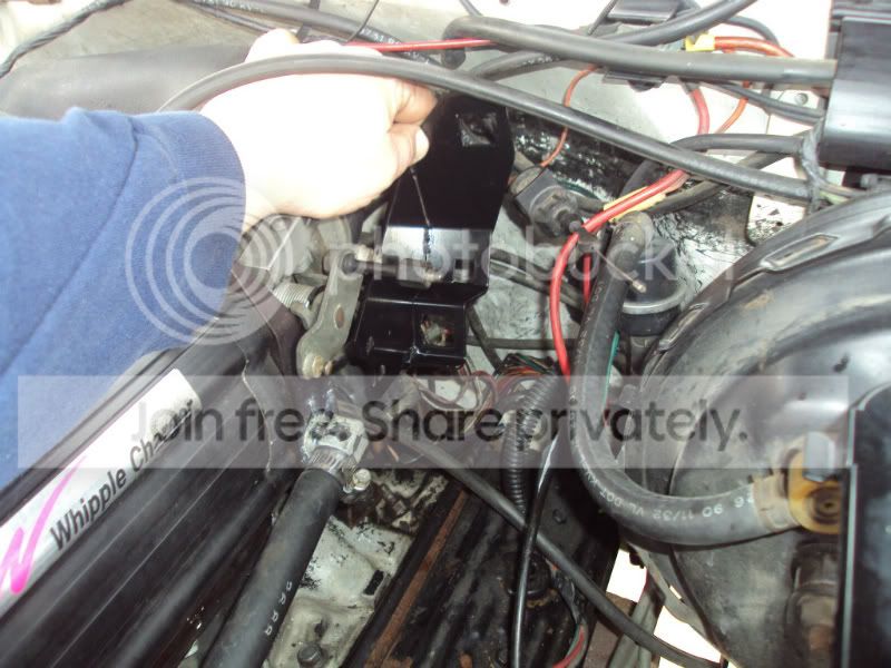

This is what I found. I believe this is the way they want it positioned.
The yellow arrows show the " 1/4 studs " the speak of. The top was was apparently snapped of, the bottom is missing. I can find replacements but the top is going to be all kinds of ..... well, all I can do is try the extractor tool thing. If I can't get it I'm thinking make a brace against the fire wall maybe.

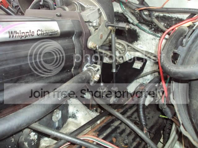

ryoken, This angle compared to stock is way off but looks like it'll all be in a straight line. what you think?
WOT:
yup, absolutely....
looks like you'll have to spin that fitting out to work on the one... housing is alum correct? might wanna try a little heat to the surrounding area, good shock shot with a heavy hammer and quality center punch, followed by a lefthand drillbit.. me bet's that would get it... obviously be careful with alum...
Yessir, what I'm thinking too. I found a 1/4'' bolt with the right threads, I'm going to the store now to pick up a couple shorter grade 8's. Post up when I get this far :bow:
I would go with studs if you can.. either stainless or hardened steel... dab of blue loctite... it's 1/4/20, super easy to find...
Negative. The engine moves independantly of the firewall. Control cables need to be anchored to the engine or some part of it.
Worst case, if you can't get the broken bolt out, drill it bigger and heli coil it. Or even tap it for the next size up and drill the hole in the bracket accordingly.

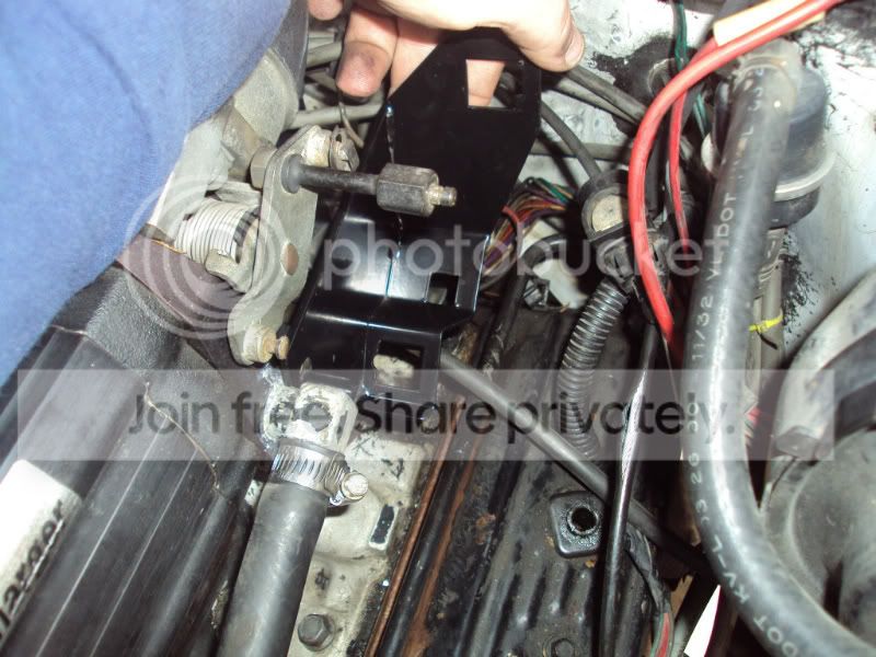

Understood, Makes perfect since.. I got the easyouts and reversed drill bits already, just don't have the drill that will fit between the brake booster dude.:shame:

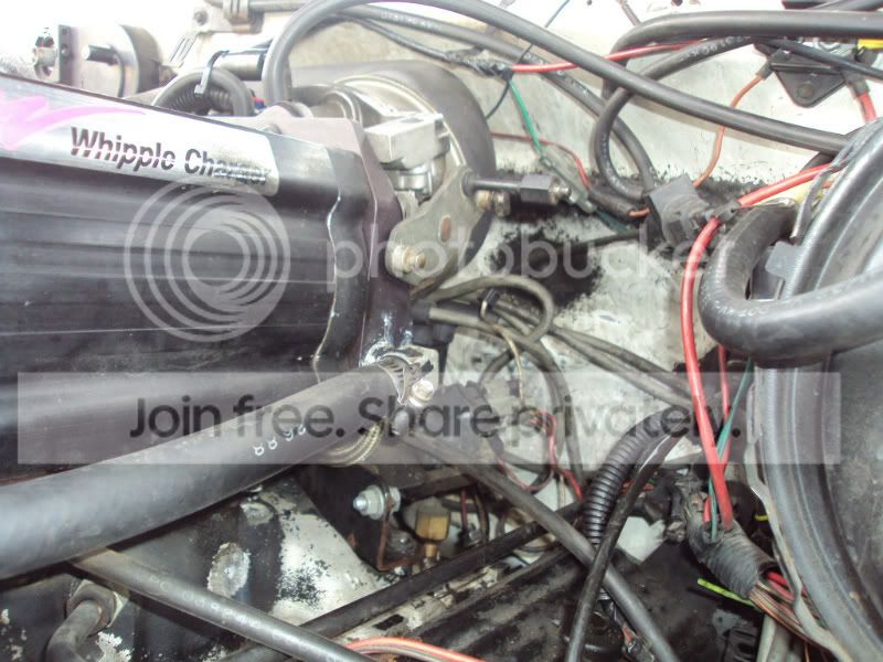

This is where I'm at so far.
Kind of a "Mock up" . I replace the accelerator cable too.
I don't have then clip for the TV Cable either.. I have a feeling that's going to be quite the inconvenience. :mad1:
