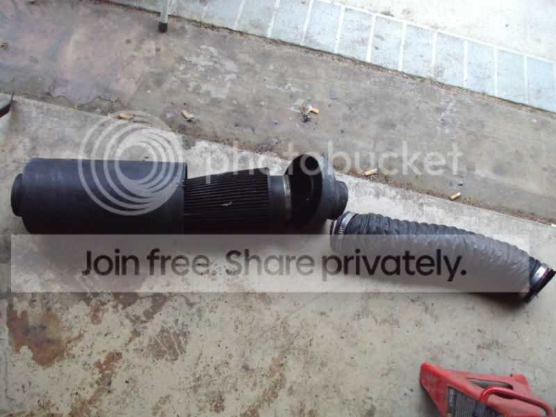

First things first , lets remove the monstrosity of a air intake!
Done. Wander how much air it was really getting?? :dunno:
Made quick work of the PO's BS bracket and all the one bolt and small screw holding it in..

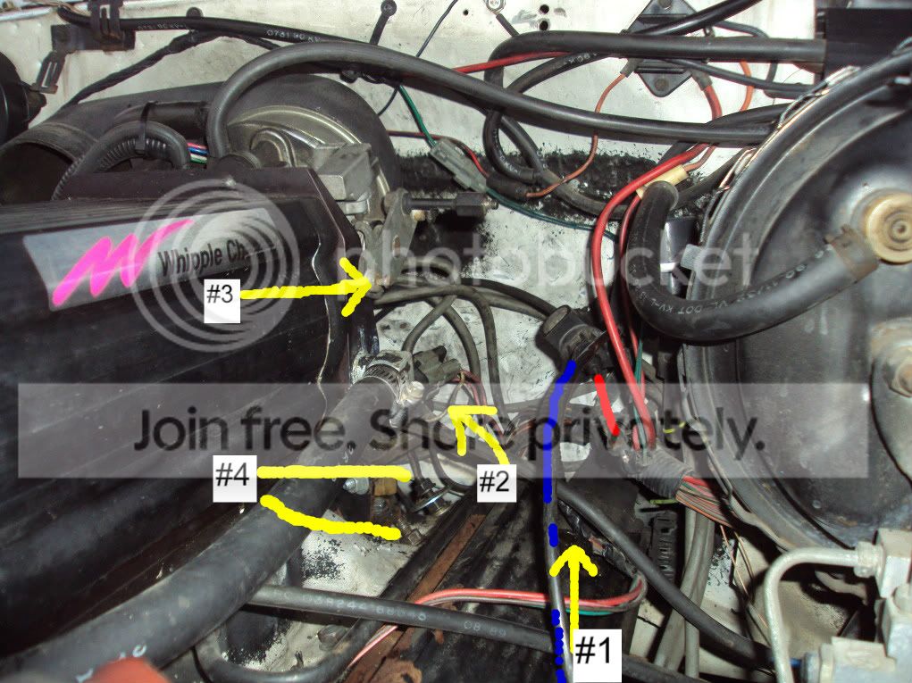

Questions..
#1 I'm pretty sure something needs to go here, like a PCV but its on the other side.
#2 This white wire which has a plug is disconnected. Is from the bigger grey looking plug. ( I didn't do it :dunno:)
#3 I'm thinking this is were the TC cable should ultimately be connected?
#4 Are these two bolts okay for a foundation? The rear most bolt was used with the PO's bracket.

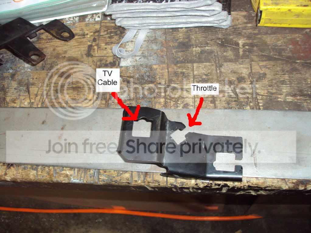

Red line shows the TV, Blue the throttle cable. It need replacing, It was wound up like an extension cord and frayed, split etc.

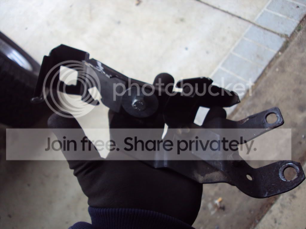

The "other guys" bracket.. Look familiar? I'm saving it to trace for TV cable and Throttle holes.
So just to make sure I am understanding correctly, I BASICALLY need a bracket that sits square, parallel etc with in the specs by the links provided with what is now the linkage? Like what would be in it's stock configuration.?

wow, that bracket looks a 12 yr old's erector set project...
if it where me and the top holes where good, I'd see about just lopping that whole top section off at the next bend and just fully weld that on to a new fabbed lower..
:woot:
yeah, wtf is the other tv looking hole for? maybe trim that off... maybe get some strip steel or angle iron from homo depot or something, make a template, measure thrice, cut and burn em all together...
oh, i see that was a bolt there.. wow, hokey, no slop there....... maybe use the lowest bracket for the 2 intake bolts welded to your piece, then that one...
"yeah, wtf is the other tv looking hole for? maybe trim that off... maybe get some strip steel or angle iron from homo depot or something, make a template, measure thrice, cut and burn em all together... "
YuuuuuP! Was guuna use that scrap piece I had it laying on.
"wow, hokey, no slop there...."
YuuuUuUUP!

The hole in the drivers side valve cover... The PCV valve should be on the pass side, that is correct. The hole in the drivers side cover is for fresh air to enter the crank case. On the factory set up there was a tube that stuck into that hole and connected to a fitting under the air cleaner, not directly to the throttle body (non vacuum but after the air filter). You could find a filtered breather cap that will fit in there or connect a hose from there to the intake tube.
