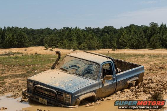

in 1989 My truck was originally a 1979 chevy k20 with 350/t400/np203/d44/14bff/3:73. Wheeled the crap out of it. no lockers, 33s with body lift... I knew my limits, got stuck often but had fun and the drivetrain never broke. had a b&m stage ii shift kit in it and it would rip your head off manually shifting on the column
1992
One day I'm driving down the road and this truck is on the side of the road with a FS sign on it. Hideous green ....
I crawl under it and on the d44 tag it says 4.56 ... woot...
so I buy it for $500...
1978 chevy k20 camper special 8400gvrw
swapped my body parts over cuz that other one was rusted apart. Guy said his son got mad at him and drove it into the atlantic ocean.. LOL
350/sm465/np205/d44/14bff/4:56
WOW the power with 33s.. was amazing. wheeled it hard and lots of clutch drops and drivetrain never broke.
since then d60 up front, detroits, 40" hawgs (38.8) on 12" steel rims... and a torquey 1991 sbc and still nothing has broken other than me shattering a rear ring gear (my fault)....
so hard for me to give you a good reason to go NP205... it is gear driven so I would prefer it myself over chain and saw a video on youtube.. guy did a rebuild on his desk and looked stupid easy...
