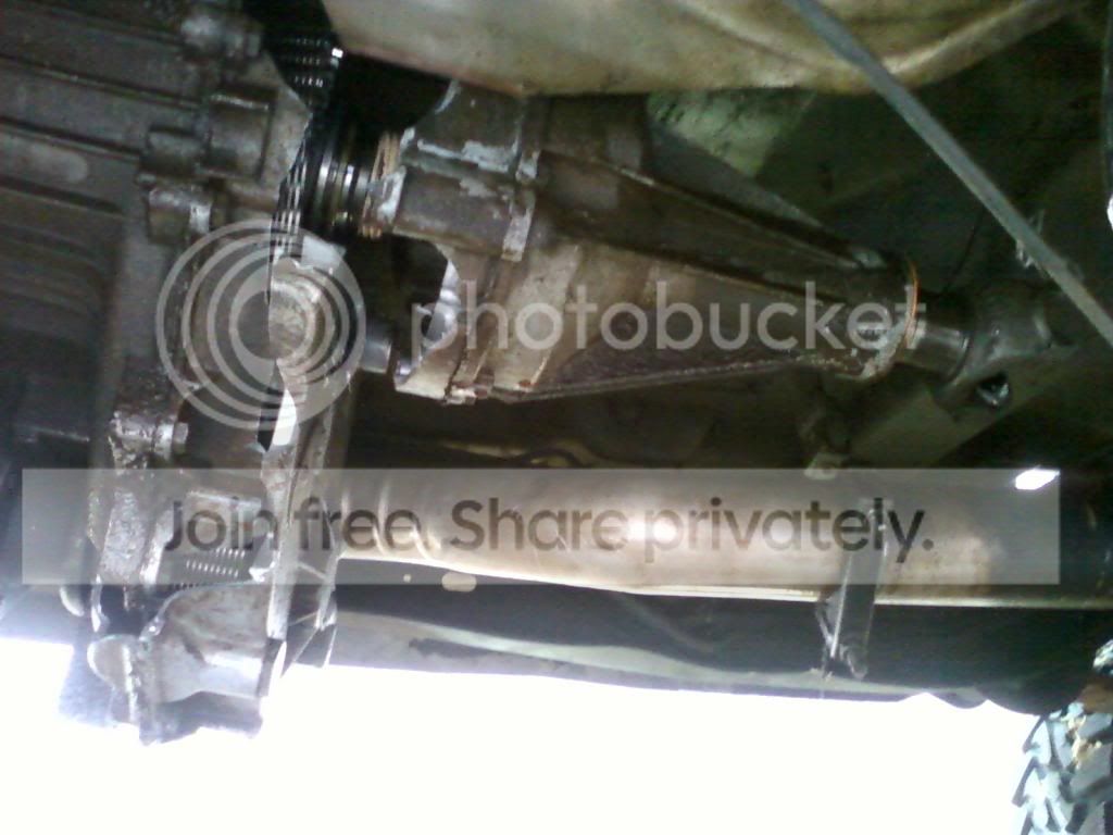

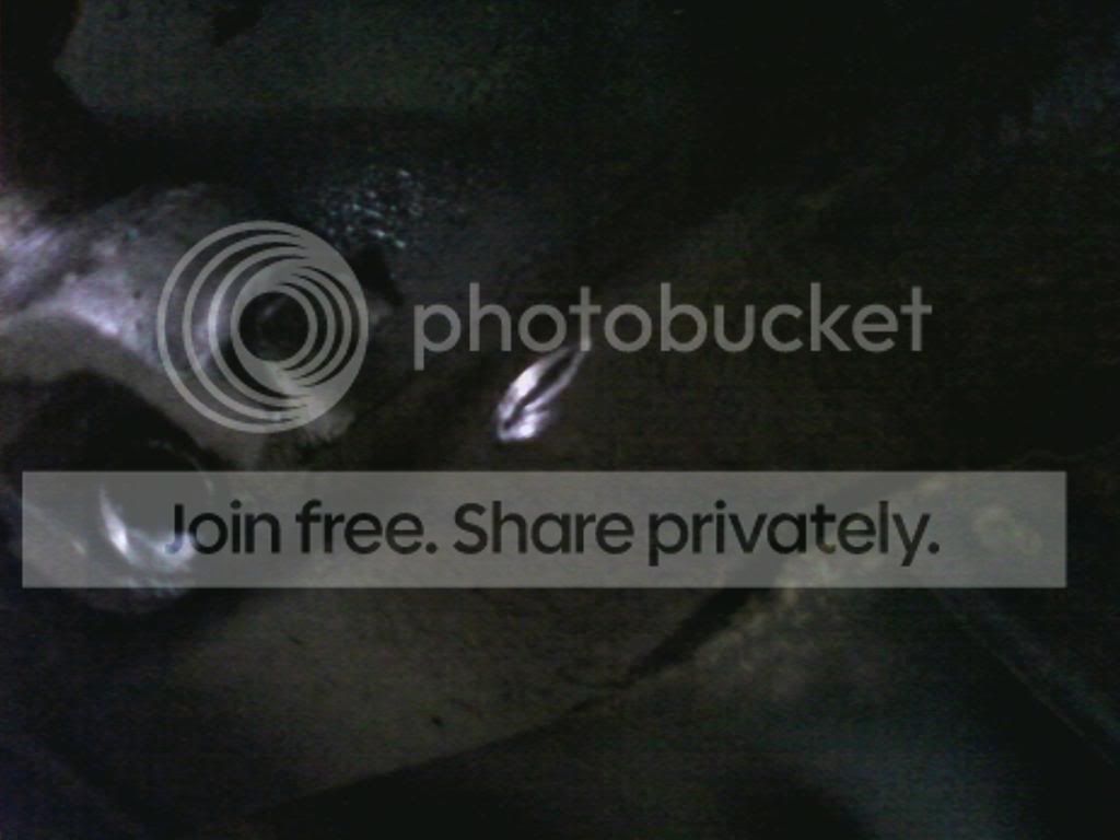

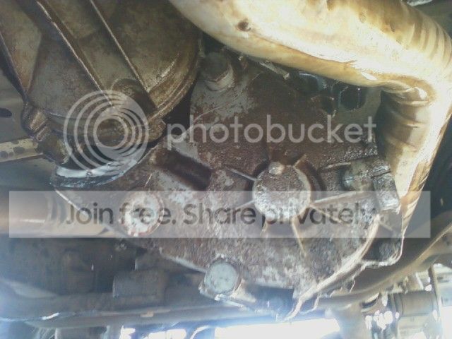

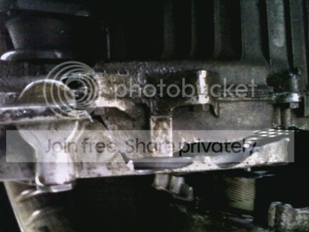

Coming home form The Old Man's house the other day, after discussing with him about certain a noise i had, this happened:
...on the highway. The 4" blocks in the rear prevented my DS from contacting the ground, by a mere few inches. So, kids, get a lift kit and/or a DS u-bolt so your DS doesn't end up being repurposed as a pogostick for your truck!

I've never heard of a 208 converted to all gear . Yours is a 208.
How are your motor and tranny mounts? Does your front driveshaft slip work and not bind? Were all the bolts tight? Was it full of fluid?

The cause is not the problem. What to do henceforth is the present quandary. As stated, i was on the highway, and the front DS was not connected, nor was the slip present, nor was it engaged. The RE had no binding issues. Engine mounts are new and solid, and the tranny can't be moved by anything other than an IED.
I make damned sure the transmission and Tcase are well lubed. I fully realize the import. I had been having this "strange sound" under certain conditions at highway speeds for a very long time, i knew that it was the sound of an unhappy bearing. Of which, i had no idea, as the sound could only be reproduced under a load.
Cause? i don't care for cause. I'm quite sure age and use are the culprit of the demise.

I know you want to get it back together, but to me, cause is a big deal. Otherwise, you may get the result the second time. With that kind of damage, there are a few immediate suspects - u-joint failure, seized bearing, bad driveline angle, slip yoke bottomed out, etc.
As for the repair, if you're going with some weird fixed-yoke case, that's fine but it's a custom job. You're either going to have to swap around parts to get the proper input shaft and tailhousing length, or maybe bolt it up as-is and measure for new driveshaft. Either way, I'm not much help. I've only played with a regular chevy 208.

The case you broke is an NP208 and there is no gear driven NP208, ever, anywhere. He probably has a 203 (chain driven) or 205 (gear driven). The gear driven 205 is far from a bolt on in your situation, but it can be done.
I'd be scared to see an aluminum cased, gear driven transfer case. I can only see bad coming from that in the form of a cracked/shattered case from the deflection of the gears.
Yeah, your friend either doesn't know what he has, or what he is talking about. Possibly both.
An NP208 behind an SM465 has a 32 spline input. The same as one used with a TH400. An NP208 used with a TH350 or TH700R4 will have a 27 spline input.
