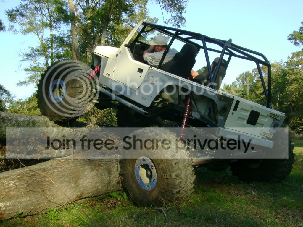

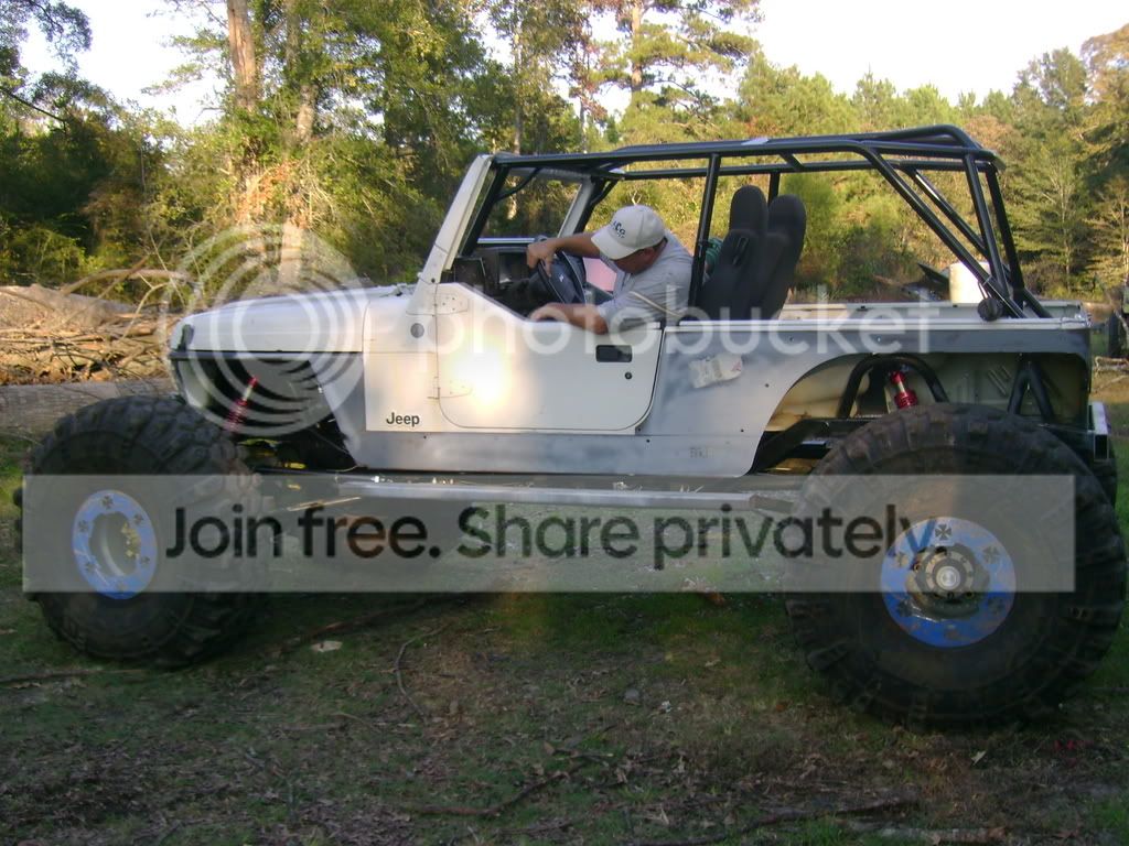

Here are all the specs on that jeep unlimitied from the guy that built it.
2.5 Ton Rockwell Axles
Front and Rear Steering By PSC motorsports & Old Town Customs
Stak 3 Speed Transfer case
Race Runner Coil over Shocks
Nitrogen Bump Stops
Driveshaft's by Tom Woods
4 Link Suspension Front and Rear w/ 1.25 Heims w/ 250 wall DOM Tubing
Stazworks Beadlock Wheels w/47" Super Swamper LTB's
Poison Spider Cage OEM Violator 2" Axles in the REAR w/OEM Lockers in Both
Blue Torch Fab Body Armor and Suspension Products Warn 9500 pd Winch
Those damn 2" axles are MASSIVE!!! If you do ever get a chance to this thing in person look underneath it at the skid plate. It has about 2 weeks of work into it. All of the bolt head are recessed and it is all 1/4 plate. It is a work of art.
