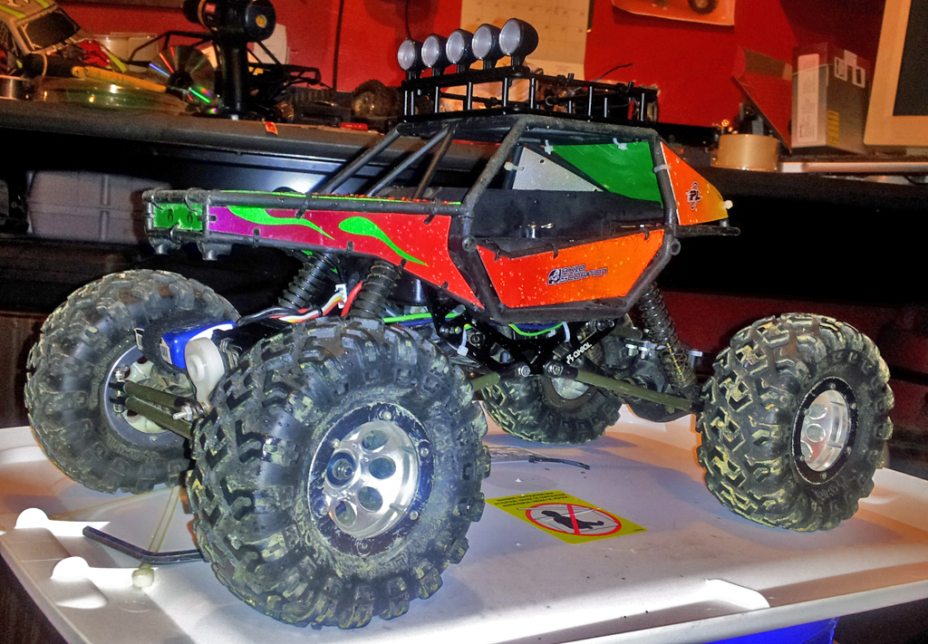

How my Axial based Crawler turned out :waytogo:

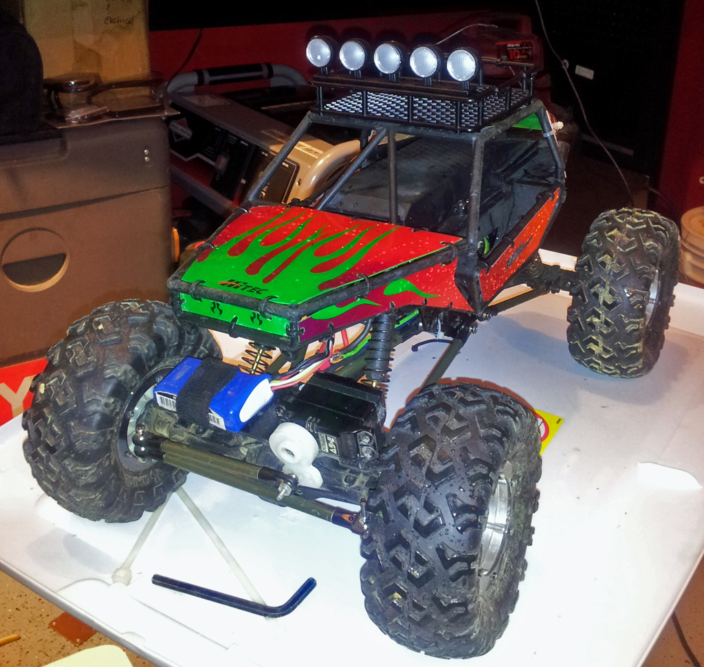

finally got mine almost done... it will get rear steer eventually and a 35t motor..
for now 27t stock on 3s:whistle:... 16t/87t gearing
just got a deal on a proline tuber with panels... got lights from someone else.. bought the roof rack..
will mostly be waterproof...
used a radio shack diy box for esc... need to seal up where i drilled for the wires...
need to figure out a small box for the castle bec and rx located in the back...
cant wait to get some action shots now... but for now.. some
"In The Shop" poser shots...

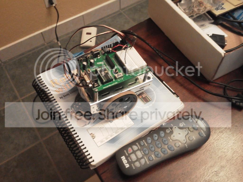

This is what i've managed to work up so far for the school robotics project. Its just the basic model assembled following directions. I'm using an IR reciever on the Robot like found in many of our household entertainment devices and using a tv remote to match up to it which has been programmed to a sony tv since sony tv's recieve their signals in binary code its the easiest to work with. For all intents and purposes of passing the class im fairly sure im done. Providing that an IR signal will work in sunlight (i've been told it can either distort it or completely block it out.) in which case i'd need to figure something out. Find that out with the morning light though.

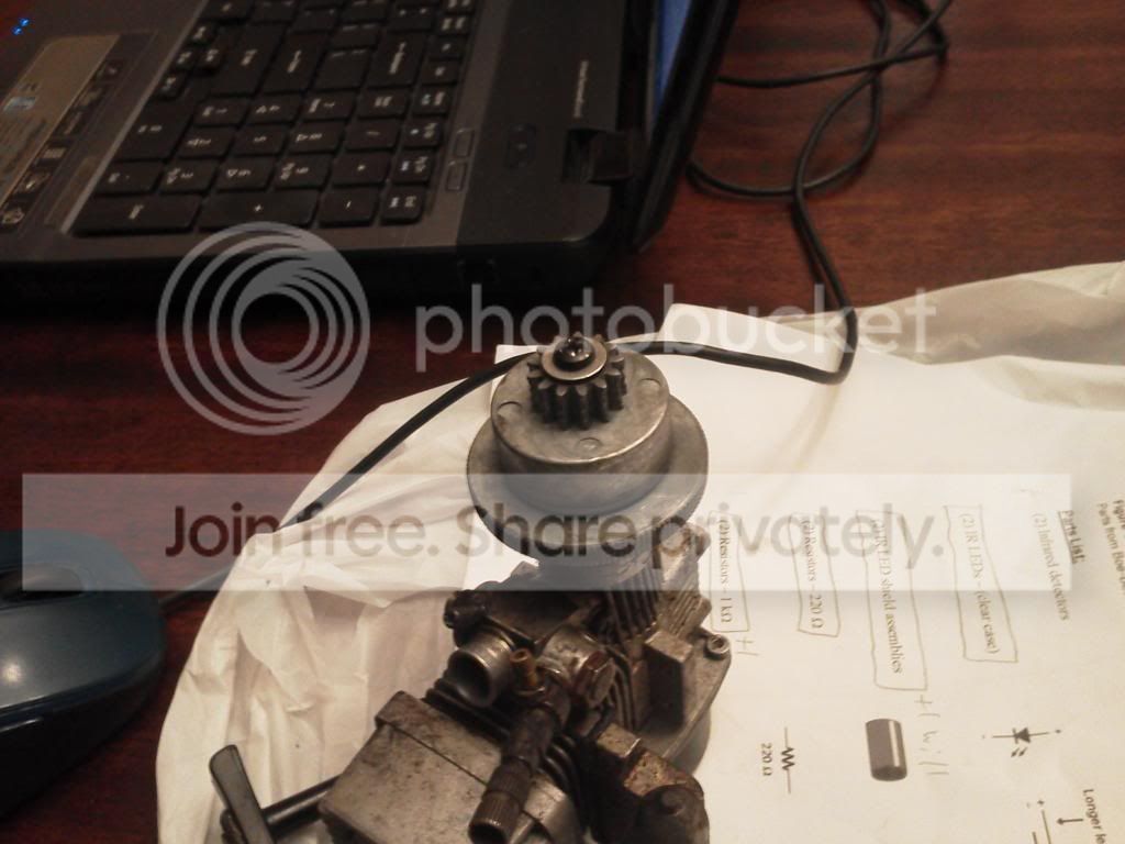

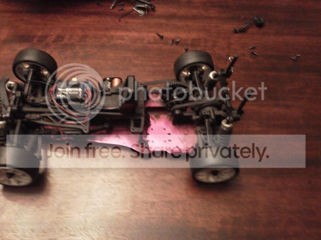

The fun project i'm working on is this. Its my HPI RS4. Due to a decimated Butterfly valve the engine is unusable,and since our race is around campus i'd like to use a electric motor for the noise level as well. I go to the Local hobby store tonight to look for an electric motor with a similair bolt pattern to the floor and equal length if possible. If they are to be believed the ''only'' way to perform such a change is by rearranging the entire car to work around it buying a new chassis and so on.
Since thats obviously not an option and this car really only needs to run a couple hundred feet i pulled some crap off to get a better look and im thinking if i managed to find a gear that would match the gear which came off the motor and managed to attach it onto the shaft of a DC motor i could be in business. Now as far as powering the DC motor since i already have a program to run two servo motors i was thinking of using my current throttle servo to turn a poteniometer and that would act as my throttle response. If i could use my current controller and reciever for this car at 27.145mhz the actions would be far smoother since im really only using a For If command on the board seen on the previous robot that determines which button is being pressed by the pulse lengths and then acts on a set of preprogrammed commands once it recieves that signal which is cool, But it doesnt give you the smooth and gradual servo response. I have no idea how i would program it to operate gradually on a frequency though short of programming hundreds of if then commands :dunno:. I dont quite get how the gears mount to the DC motors shaft though? I need a positive lock to put enough power through this thing to make it work and it looks like that is achieved by getting a shaft and gear with matching notches in them but i havent had any luck finding them for sale like that.
Anyone know where i can get a small DC motor with a matching gear similair to this one or just the gear itself would be helpful.
Picture of said gear
