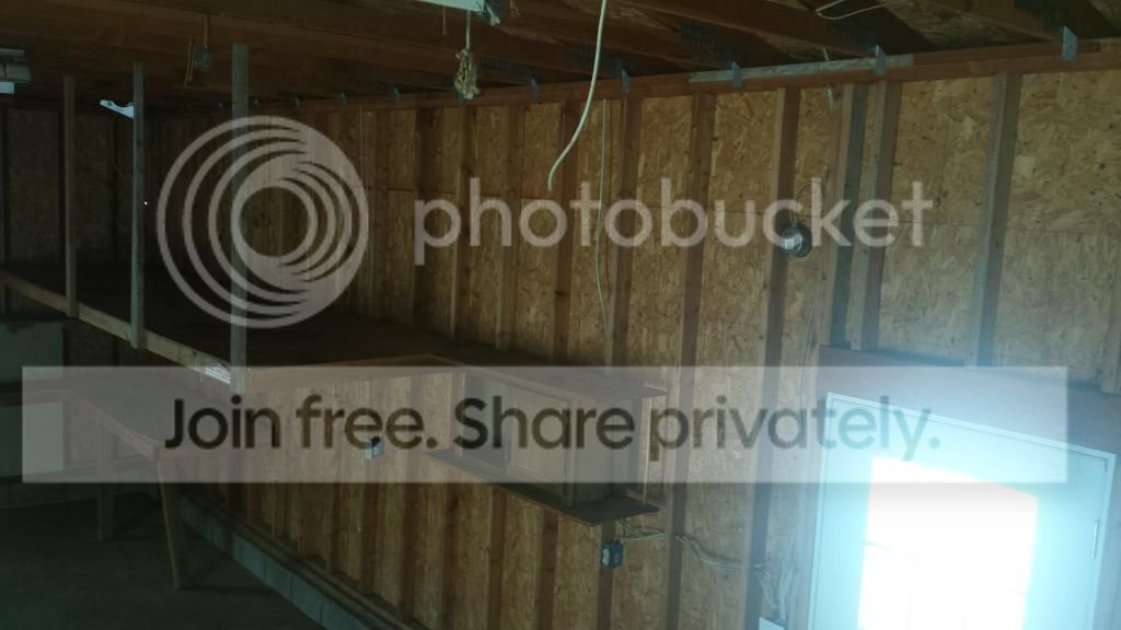

This pic is from last year but it's the same space
It's soul sucking to work in there in colder temps so since I needed to work on stuff over the winter it just became a bigger and bigger mess.

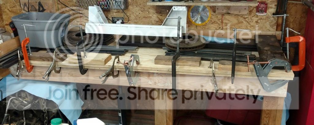

So my vague direction with this bench rebuild increases in detail.
I've always thought adding mass to a bench would help with the inevitable bounce. You know hit the top with a hammer and everything bounces. So random cut boards got places.
Only new thing I bought for this was the plywood for the top.
So right before I put the top on
The 2x6 against the wall is to provide a solid space to put something against and to space out the top so it extends about 2" over the edge to be able to clamp stuff.
First layer
The second layer I'm gonna glue on. No screws. I dont have enough glue here to do so. Off to the store tommorow. Here's what it should look like all finished up.
Apollo approves.
