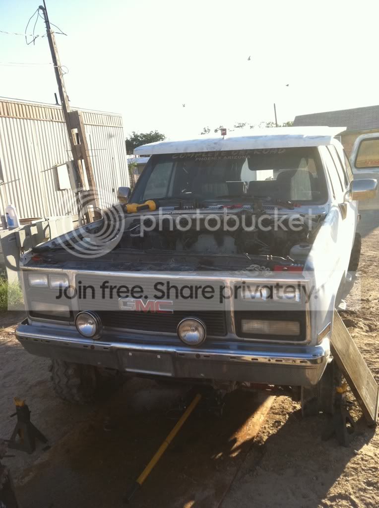

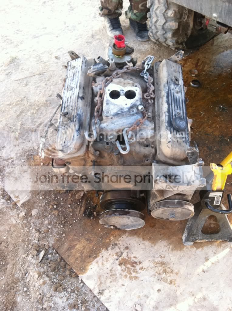

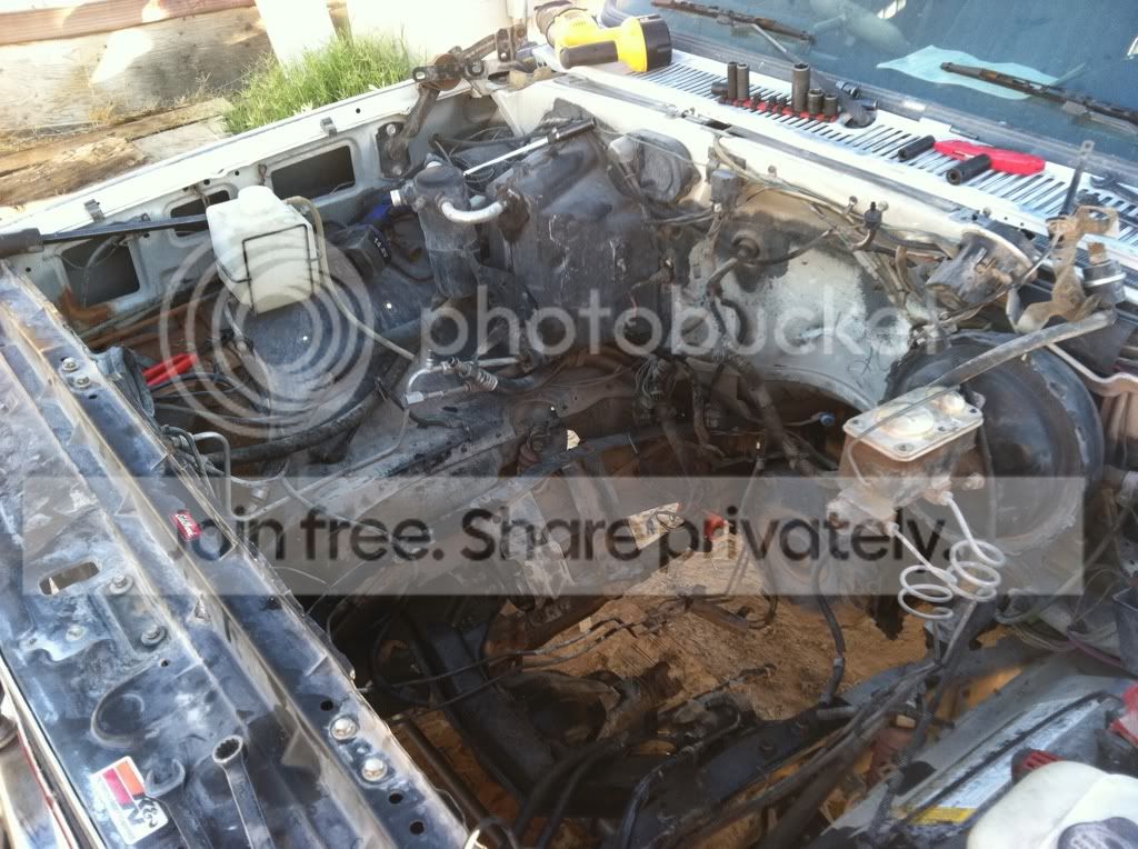

the engine is out! took about 5-6hrs today, i forgot how damn easy these old things are to work on!! well, compared to the diesel buses i wrench on at work. my free cherry picker took a **** on me but i got it out. we lifted it and couldn't clear the core support. so we set it back down to shorten up the chain and on the way back up the cylinder started leaking really bad. i pumped it like hell and got it over the core support then it came crashing down to the ground, barely made it out. i'll have to get a new cylinder from harbor freight to get it over to my house and get it torn down.
i'll be picking up the tires next week. once its sitting on some decent tires i'll bring it over to my house to its new home in the drieway. where i'll start on all the other stuff like cleaning the fuel tank and interior, sanding the body, replacing door seals/window guides/weatherstrip, etc...
and i'm not sure i'll even bother tearing apart the engine. talked to a reman shop and a dealership about prices today. it just doesn't seem cost effective to build the engine myself.
the Chevy dealer wants $2200 for a stock replacement engine, no core charge, 3yr/100k warranty.
a local, well known engine reman shop wants $1195 for a stock replacement engine, with core charge, 7yr/100k warranty and they'll install the cam and intake etc i want when they assemble it at no extra charge. they'll take half the $ up front and the other half when i pick up the engine. they offered to give me a tour of their machine shop too.
