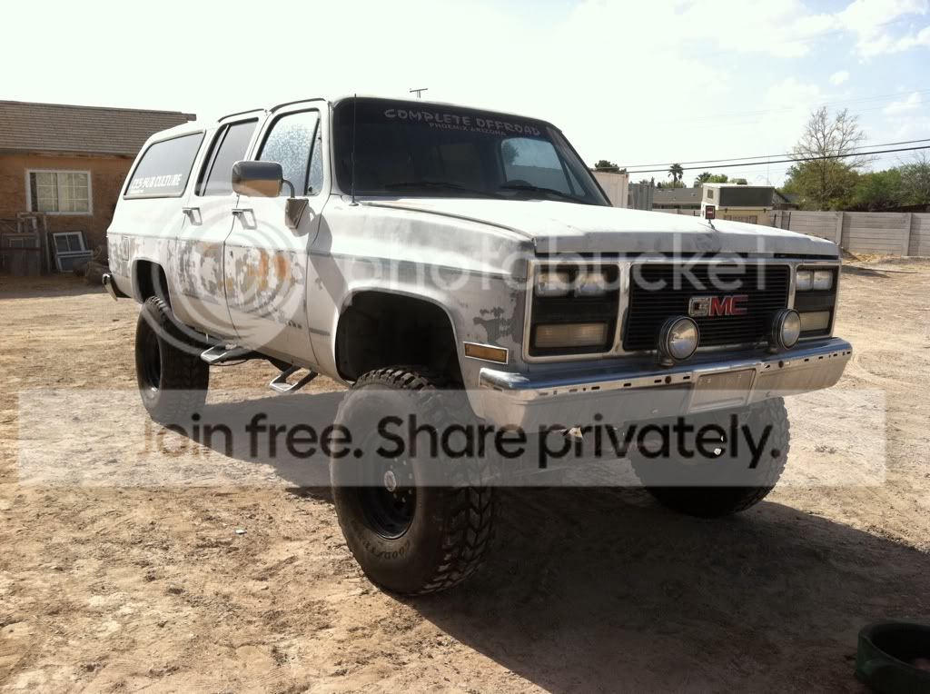

we went to Lucern Valley Commiefornia yesterday and got my tires from 100 dollar man. even at 50% theyre better looking than i expected. took em to my friend's tire shop and they mounted them up for me. but couldnt get the beads seated. (F**KIN 16.5s!) so today i'm going to a friend's house, he has a compressor, and we're gonna hit em with starting fluid. it better work, i can't afford bead locks yet.
I went to my dad's house and my brother and I got the tires seated and bolted on today! did the brake cleaner/lighter trick, worked like a charm. except for the spare. my old spare was a 14.5" wide swamper SSR, the wheel is 10" wide. we couldn't get the stiff 12.5" tire to seat on it. no big deal I'll buy another 8" wheel and get it done and film it this time.
it feels SO good to see her sitting on her own 4 feet. I really don't know wtf I was thinking trying to sell this truck...
it even rolled 10' or so...
oh and if anyone has a spare 8 lug 16.5 wheel in the 8" wide range, i need one.
Next up is front brake lines. One of them got badly dryrotted and the swamper hit it when we dragged it across the yard. After I got the new tires on it I stepped on the brake pedal to find it dropping clear to the floor, pass front line blew. I've got spares so I'll get them installed Wednesday morning.
Then replace the brand new valve stem that blew out of the drivers rear wheel and get the tire reseated. Check this out, I found the inside on the valve stem in the dirt 10' away.
