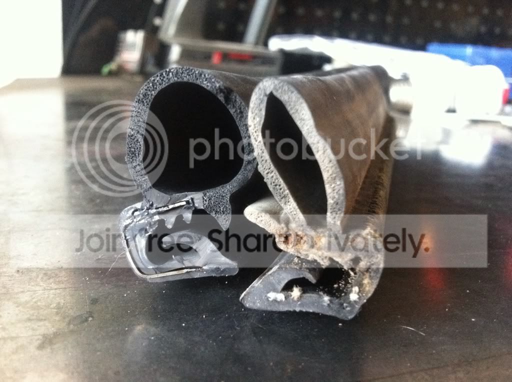

my big box of door seals from classic parts showed up friday, we had a big (95 people) BBQ at my parent's house yesterday so the weekend was shot with that. i finally got around to replacing door seals today, i got the rear doors and the drivers door done. they're good quality, exact replicas of the original GM parts, i was fairly impressed. they are however, pretty stiff. i imagine any brand new door seal is and it will take time for them to flatten out a bit and let the doors close easier. i managed to only break one interior panel, the A-pillar cover where it goes forward to the windshield on the bottom. i super glued it back on once everything was installed, we'll see tomorrow if it held, i'll try to get the other three doors done tomorrow.

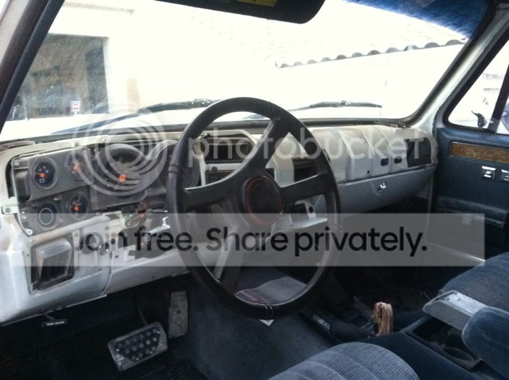

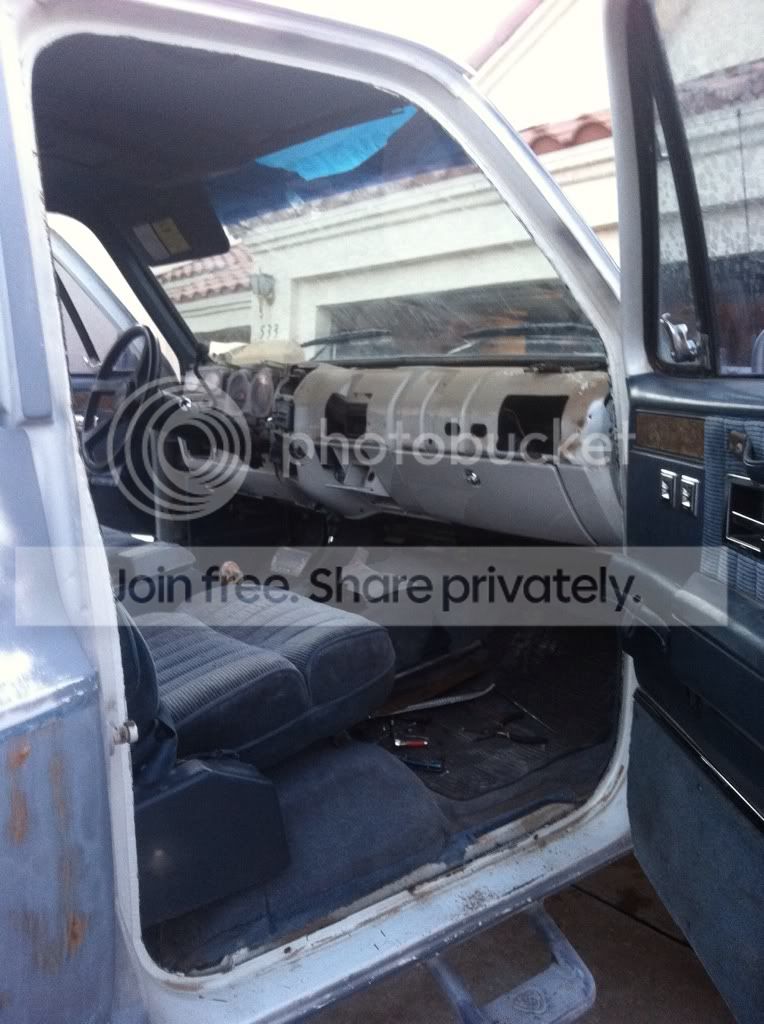

i got the back drivers side door all done and tore apart the pass side. went ahead and pulled the dash pad to make the a-pillars easier, since i broke the drivers side one. that thing is pretty much ****ed but a new one isnt happening, thats too much money that could go towards getting it running. and ive got a nice dash cover for it in the mean time.
the door seals from classic parts are really nice.
i hate interior work, i'm a heavy equipment mechanic for a reason...
i just might replace the dash speakers while ive got it apart.
Easier to change 'em now than do it later. plus their cheap
Im with you. Hate interior work with a passion, stayed as far away as I could when I worked in the dealership. Might as well do the speakers now, for the price of them its really not worth doing them later and pulling that dash pad again.
Yeah I'm gonna order some tonight.
I'm trying to fix the a-pillar panel that I broke, CA glue from my RC cars didn't do it so now I'm using shoe goo. That **** fixes everything, hopefully.
I like the seals Scott, they fit pretty good eh?
They fit great. Every one has had 1-6" of extra length which is nice. The back side doors close perfectly with the new seals. The front doors need a little bit of force but they'll break in over time. The back door seals were pretty stiff too but 4 days later they work great.
