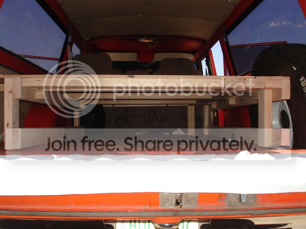

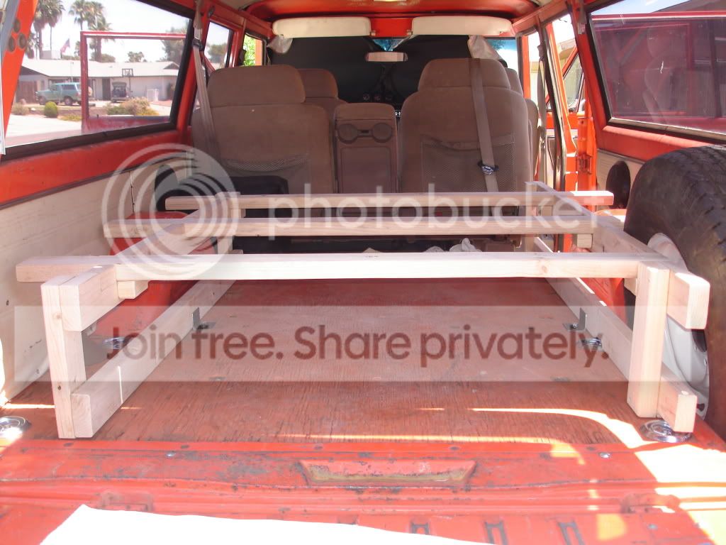

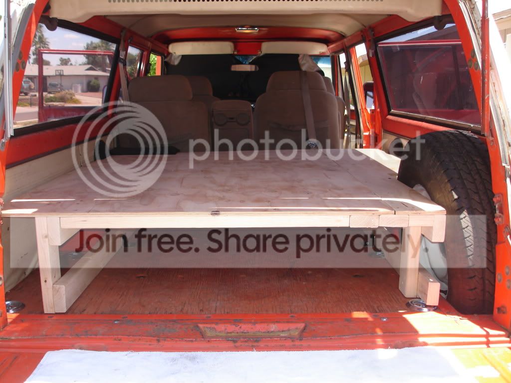

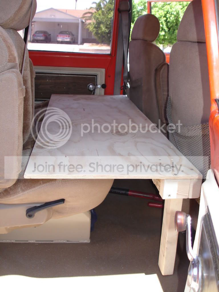

In the middle of June I did a carpentry project on it. I built a structure that would be used in the near future.
Base structure:
Top sheeting:
Basement storage:
Now, other than the two bolts attaching the base to a couple seat bolt holes, the entire structure is keyed together--no tools required to remove/disassemble. The really cool thing is that it doesn't rattle or squeak. With the exception of the one 4' wide chunk of plywood, the whole deal stacks up into a space of about 16 x 16 x 60.
So, that takes care of sleeping arrangements for the Missus and me, but I had to come up with something for the boy. Roof-top dwelling momentarily crossed my mind, but I figured I'd lose that sale with two votes against me, one of which being female, so I set to work figuring out something for him. I decided he had to sleep somehow on the rear seat. The seat itself was too narrow, but with a platform of his own, it could be made to work. I took some measurements of him and ripped a chunk of plywood that should fit well, added a couple legs that are keyed in place (no tools needed) and came up with this:
It works great and it actually has some room for growth. I sanded everything so as not to find a splinter in the dark woods. I also added a couple tie-down points for the cooler at the very back of the rear platform. I put some of that floor cushion stuff with the diamond plate texture on the platform to keep loaded goods from rattling around while in transit.

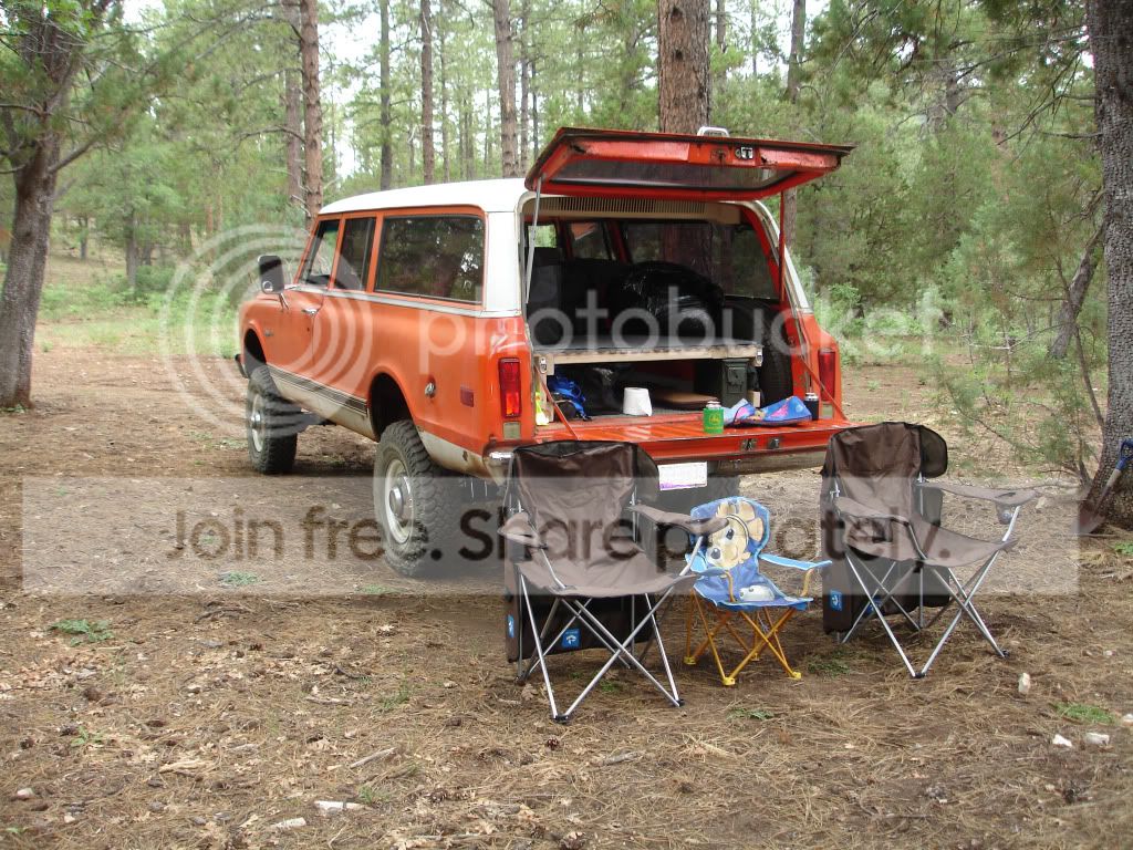

We turn off AZ89A about ten miles before Jerome and take FR104 over to FR413. Heading northeast on FR413 we start looking for a spot to camp. Not too far down the trail I saw a little two-track off the left side. We back up and head down the two-track. We get in a ways and find a tree fallen across the trail. It had been there awhile and a route around the tree was already present. I managed to get the Sub around it and we continued heading back into the sticks on this two-track. We got back in a ways and found a nice spot.
We started setting up our gear, but with burn restrictions there was no possibility of a campfire.
We stayed up for awhile then decided to retire to the truck. I put up the window coverings that I engineered and had my Mom manufacture. She used two layers of canvas (almost like denim in weight) and stitched magnets along the hems to make some really cool window coverings. This, and the fact we were in the middle of nowhere, made the inside of the truck very dark. We watched a John Deere show on the DVD player, then he laid down and I read him a couple stories. After those were done he got a little whiney when he realized the lights were going out. I told him a non-fiction story about an orange Suburban and how it came to be. He liked the story and was about out. When he woke up in the morning, I pointed out the fact that he slept with the light off and woke up alive!! (side note: he only uses a dim night light at home now--a positive effect of camping!!)

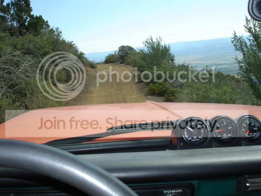

So I packed up the truck and we head out. We continue down FR413 in the same direction (toward Jerome) that we were headed when we found the two-track. Now I had run the road about ten years ago in another truck so I had an idea of what was coming, but I was in for a rude awakening once we got well into the switchbacks. It appears as though the road has not been maintained in many years. It was quite overgrown and very rough--mind you not too difficult, just rougher than hell, so no speed could be attained. We ran fourteen miles of this road in low range for speed control and several of those miles never saw the speedometer needle move off zero. It is a VERY NARROW shelf road. These pics do not do justice to the roughness or narrowness of the road.
In this one you can kind of see where the edge of the road is in relation to the center of the hood. (This is an extremely smooth part of the road, extremely smooth...)
The road just grates on and on and on and on. I have to put the left side of the truck into the bushes/trees/manzanita/genereal vegetation to keep the right side tires (the wife's side BTW) on the trail. There were points where I was scraping the left side, right side and top simultaneously. It got to a point where we were taking on so much vegetation through the open windows on the left side that we rolled up the windows and cruised in A/C comfort for the rest of the trail. This is a long, painful trail, but it has some spectacular scenery. There is a point where you can see sixty miles in a 180* radius from one point. My favorite view of Jerome is also had from this trail:

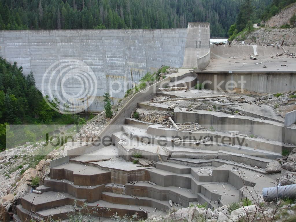

We head down by the dam and check out it and the spillway. We brought a fishing pole and tackle box for my boy, but the walls surrounding the lake are so steep that we couldn't find a trail down to the water.
