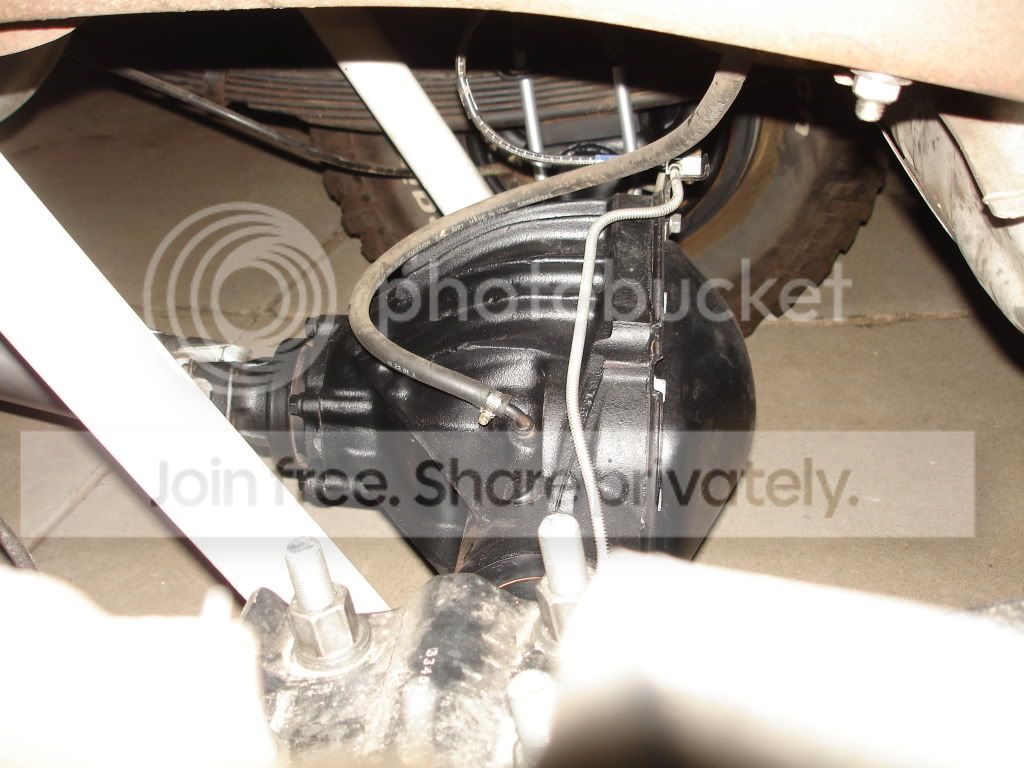

So, I wanted to put this diff in without touching anything. I only had one problem and that was the parking brake cables were the later design that I had initially wanted, but couldn't find. Now I had them, but I had already set the truck up to use the older bolt-in style. Now, I could redo the truck and use the newer cables, but I did not feel like doing all of that to swap out a diff. I happened to have a set of one ton (13x3.5") backing plates that use the bolt in parking brake cables. I swapped those on with all of the late model brake components that came on the axle. One super-bitchin' bonus of this swap is I get slide-off brake drums!!! Woo-hoo!! I did have to pull the hubs to swap the backing plates though, but when I did I checked out the bearings and they look great. The gear oil smelled good. I got a unit that is in great shape.
I cut the perches off and welded them in the correct place. Before I swapped the new axle in I took my 2.5 deg angle milled Zero Rates and turned them around thus raising the existing pinion five degrees. That made no change at all. I got home and pulled the diff and swapped in the new one. While I was taking it apart one nut on one of the new u-bolts galled. Nobody in town stocks them and spring shops are closed, but a couple phone calls later to some fellow gear heads had a replacement located and the project back in motion.
I got the new diff in and bled the brakes and went for a drive. The first thing I noticed is how nice the truck drives with the higher gears. I can drive around without having to use fifth gear. Prior to the swap, my maximum speed in fourth gear (1:1) was 55mph. I had to be in fifth to merge onto the freeway. Now, my top speed in fourth is about 65mph. It doesn't seem like much, but it make a huge difference in drivability. It spins slower on the freeway such that it quiets the motor down significantly. The motor lays down above 90mph now instead of 82mph. All in all it wa worth every bit of effort to install. I can not convey how much nicer this thing is to drive now that the motor spins slower. The fatigue factor of a roadtrip will be lessened significantly.
It has the cool, ribbed-for-her-pleasure housing:

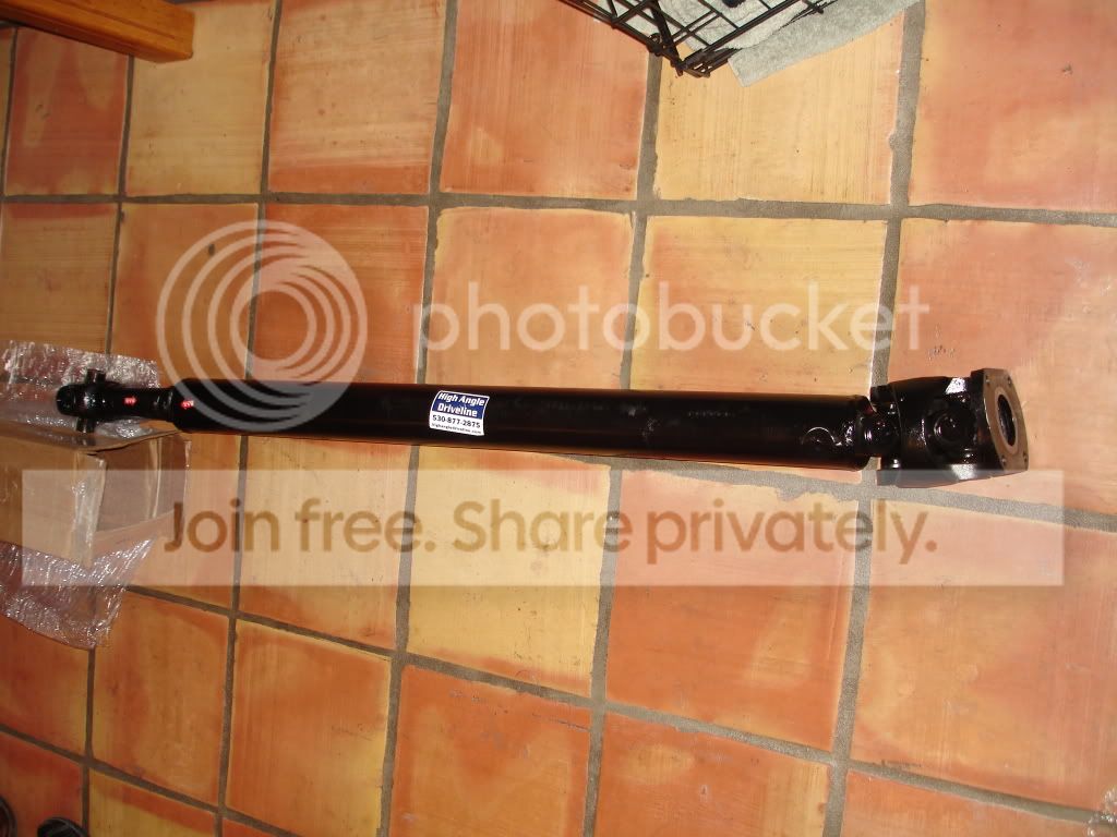

Jess' response was basically one sentance stating that he knew what my problem was and that I needed his patented drive flange and a double cardan shaft. He guaranteed that this would solve my problem and while I have no reason to doubt the master, I still wondered why. I gave him a call and he spent a fair bit of time on the phone with me explaining the situation. He said that the problem I am having is called gear rattle. It occurs when the joints operate over eight degress and they create a oscillation in the shaft and the shaft will push the oscillation out into the transfer case or into the ring and pinion. I had not told anybody that the vibration under decel sounded like the ring and pinion was coming apart, but he told me that it was--I was very impressed.
Anyways, I ordered up a 1350 series double cardan shaft assembly and a a week or so later a box showed up. Inside the box was one of these:

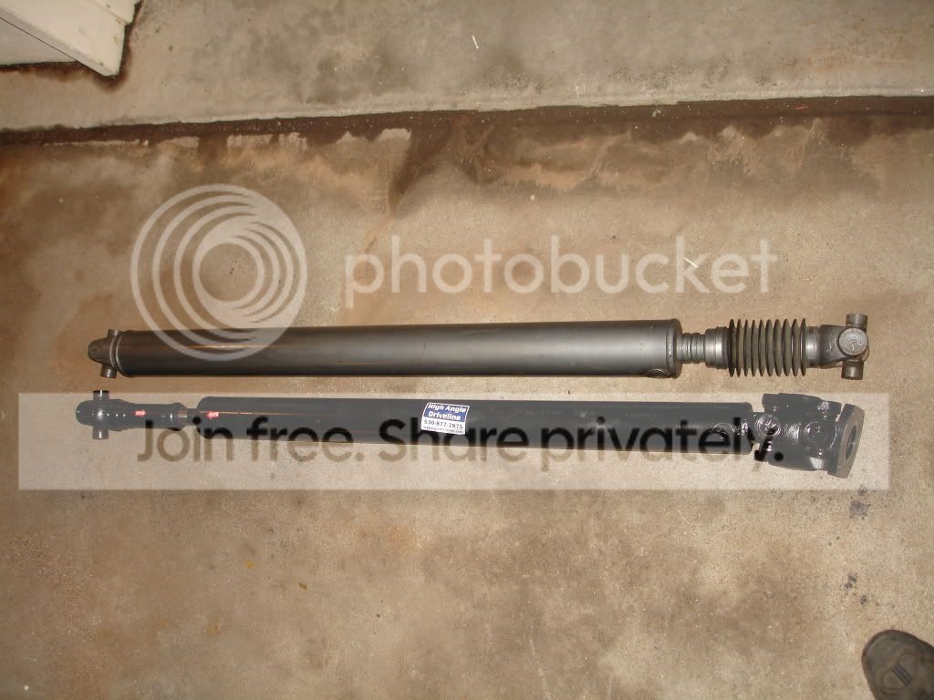

I had to change the pinion angle that I had just installed, so out came the new diff. I decided to get new perches so I wouldn't have to cut these off again and re-re-weld them on. I got the new perches tacked on and the axle temporarily re-installed. I installed the output flange on the transfer case and installed the driveshaft. I finalized the pinion angle two degrees down from the driveshaft and welded the perches on and installed new u-bolts. I got the shocks re-installed and hooked the brake lines back up. It was time to go to work and I knew there was no way I was going to be able to get work done efficiently thinking about this thing sitting at home in the driveway, so I decided to take it on a test drive to work--all or nothing.
So I did a quick transfer of all my rain gear from my S10 back into the Suburban (it wasn't needed, but if I didn't have it, it would have poured), grabbed my lunch and jumped in. Now, from the get-go, the biggest pain of the vibration has been that it occurs at 60mph and higher. That means that no matter what I try I have to drive it atleast 60mph. Now, the only place nearby to drive that fast is the freeway and there is no getting on slowly or taking your time getting up to speed. With that in mind, I get on the freeway as gingerly as possible. I get up to speed and merge on and all seems well. I play around in the range that I think it should be in (at this point I have not gotten my speedometer recalibrated for the 3.73's) and all seems well. I get to work and am fairly pleased and I believe the vibration is gone, but I want to be sure so I reserve judgement until the ride home.
I get out of work and and quite anxious to drive the truck for some reason. I get on the freeway and all seems well. I roll into and out of the throttle and it seems good. I run it way past where the vibration should have been and all is good. Then I run it way up and let off abruptly and it coasts down smoooothly and quietly--all is good--life is good!!
Yessir, all it took was a gold-plated driveshaft to fix the problem. Now, there is nothing wrong with my previous driveshaft--nothing at all. It just happens that he length, diameter, angle and any other variable added up against me to create an issue. I have seen drivelines with much more angle run smooth as can be--why did I have a problem?? Basically it came down to bad luck. An identical truck might not have ever had an issue while mine did. One Blazer with a driveline that practically hangs straight down has no isssues while the same setup in an identical Blazer vibrates like all get out--luck of the draw.
