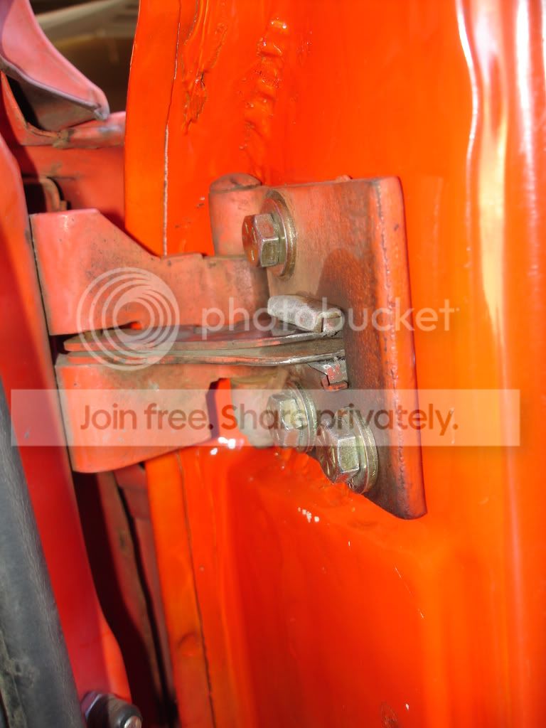

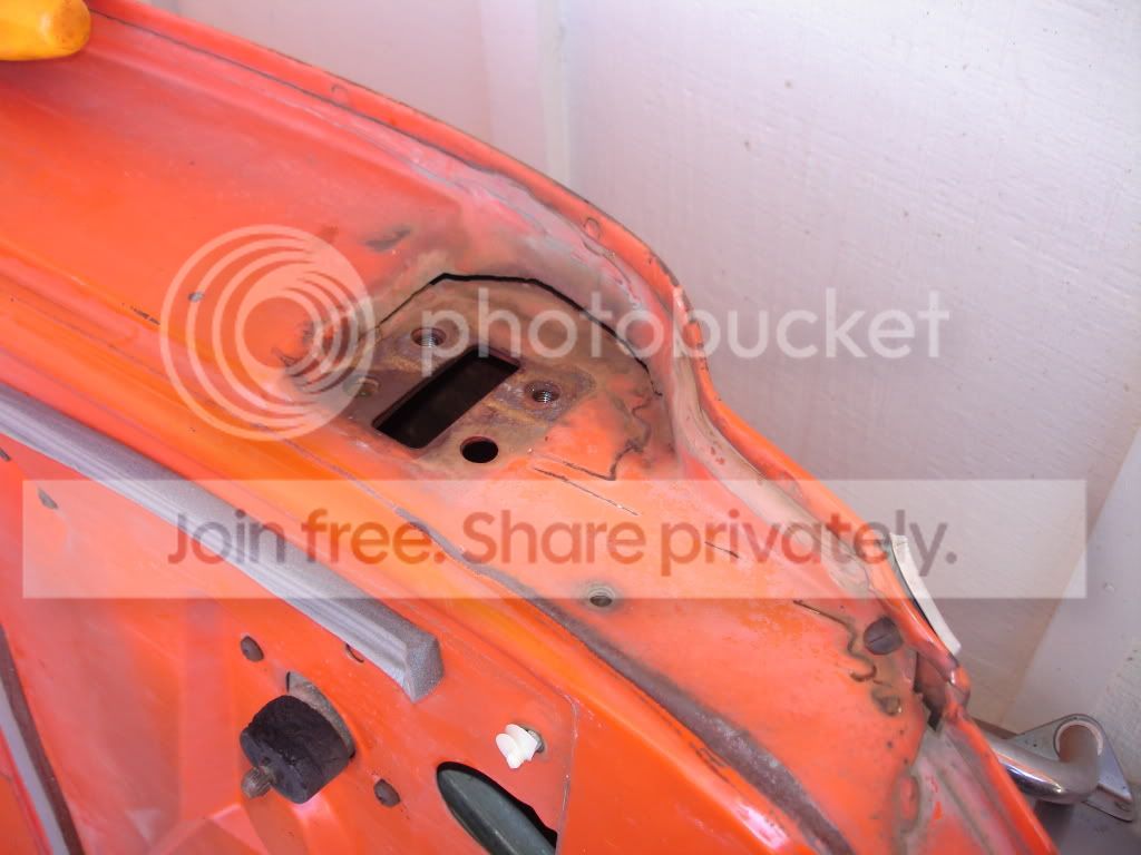

I had done the window/vent window weatherstripping on the drivers side awhile back and with this and that it took all day, so I had been successfully putting off doing the passenger side since. Well, I figured today is the day. The only problem is the passenger door has an issue that the driver door did not. It has some minor damage around the upper hinge area:
I figured, no problem half an hour to get the door off, an hour of welding, half an hour back on, boom, done. Simple. Right. As soon as I grabbed one of the upper hinge bolts and it turned but didn't loosen up, I knew I was in for a long day.
I finally got the upper hinge bolts out. One hole was completely galled out. Then the fun started. Unfortunately I did not photo-document my misery, so a quick blurb will have to suffice. The pic I really wish I would have taken was when I cleaned the area to start welding and found the whole are was spider-webbed with cracks--a few pretty good ones. Oof, the day just got a bit longer. Now, most of that big perimeter crak in the pic I did with the MIG, while most of the smaller spider-web cracks I did with TIG. I used over three feet of 1/16" TIG rod welding up all those little cracks. I probably would not have paid any attention to it other than I had to grab a fresh piece before I was done and thought holy cow, that seems like a lot of filler for some sheetmetal cracks. All of this welding ended up taking a few hours with all of the welding and cooling and welding and cooling and welding....
Anyways, I got it done and welded up the galled hole to drill a new hole and tap some fresh threads into it. That all went well until I couldn't fine my 3/8-24 tap. Tore the place up--couldn't find it. Called a neighbor, he couldn't remember who he lent his set to. Finally ended up putting everything away just so I could go to the store and buy another one to finish my day.
So I got the tap and cut the threads and blew some paint on it. It turned out pretty good. I did not get carried away grinding down the welds that were not under the hinge as I figured the less heat and thinning of the base metal the better.
This is what I ended up with:
It works very well now and only has one thud when it closes--not two.

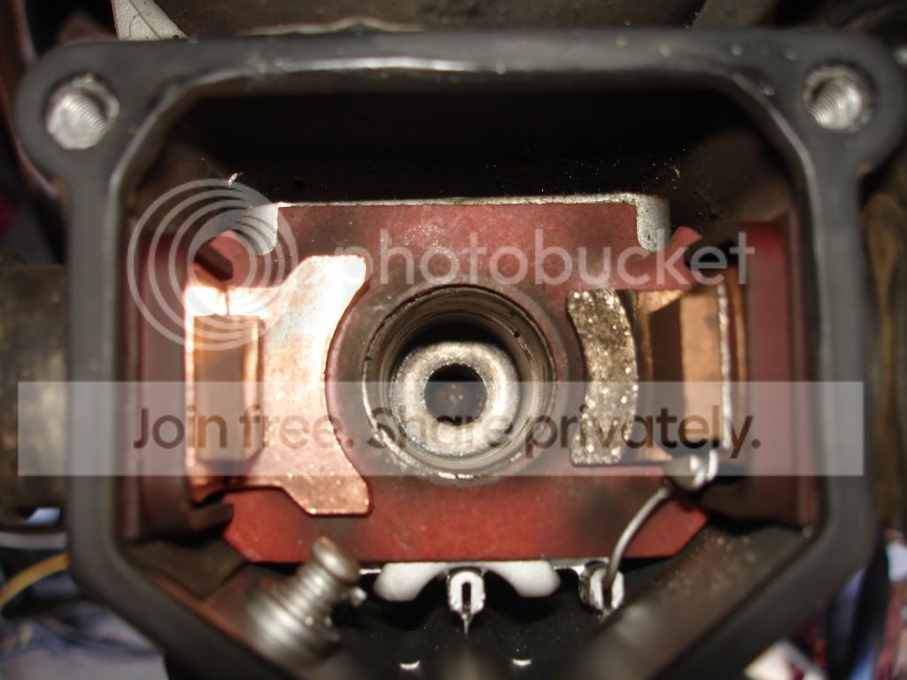

Yesterday, after I got the door hung and adjusted, I had something to repair in the kitchen and I needed some small sheetmetal screws for it. My boy and I jump in the truck and head over to the store to pick up an assortment pack of them. We get what we need and go back out to the truck and hit the key to have nothing happen. Nothing. No click, no rrrrr, nothing. Now, I know I was getting power down there because I could hear a relay that triggers bulb checks in the dash during cranking, cycling with the key. Well, WTF?? Just then a truckload (literally) of dudes pull up next to me and ask if it has a diesel motor in it. I said it did when I parked it, but it has nothing in it now. The driver offered a jump start, but I told him the batteries were fine. I said I was going to go in and buy a hammer. He said he had one and let me use it. I had my boy hit the key when I told him to and just barely touched the starter with the hammer and it cranked right up. We chatted for a few and I gave them the hammer back and we headed home. We went out to dinner after that and it worked fine--no problems at all.
Well, ironically, the last time I ordered from Geno's I ordered a heavy duty contact kit for the starter for no reason. I figured if I needed one I'd have one. Well how about that. Now all I have to do is find it. I actually walked right to it and after my easy day, I dropped the starter out and swapped the contacts. The replacements (left) are substantially larger than the originals (right):
The kit also comes with a replacement plunger that has a heavier contact ring and a stouter spring on it. I got it all put back together and reinstalled. It seems to work fine, but it was only that one time that it didn't so I hope that is what the problem was. We'll see. I did install a hammer under the seat, just in case.
Pretty common problem like that is a bad spot on the comm in the motor itself. By tapping with a hammer it will move past the bad spot and the brushes will get good contact and work great. I would check the winding and comm for safety sake, as this issue is usually not the solenoid.
I've seen this happen on some caterpillar engines that I've worked on.
Normally, I would completely agree with that, but there was no click to indicate that the solenoid was working. Normally I get the hammer out when I hear a click and nothing else, but this one had nothing happening at all. So I figured when I tapped it, it freed up the sticky solenoid as opposed to the typical bad spot on the motor as the solenoid was not functioning at that time. These starters have been known to have sticky solenoids, so I figured I would try the contacts first.
