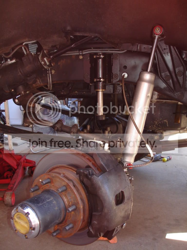

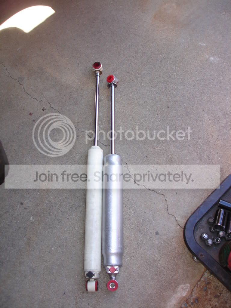

I didn't get much time to work on it this weekend, but I did manage to get out on Sunday and got a couple things done. The upper shock mounts I installed have created a couple head scratchers so far. The biggest being the shock length. The shocks I had on the front were too long with the stock mounting and too short with the new shock mounting. I swapped the rears to the front and they looked good at first, but it didn't take long to realize they were too long. Great, buy some new parts to replace new parts. I bought some shorter shocks for it, but the newer design of the RS9000s are larger in diameter than the ones that I bought way back when. This creates a problem with the lower shock mount on the driver side. With the older design RS9000 shocks and the relocated upper mount, the draglink would just miss the bottom of the shock in right turn conditions. WIth the thicker body of the new RS9000 shock it was no longer a miss, but a full-on hit. After some playing around with angles and dimensions, I ended up lengthening the lower mount about 1/2" for clearance. No big deal, but it turned a twenty minute shock change into a three hour ordeal once I got done with it.
This shows the difference in body girth:
This shows the final mounting, but I forgot to take a pic of the lower bracket: (the strange color is the bright sun bouncing off of the orange truck, reflecting off of a nearly white house into the wheel well area)

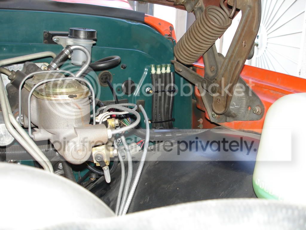

Once upon a time, when I first built this thing, I ran hoses off of each vent nipple up to the underhood area. (front diff, trans, t/case, rear diff, fuel tank)
While they were run up there, I had never finished the install. I had bought the vent caps back then but never installed them. I had some grandiose plans of how I was going to mount them, but I figured if I kept waiting to do that, I would never get them done. That being the case, I used a few zip-ties and got the job done in a lees-than-grandiose style:
Somewhere in the passing years, one of the caps got pilfered for another project, so I still need one to finish it--but hey, it's much closer.

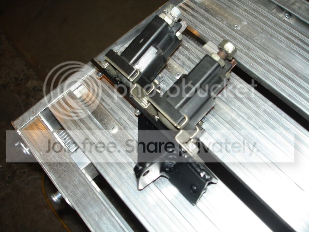

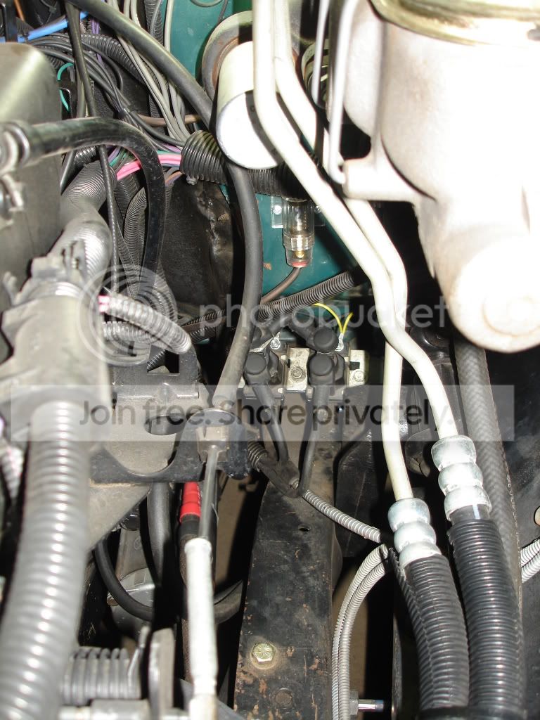

Yet another problem that the upper shock mounts created was I had to remove the grid heater solenoids for cold starting. Not really a problem at all when the thermometer doesn't see the south side of 95, but there is a possible adventure in the near future that just might require the use of them. That being the case, they need to go back in. I really like the original mounting location and bracket, but the bracket was not going to work. I figured out that I could put them back in the same vicinity, but a new bracket is in order. So after dinner I got back out there and whipped up this little gem:
The pic isn't so good, but I was in a rush to get it done before my family duties came to call. I mounted it up and was able to reuse the wiring and cables from the original mounting configuration.
It fits good, is very stout and doesn't grab your eye where it is at.

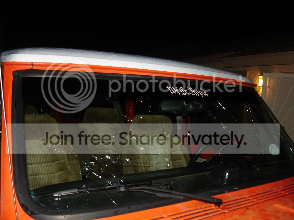

Sometime this afternoon a huge storm blew through the valley and hit where I work really hard. It brought torrential rain and golf ball sized hail. I got back about an hour and a half after it finished and there was still four inches of it in shady spots in the parking lot.
Needless to say, vehicles got pretty destroyed--panels destroyed, mirrors busted off, headlights busted. There are two brand new Ford trucks in the lot that got banged up pretty bad. I thought mine might fare well because of it being made of old, thick metal, but no such luck. The hood looks like a golf ball, the windshield is destroyed, and it is kind of hard to tell, but it looks like the roof got it pretty good too.
The busted up windshield scattered little shards of glass all over the interior of the truck. The wind blew so hard and the rain was so torrential that it blew right past the door seals on all three doors and soaked the seats. So, not only did I get to drive home looking through a busted up windshield at a dented hood, I got to do it sitting on a wet seat that was covered in glass.
