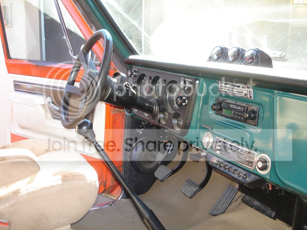

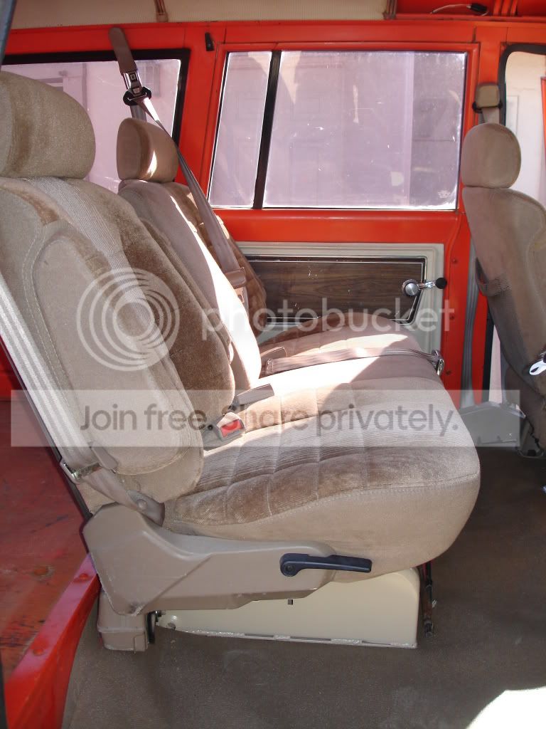

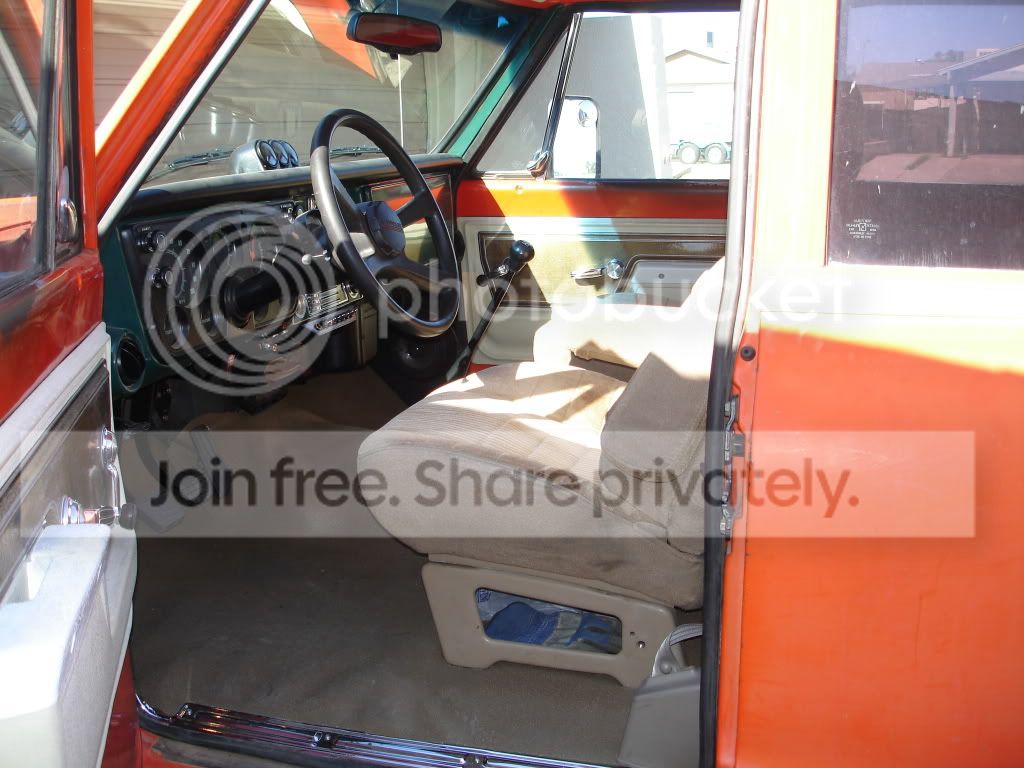

Well, I finally got around to loading my interior pics. I had to convert my truck to bucket seats because where my motor got placed put the transmission shifter so far back that I had to widen the hole for the transfer case shifter for the transmission shifter to come through. That still would have worked with a bench seat, but the transfer case shifter was going to end up even farther back than that thus preventing the use of a bench seat.
So I started searching around and I found a full-factory-pimped '94 GMC Safari SLE van in a U-Steal-It yard down by work. This is no small task as I am guessing the price of the full-pimp factory unit was probably fairly close to the conversion van price because this was the only loaded factory-stock one that I found in a sea of conversion vans. This particular van had a power driver's bucket seat, manual passenger bucket, manual bucket seats for the second row (both have adjustment levers for fore/aft seat position, recline, and integral armrests), and a bench seat for the thrid row (this also has an adjustment lever for fore/aft seat position, the left and right side of the seat have integral armrests and recline with the center of the seat folding down to become a cup holder/armrest type apparatus).
Now, I did not want power seats. I do not move the seat around enough to ever want to deal with a non-functioning power seat ever again, and the front seats were pretty worn/sun faded. I got to looking at the second row seats (buckets) and really liked what I saw. They were very dirty and had typical kid type bio-hazards going on, but I thought they would clean up enough to use. I grabbed the two second row seats to use as my front seats. I got them home and started checking them out and started liking them even more. Did I mention it was half off day and I got them for less than $35.00 for the pair?? Yeah it was a sweet deal that day. Anyways I got to thinking that my second row seat was just as bad as my front seat and I should have grabbed the third row seat out of the Safari van to use as my second row seat. I waited a week and went back and it was still there and nobody had used it as a rag to clean their hands on. I got it and the integral seatbelts for under forty bones. I wanted to use the quick release mechanism for my second row seat, but it was not going to work with the frame rail spacing of the Sub. Oh well, I sawed the "hooks" off of the bottom and welded some flat plate to the brackets and converted it to a bolt-in seat.
Here are some pics:

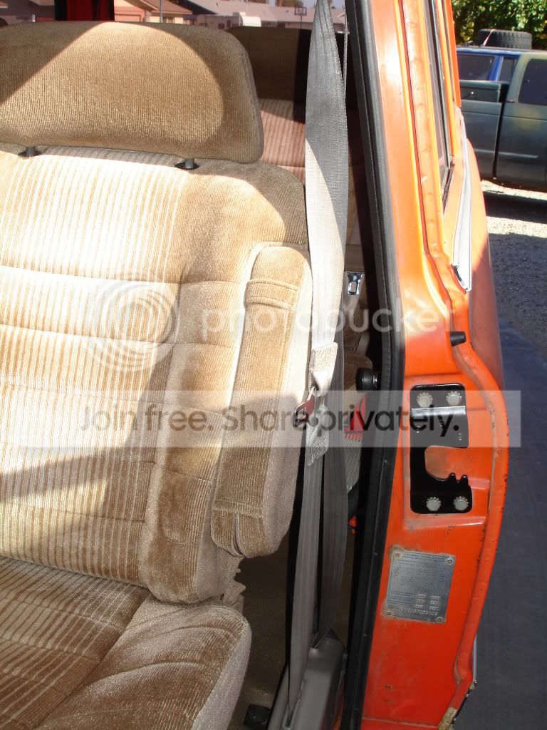

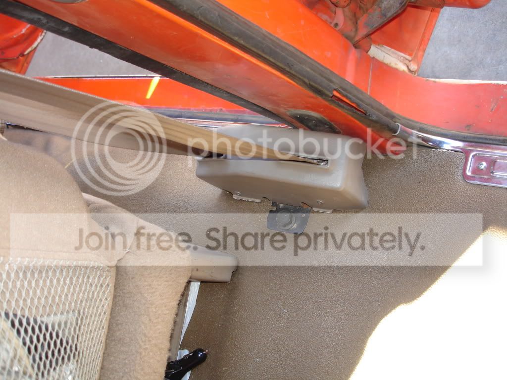

For the front seat belts I used assemblies out of a '97 Chevy regular cab truck. I wanted to use assembliles out of a Tahoe or Suburban, but all of the ones I found were crap.
Now, the only difference between regular cab and Tahoe/Suburban seatbelt assemblies is the black tab has a plastic covering with the Tahoe/Suburban units. These belts I got were like brand new. They were in pristine condition and definitely were not being worn when the truck they came from got crashed.

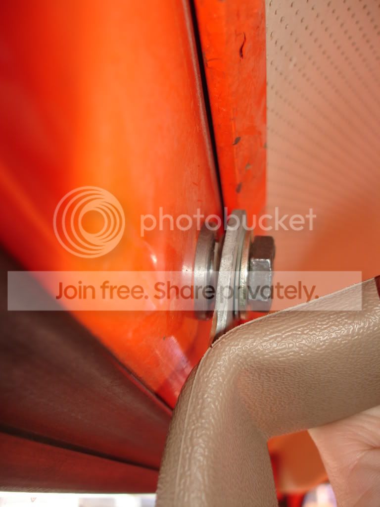

Now, I have seatbelts with shoulder harnesses for every position in the truck and Generous Motors was kind enough to give provisions to bolt up the shoulder straps, but the hole they gave was not typical compared to late-model vehicles. Instead of being 1/2-13(ish) or metric, they are 7/16-20. Swell. The shoulder belts all attached with a shouldered bolt in their original application, but they are all larger than 7/16". Hmm, what to do. I measured the hole in the rear shoulder belt mountings and found it to be about .625". Ok, for a mock-up I need a bushing with a 7/16" bore and a 5/8" od. I must have something that will work around here...I did. The caliper mounting bolt sleeve from 1/2-3/4T trucks (and a bazillion GM passenger cars also) just happens to have the needed specs. Sweet, I get them mocked up and decide I want something a bit stouter than the caliper guide pin sleeve. I call Russ's 24hr Machine Svc and describe this "top-hat" looking thing with x diameter for the brim and y diameter for the cylinder above the brim and a 7/16 hole through it (I love it when something can be accurately described over the phone). He whips up several of them and they work out perfectly. My theory was the sleeve could use some stability by adding a shoulder to it:
Ok, so I have some stout bushings to mount the shoulder harnesses to the body, now I just need some bolts. Hmm, 7/16-20 about an inch long with as thin of a head as possible.....exactly my thought as well--flywheel bolts for a Mark IV big block/first gen SBC!! They worked out perfect!! Thin head that the covers fit nicely over and long enough to engage all of the provided threads in the body.
The flooring I used was the Auto Custom Carpet heavy duty molded vinyl kit. I followed their instructions about laying it out before working with it. I put it in the truck and it looked good until I started trying to fit it to the truck. It went to hell in a handbasket real quick. What looked good to start with ended up looking horrid once I got it "fitted" if it can be described like that. Now, I have installed several factory GM rubber floor coverings and I thought those fit bad---nooo, those fit like gloves compared to this clump of crap. I was thouroughly dissappointed. I was working with this stuff in summer when the ambient temp is just a fuzz under the surface temp of the sun and I still couldn't get this thing to lay out right. I ended up trying to fit it with a heat gun and glue, but it undid everything I did in a matter of 24hrs. I finally said screw it (literally) and made a couple strategic relief cuts, then glued and screwed the pieces together. It looks sorta ok at best, but I would not use one again, that is for sure.
Anyways, this is just my opinion and I am sure someone somewhere had good luck with their product, just not me.

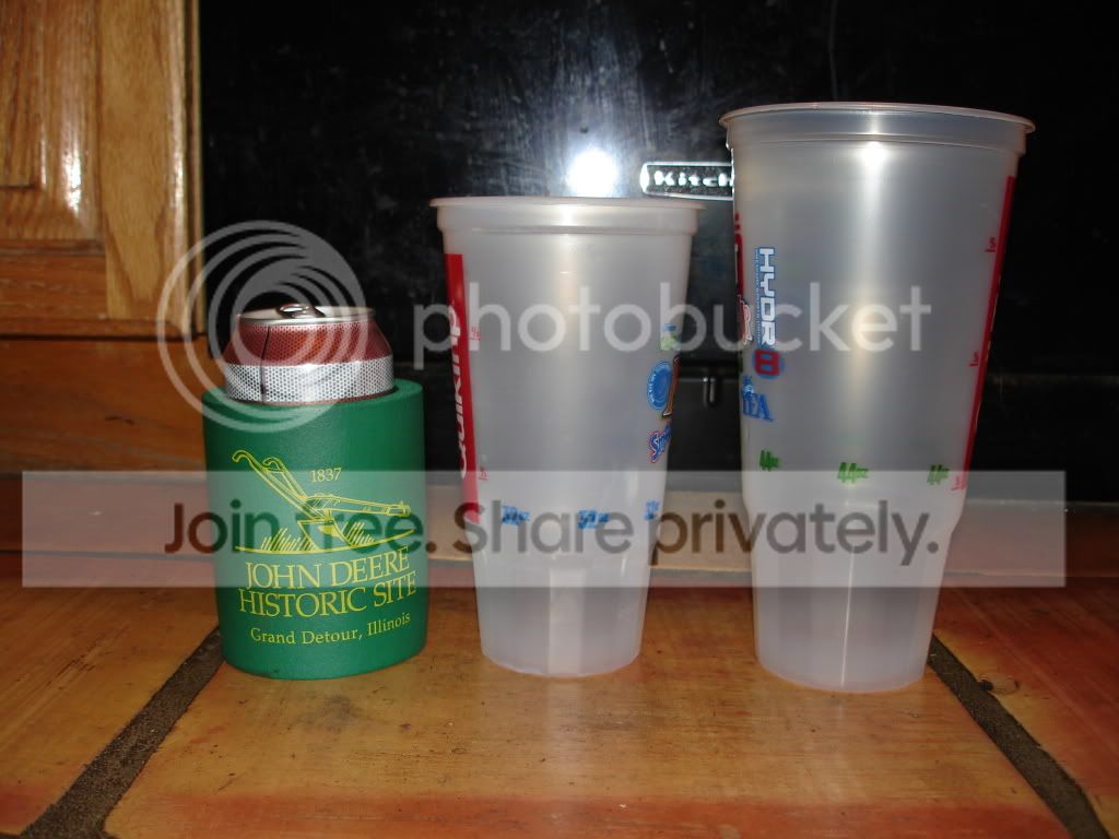

Ok, so where to start. I guess I should figure out what size vessels and what configurations to start with. I decided it must me able to hold a can with the foam sleeve around it. I also figured it needed to be able to hold the two most common size cups from the local Kwik-E-Mart as I have a bunch of these cups in inventory and I do stop and buy a soda once in a while.
So here they are:
You can see that the difference in diameter is fairly substantial. I started with the can/foam sleeve. The foam sleeve measures 3.25" o.d.. The cups are obviously smaller diameter at the base but taper to a larger diameter as you go up toward the top. Ok, 3.25, 3.25, 3.25. Ah, I got it!! 3.5" o.d. exhaust pipe. Perfect fit on the can!! Ok, now to figure out how to make the cups that are going to be VERY top heavy remain seated in the pipe without assistance from the driver. With some water in the cups and some EXTREMELY scientific shaking and leaning of the pipe, I found the perfect depth that will keep both upright.

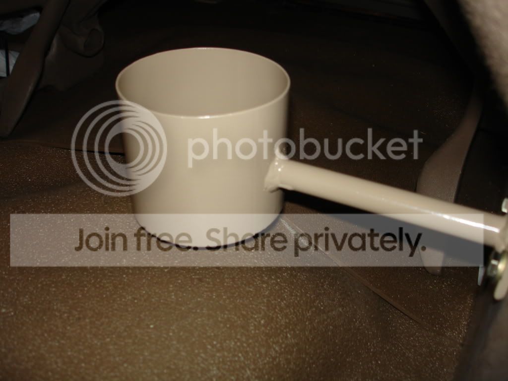

I welded a piece of 1 x .187 flat stock to the inside of the pipe at the bottom to make a place for the cup/can to sit on while also providing drainage for the inevitable drip/leak etc. Now what to do with this piece of pipe. Ah, I can mount it to the side of the seat frame. Ok, it must be spaced out so much to clear the side of the seat bottom. Ok, what to use. Well, heavy wall exhaust pipe seems a bit excessive, so I should probably go with something more reasonable. 5/8" grade 8 round bar--perfect!! Nice and light, not overkill, excellent. Now to mount it. Another chunk of the .187, 1" flat stock welded to the end of the round stock, drill two holes, add a couple grade 8 bolts to the seat framemount it about an inch above the floor and BOOM!! There it is, one perfect, lightweight, cupholder.
Nice...is it in between the seats?
Yes. It mounts to the right side of the seat bracket, about one inch above the floor. It puts the lid of the 44oz cup about 3/4" away from the seat and a fuzz below the level of the seat cushion. It is in the exact place it needs to be--no stretching or fumbling around to grab the cup or re-holster it.

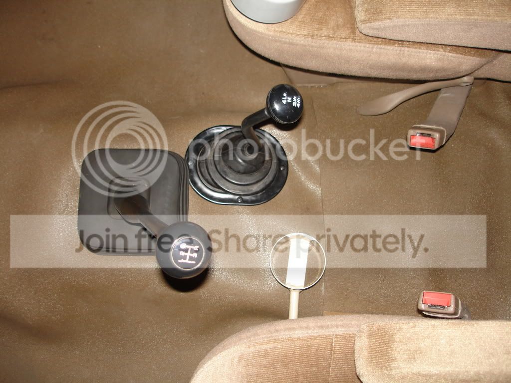

This pic shows it a bit better:
It also shows the crappy floor covering a bit better. It also shows my transfer case shifter. I am getting closer to having a four wheel drive Suburban.

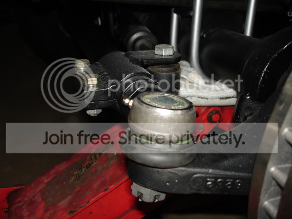

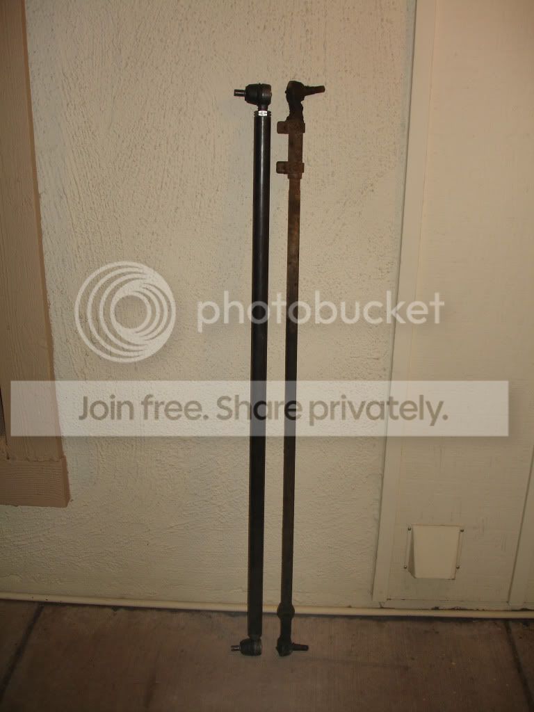

The cool feature of this 60 is the tie rod assembly that was created for it. I am not a fan of the four foot long tie rod end that the 60's come with from GM. I like shorter ends with a long connecting tie "tube". GM never had this setup on a 60. They did it on a 10B in a 3/4T application, but never on a 1T. Well, I guess I am on my own again. I started checking diameters and found that the Dodge 1T 60's use a very short end that should be adaptable to my setup. They use a goofy 7/8-18 RH or LH thread. That left me a few options for a connecting tube. The lightest I wanted to go was 1.250" .250 wall, but then I called my steel supplier and they had 1.50" .375 wall 1026 DOM in stock. Well that made the decision real easy. I bought a chunk of it and a couple tie rod ends and headed over to Russ's 24hr Machine Shop. I brought the old tie rod as a guide for length and left the tube and ends for machining. It turned out great. The ends do not have a whole bunch of length to them, especially when you add a jam nut, but going off of the original tie rod spec, he faced the tube to a length that has only one thread showing on each side. Not so good if you have to toe it in a bunch, but I have it set a bit farther in than it was and still have the one thread. This keeps most of the threads on the tie rod end in the tube where they will do the most good. There are way more threads engaged than are required for maximum strength which is just the way I like it.
New tie rod on left, original on right. New one weighs 6.3lbs more than the original:

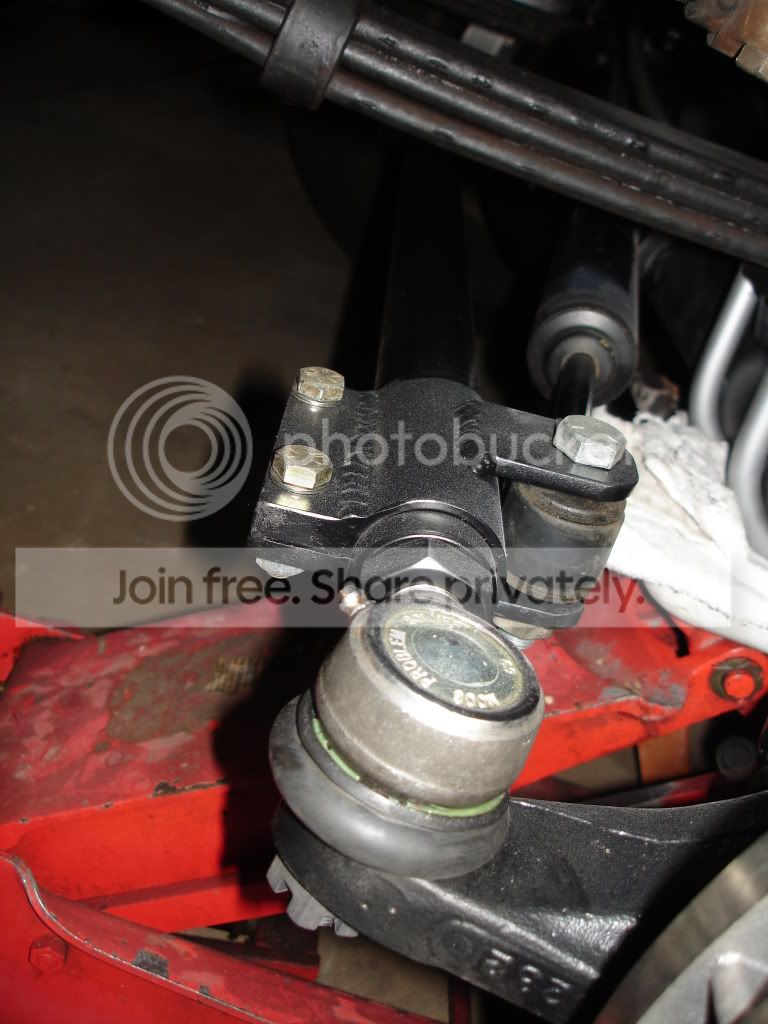

So, now that this big bitchin' tie rod is made, there needs to be a way to attach a steering damper to it. I am not a fan of the u-bolt type mounting of the aftermarket stabillizer units, so Russ came up with a great idea to make a fully functional (and fully cool looking) mount. It started as a piece of 1.75" 1.20 wall tubing that I cut lengthwise with a cutoff wheel. Then I took the piece of .375 x 1 flat stock that Russ had machined a notch into and welded it above the cut. I took a piece of .250 x 1 flat stock and welded that below the cut making a big pinch clamp out of it. On the back side I used .250 x 1.250 flat stock to make two tabs to mount the steering stabilizer end in a double shear configuration. It worked out great. Minimal torque is required to keep the clamp from rotating/moving.
This pic shows how the two pieces of flat stock fit together. The upper one has the milled slot in it. It is kind of hard to see, but the front of the piece has about a 1/8" lip on it that contacts the lower plate first then will pull the backside of the joint together if more torque is applied to the bolts:
This pic shows the double shear mounting on the stabilizer end: (and the ever-present AZ dust)

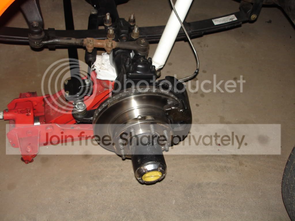

This pic shows the new hubs, rotors, calipers, and brake hoses:

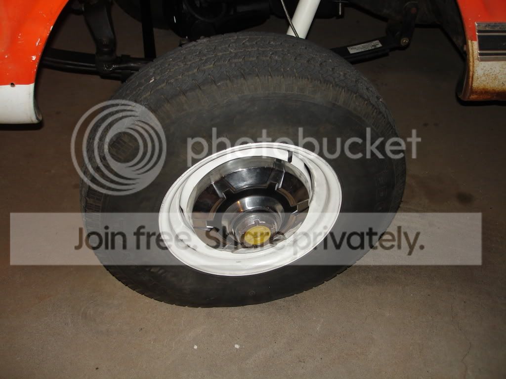

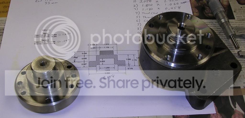

I finally have a set of Spicer hubs hanging out of my hub caps:

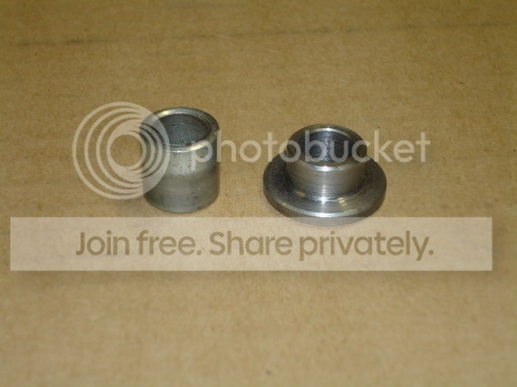

Seat belt shoulder harness bushings:

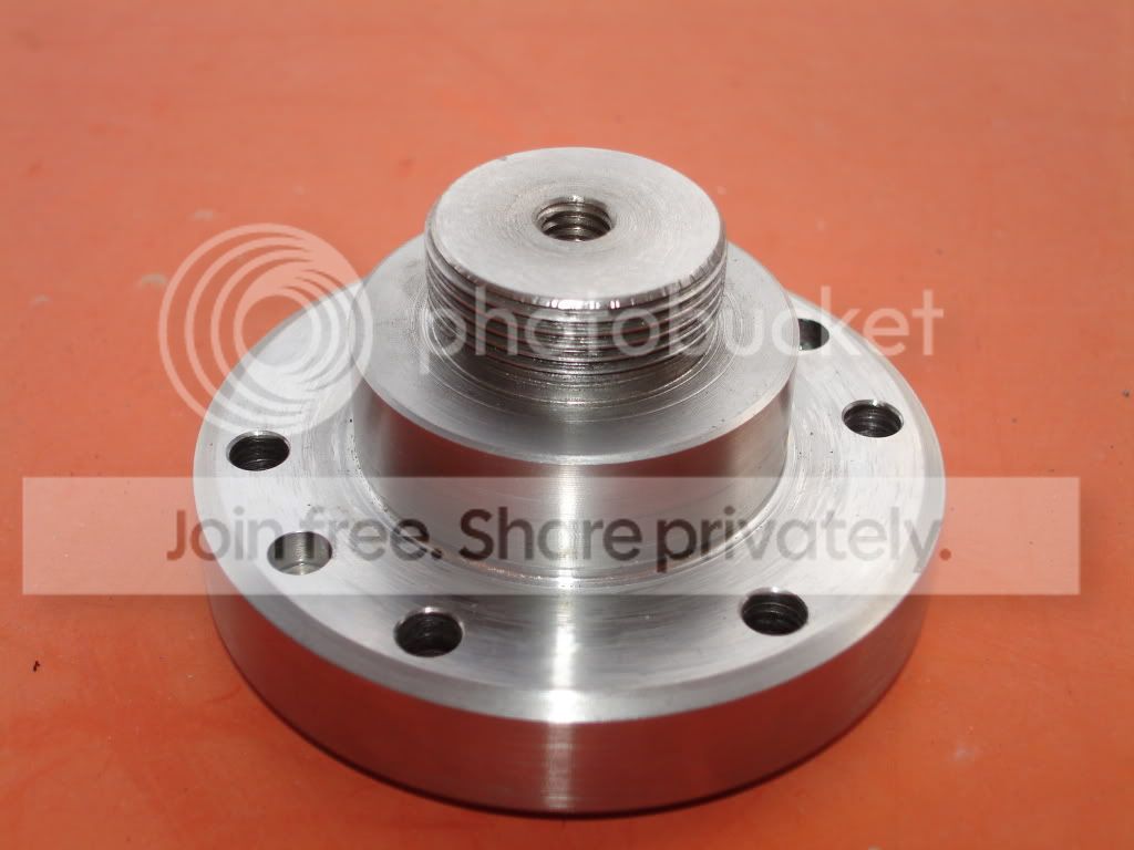

Super bitchin' fan hub spacer:
