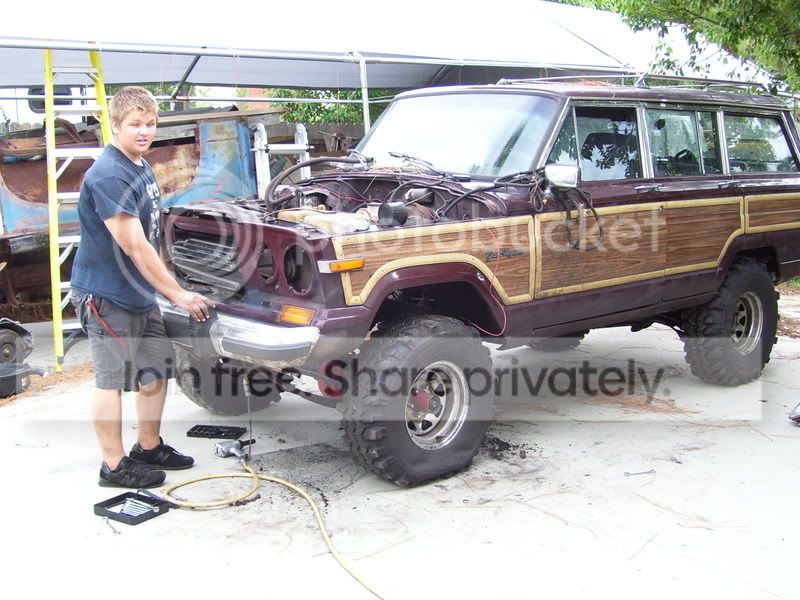

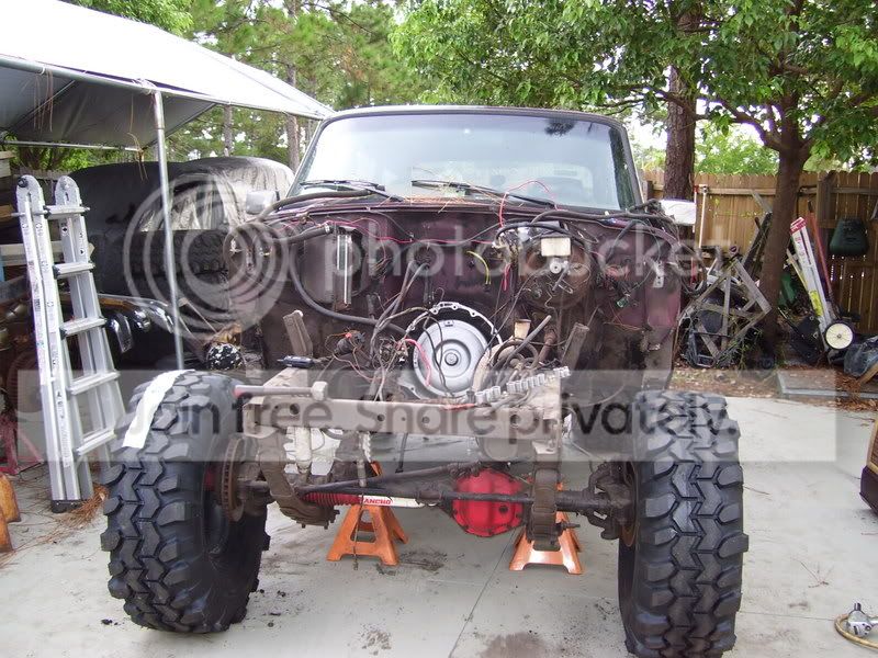

Yes its not a chevy:p: This is my buddies senior project were doing at my house...
its an 87 wagonneer...were rebuilding the 360, its got a new 727 in it....were doing a spring over in the front, and a shackle flip in the rear. Its going to have 5.13gears front and rear, full spool front:doah:, and a for 9 in the rear.

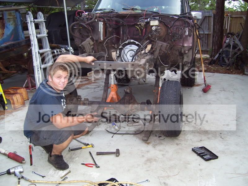

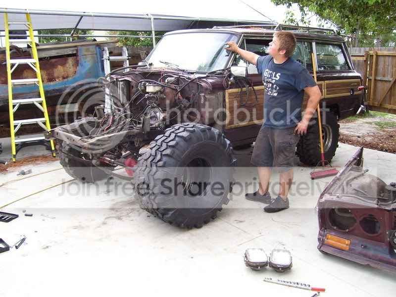

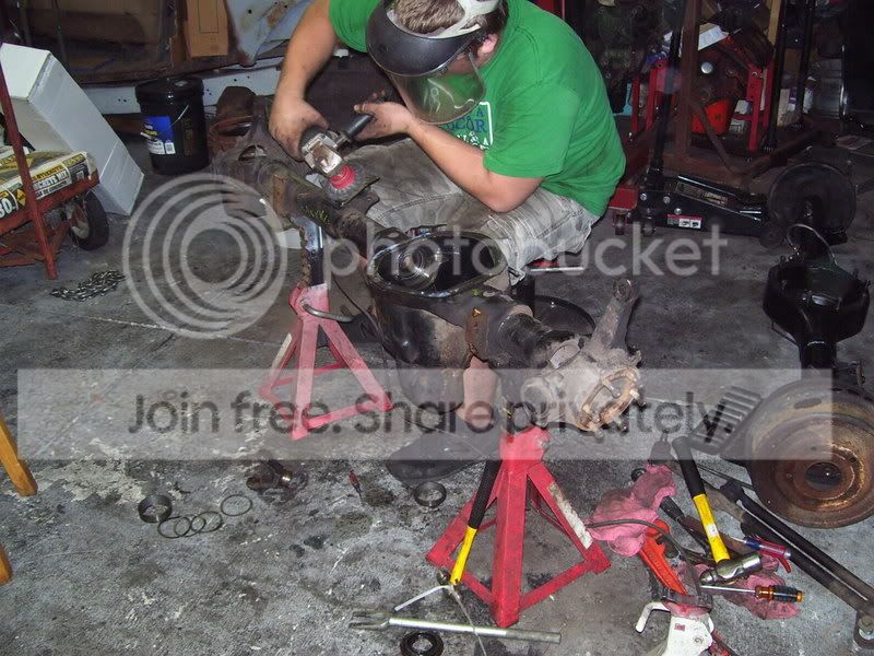

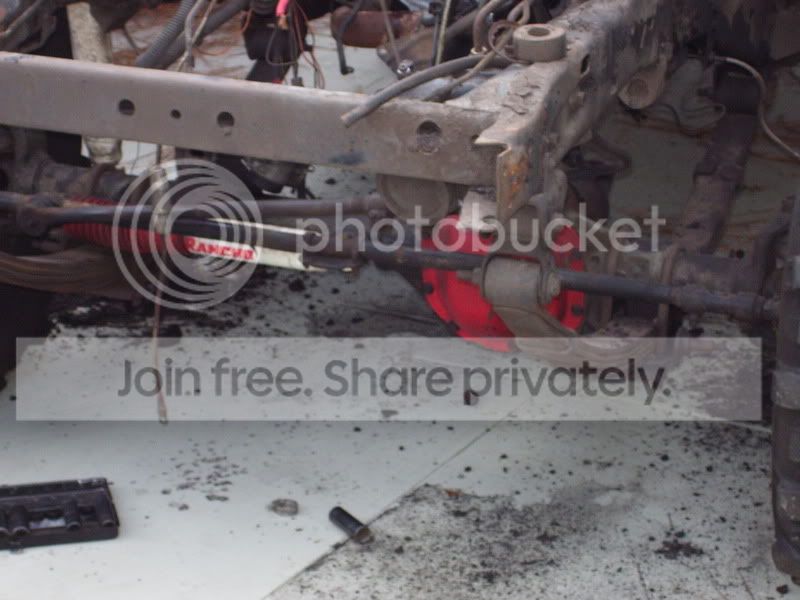

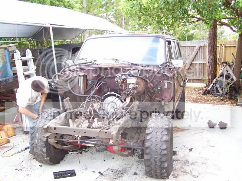

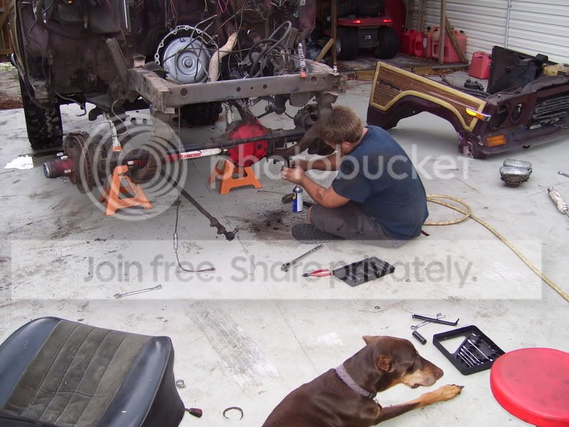

Anyways onto the pics...Today, we pulled the clip and the front axle.
As it sits not it has a 6" lift kit on it. the front springs are basically 8inch chevys...this sumbitch it going to be big...:eek1: as it sits on the jackstands the truck would be sittin on an axle and 30" tall tires in the pics...

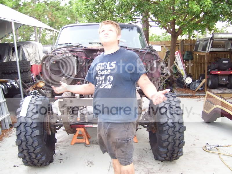

THERES ME! :haha:

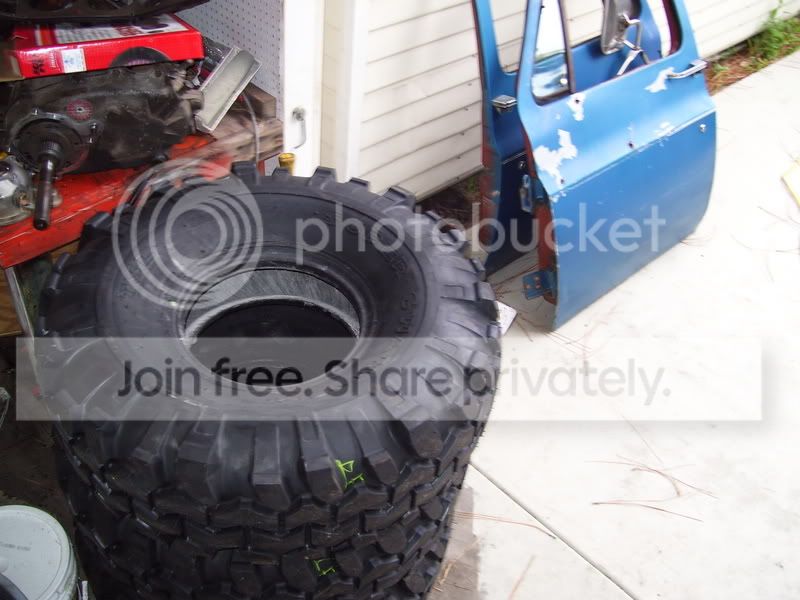

Tires (39.5x15x15 tsl)

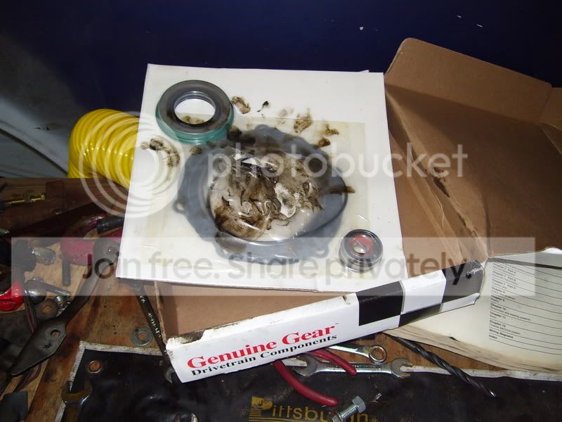

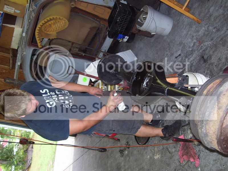

9 inch stuff...not done yet. waiting on bearings.

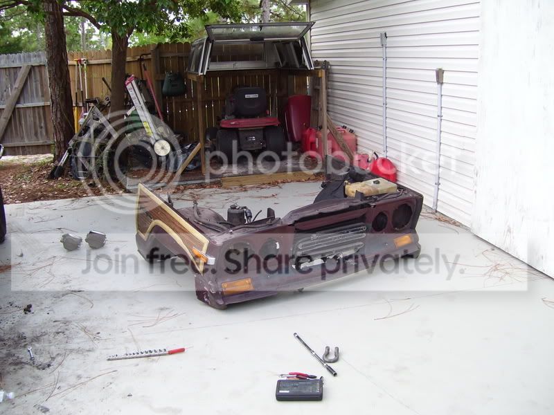

oh...and hes goign to do the gladiator grille swap...its a reman grille off ebay, but its looks ok. GOnna do a set of circle head lights like in your pic, and i think a small set of offroad lights in the sockets next the the headlights.

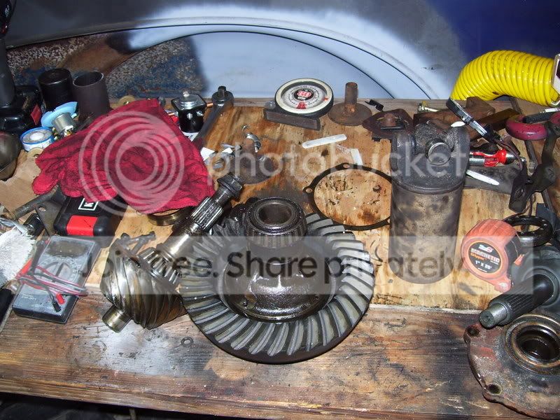

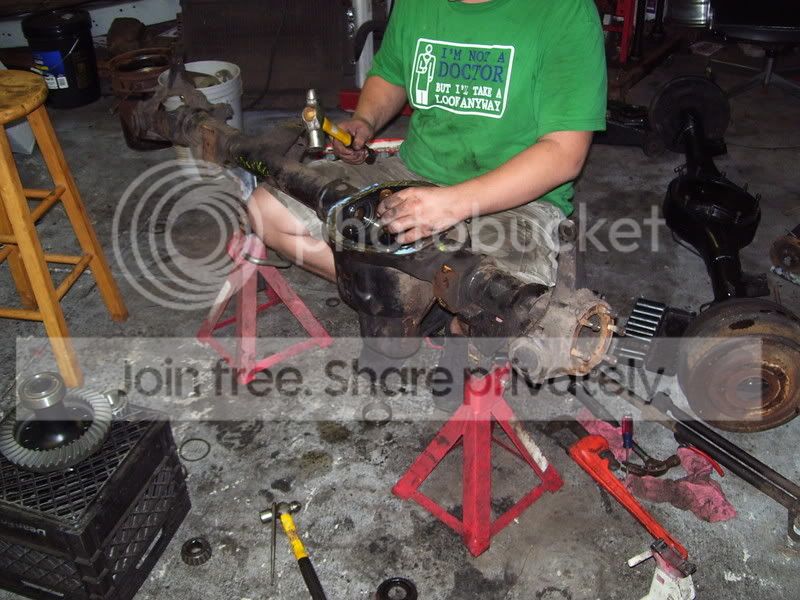

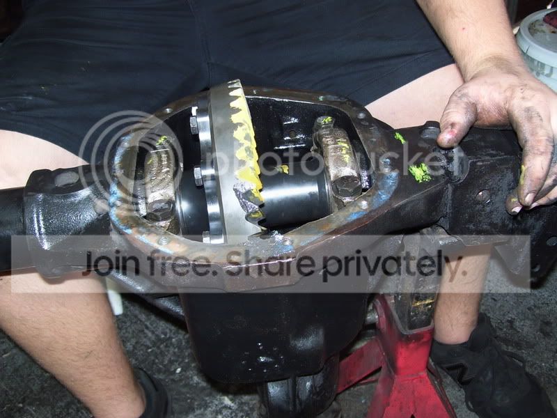

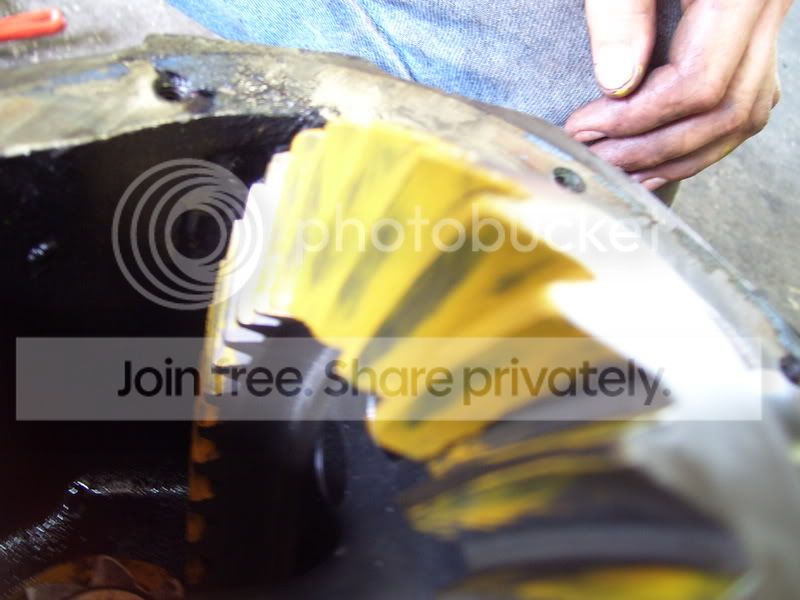

Did more work, tore down the d44. and put in the 5.13s and full spool.
Gear pattern look good?
How the hell do you do a spring over on the housing part? Were confused. The drivers side perch is integrated into the housing, do i weld a plate on top and gusset it? or what?
