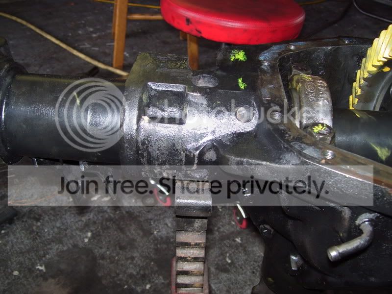

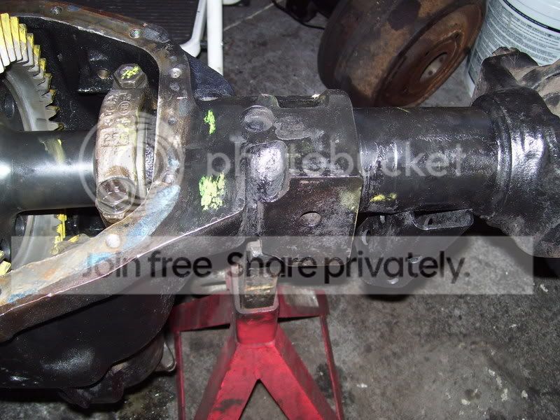

How the hell do you do a spring over on the housing part? Were confused. The drivers side perch is integrated into the housing, do i weld a plate on top and gusset it? or what?
IIRC, you have to grind a spot on the top. Then theres a purpose built spring perch that welds to the bottom spring perch and outside the cast housing to the tube (on one side) rather than welding to the cast housing. The other perch is raised to match and welds on to the stock perch and the axle tube.
Balzer
EDIT: Thinking again I belive the drivers side does not weld on. Just grind a place and it wraps around and uses a bottom plate on the stock perch.
Sorry...but thats not making sense to me...:confused:

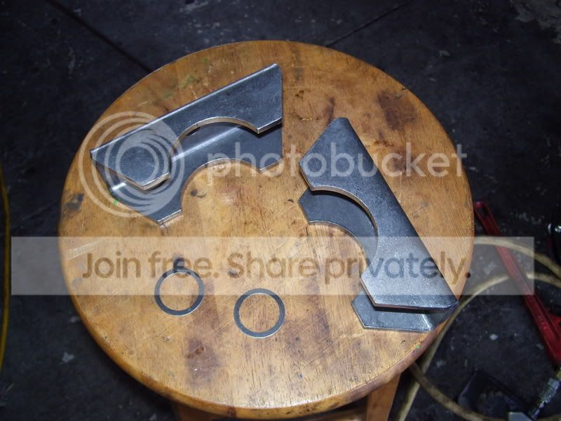

We went to the local 4x4shop and got a set of D44 perches. I wasnt paying attention...(drooling over swampers haha) But i believe she told my buddy they were for a spring over conversion.
As seen...both are the exact same.
These are of the drivers side mount...i guess i *could* grind the housing down to accept the perches that we bought...except then i couldn't be 100% sure they would be the same height.

Heres a very crude drawing of what I mean. The blue is the spring over perch that is not welded on. the red would be your u-bolts of corse. Im pretty sure you have to grind the housing to make it fit. Welding to the cast housing is best left to profesional welders as I think it needs pre-heated special rod ect. And like I said b4 im pretty sure they come in a set and the other perch for the pass side is taller that the ones you showed ,and welds directly to the tube.
Balzer
ah...im following you now. but if it isn't welded to the axle, wouldnt that create a problem with axle wrap?

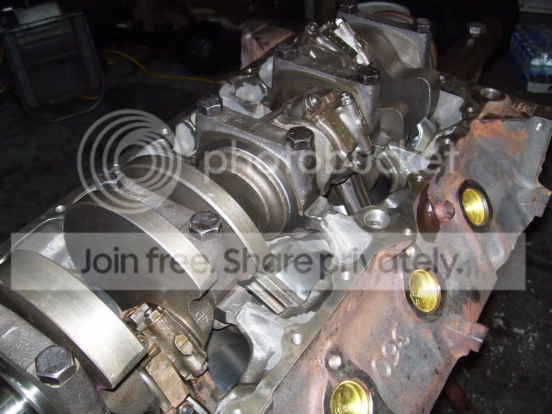

i think you contact pattern on your gears looks to be a little off, from what ive been taught its suposed to be a little closer toward the center of the teeth not so close to the edge.
seems to me that it would not be a problem because, assuming a nice snug fit, the flat piece on the bottom would prevent rotation. this rotation prevention would be even more increased by the ubolts pulling the bottom plate up against that flat part.
Thats a good point.:doah: i missunderstood. AGAIN, and didnt read the part about a plate below going across the "old" perch.
This actually makes perfect sense.
From what I can tell from your gear pattern, it looks like it isn't set deep enough. Lik one earlier post said, the gear needs to mesh in the center.

he would need a 60 from a ford, his jeep is driver's drop.
actually a ford 44 would solve his perch problems also.

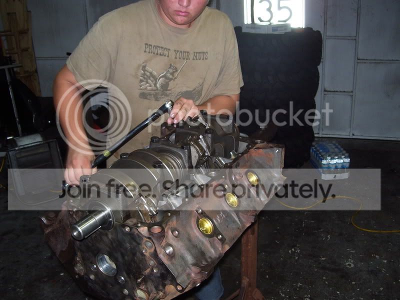

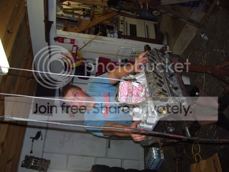

Motor: Got it back from the machine shop.
The bottom end is assembled and the heads are on and torque, waiting on the cam which should be here tomorrow.

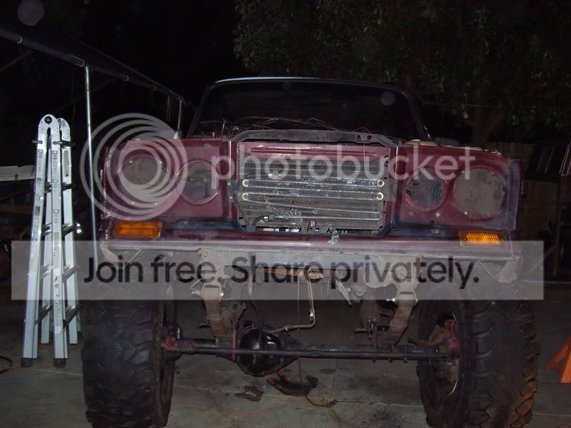

We were bored and decided to put one of my 44s under it...son of a bitch is bigger than my project truck ::(:
Ill let the pics talk.
