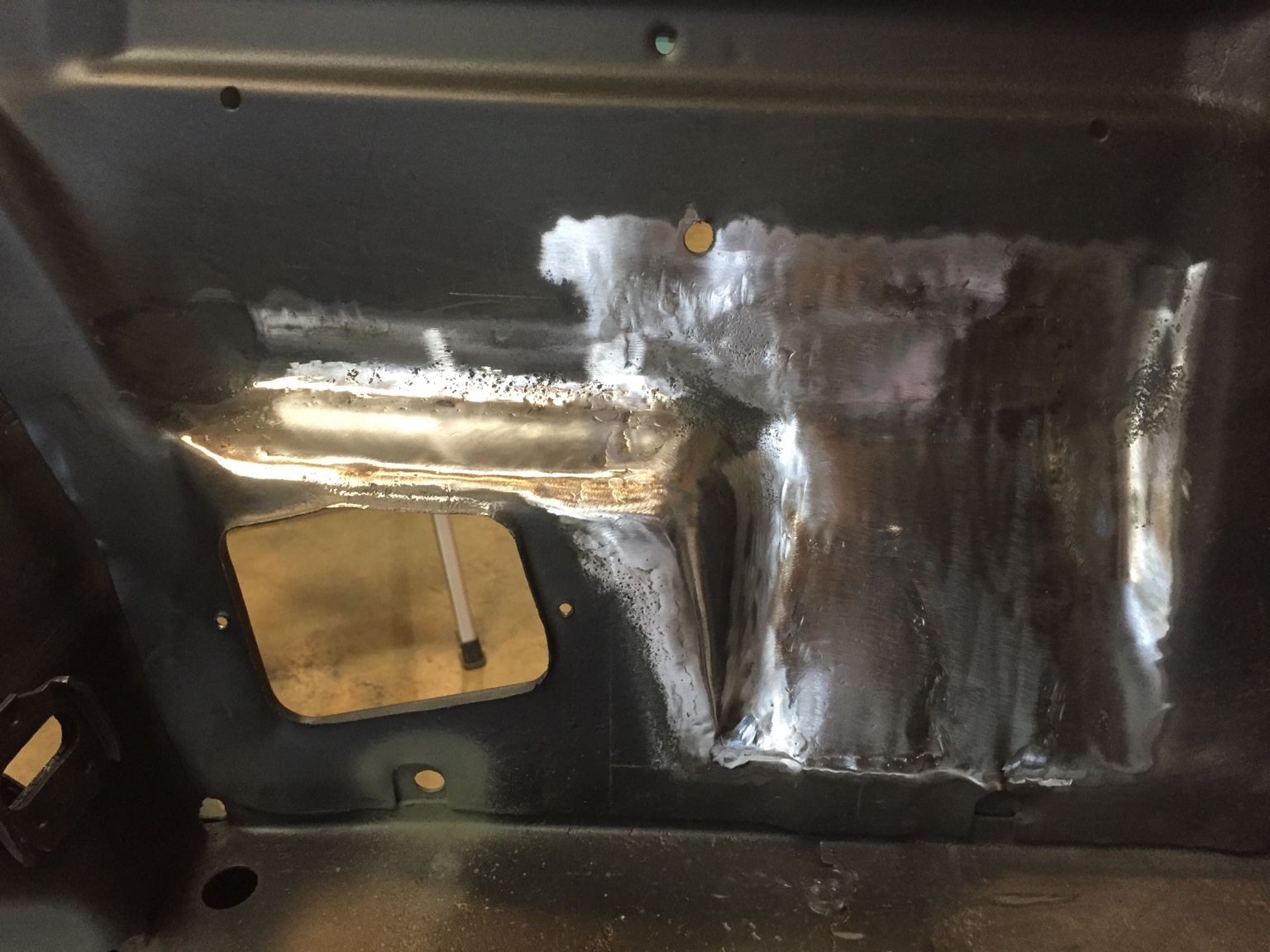

The battery tray is burned in, and mostly smoothed.
After this photo, there was a good bit of hammer and dolley to align the curves and creases and smooth the welds. There's more metal bumping to go before it's ready for primer. I also have started the 36 grit DA before primer, and I like how it gently smooths welds.

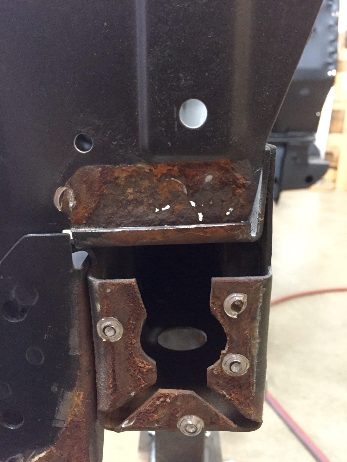

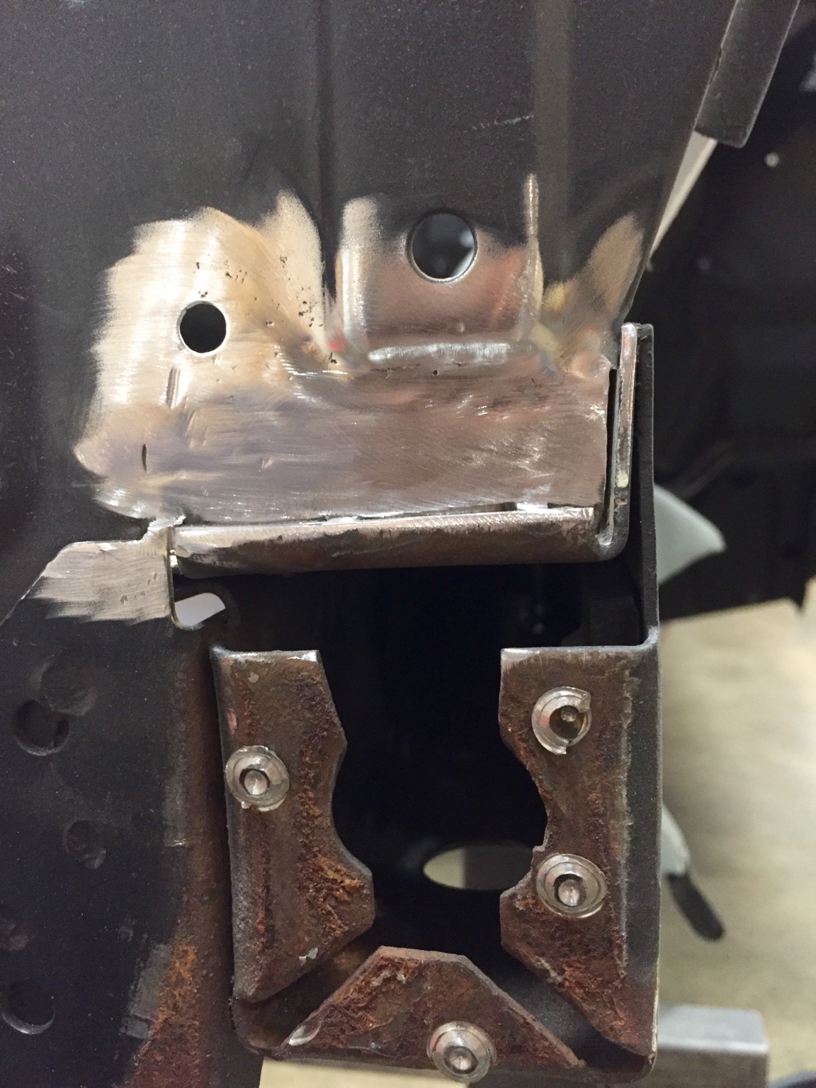

Another patch on the front rail:

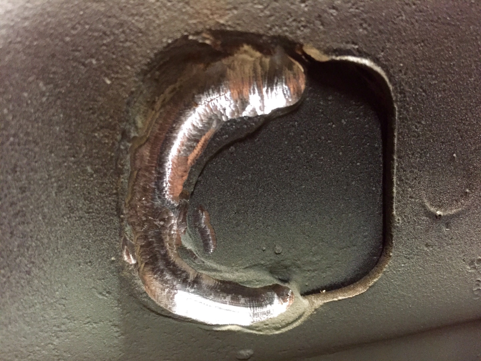

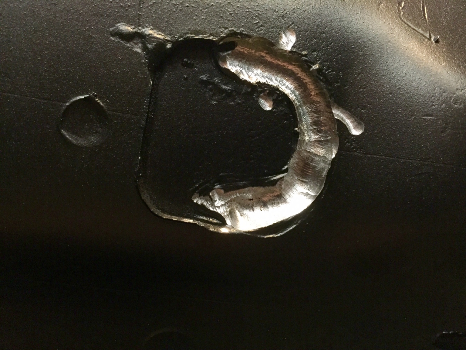

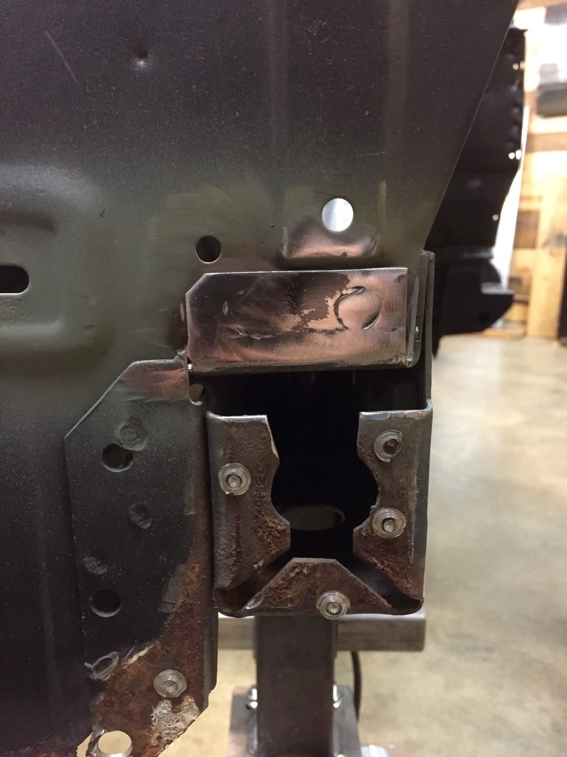

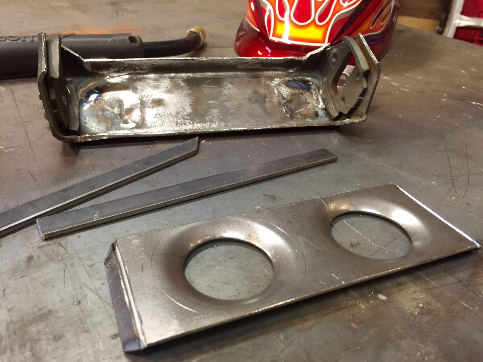

Finally, I returned to the UCA inner welds, and did a bit of investigation as to how far the cracking goes. Answer: all the way through. 3 of the 4 welds had porosity, and 2 of those had developed a crack. I'll cut them out and reweld.

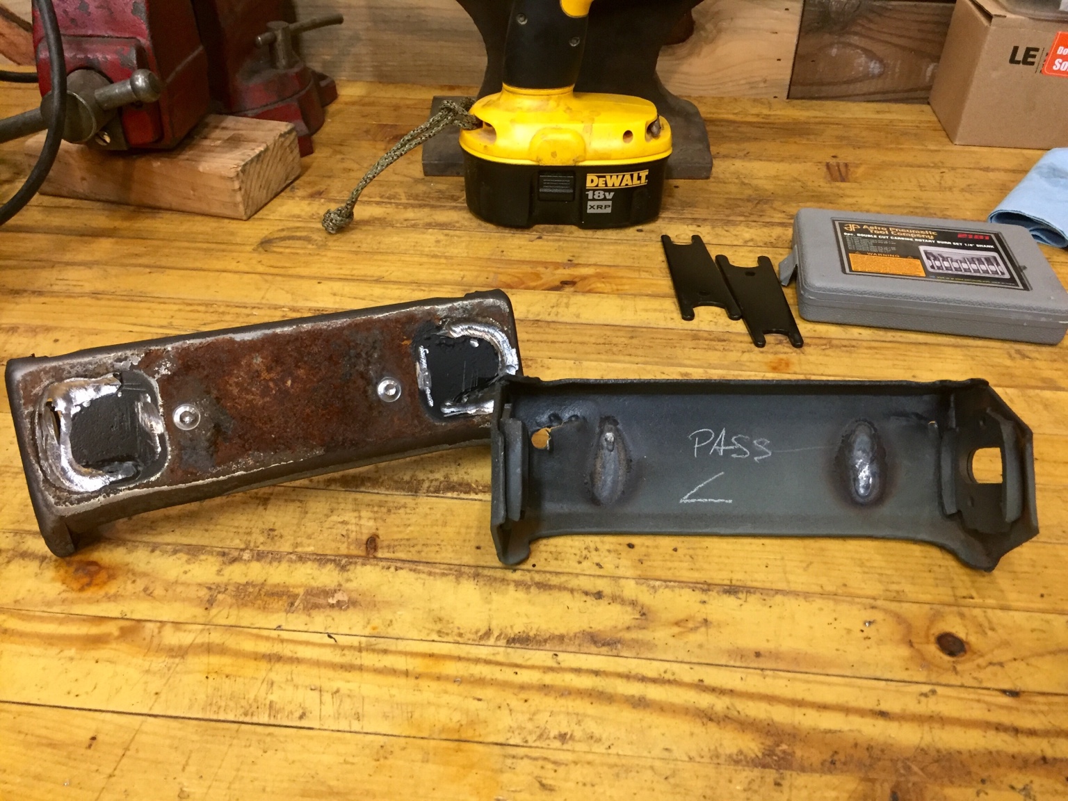

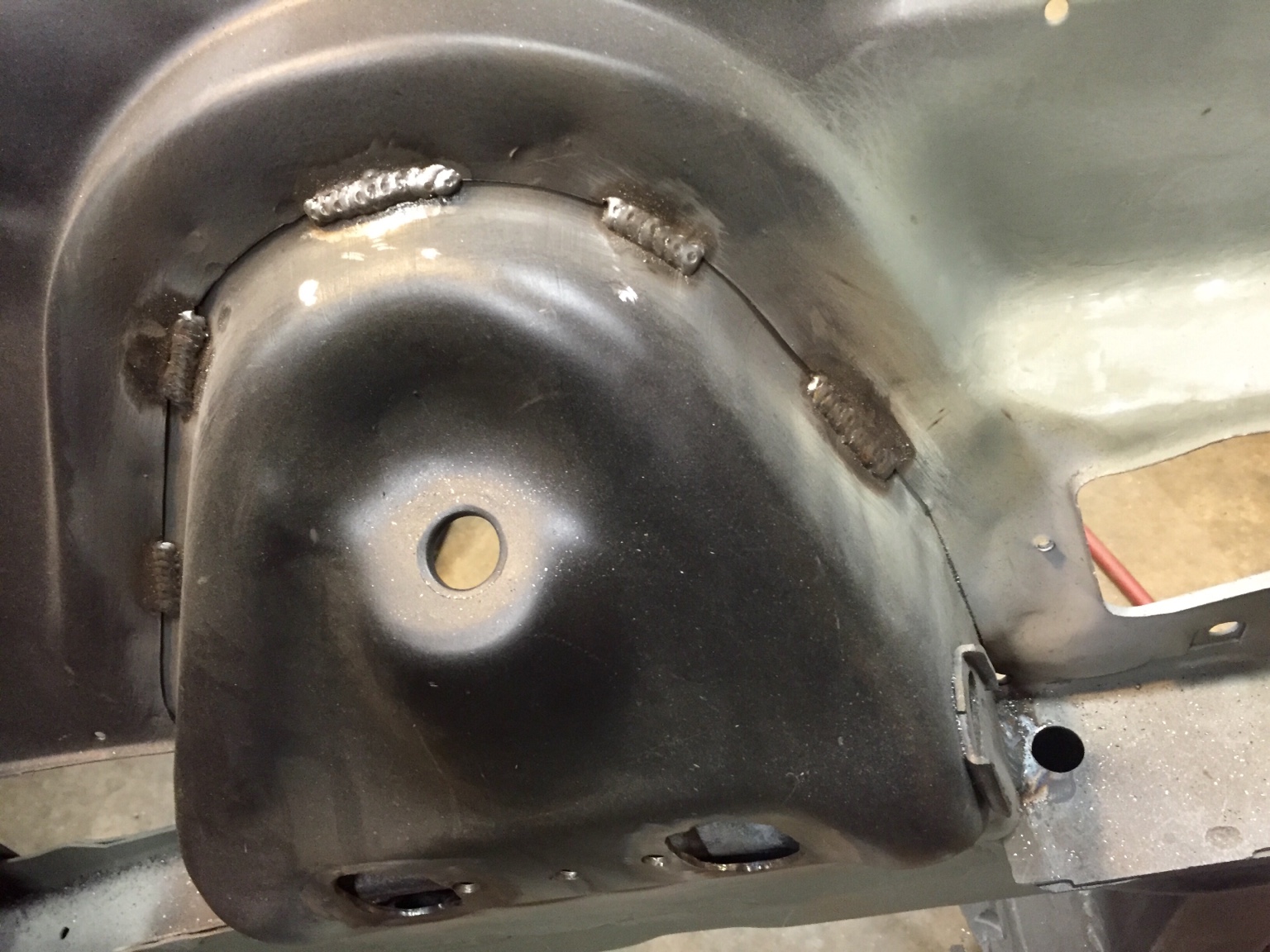

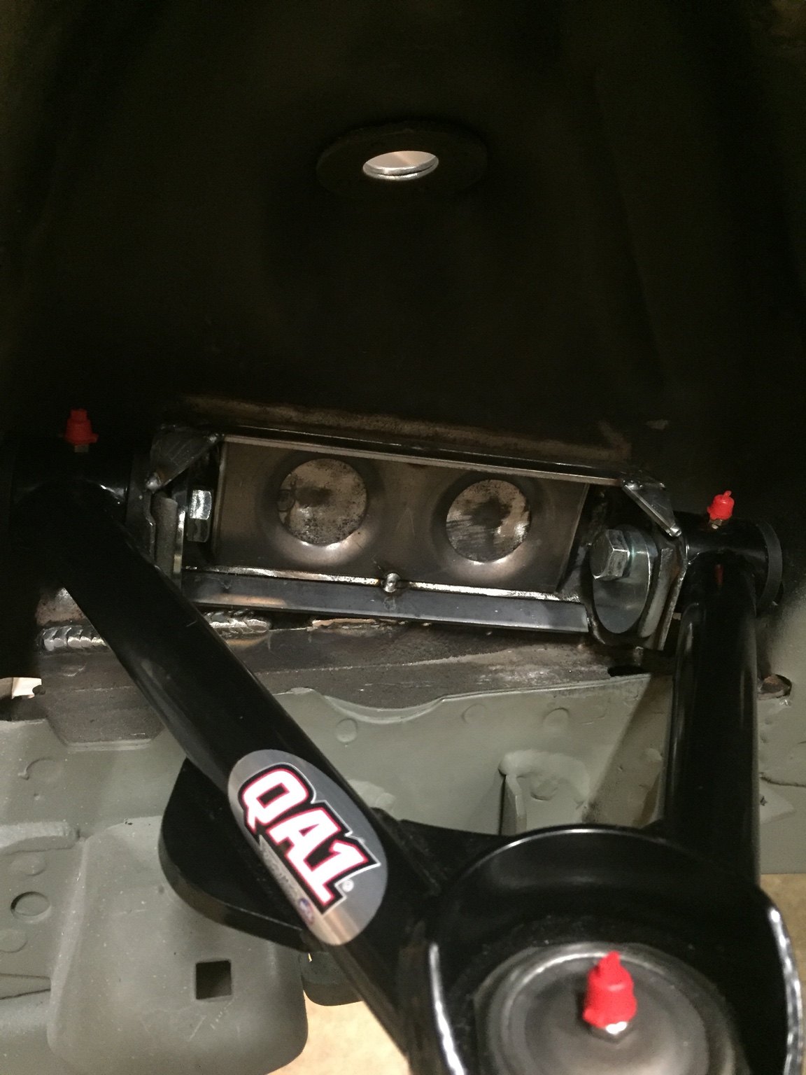

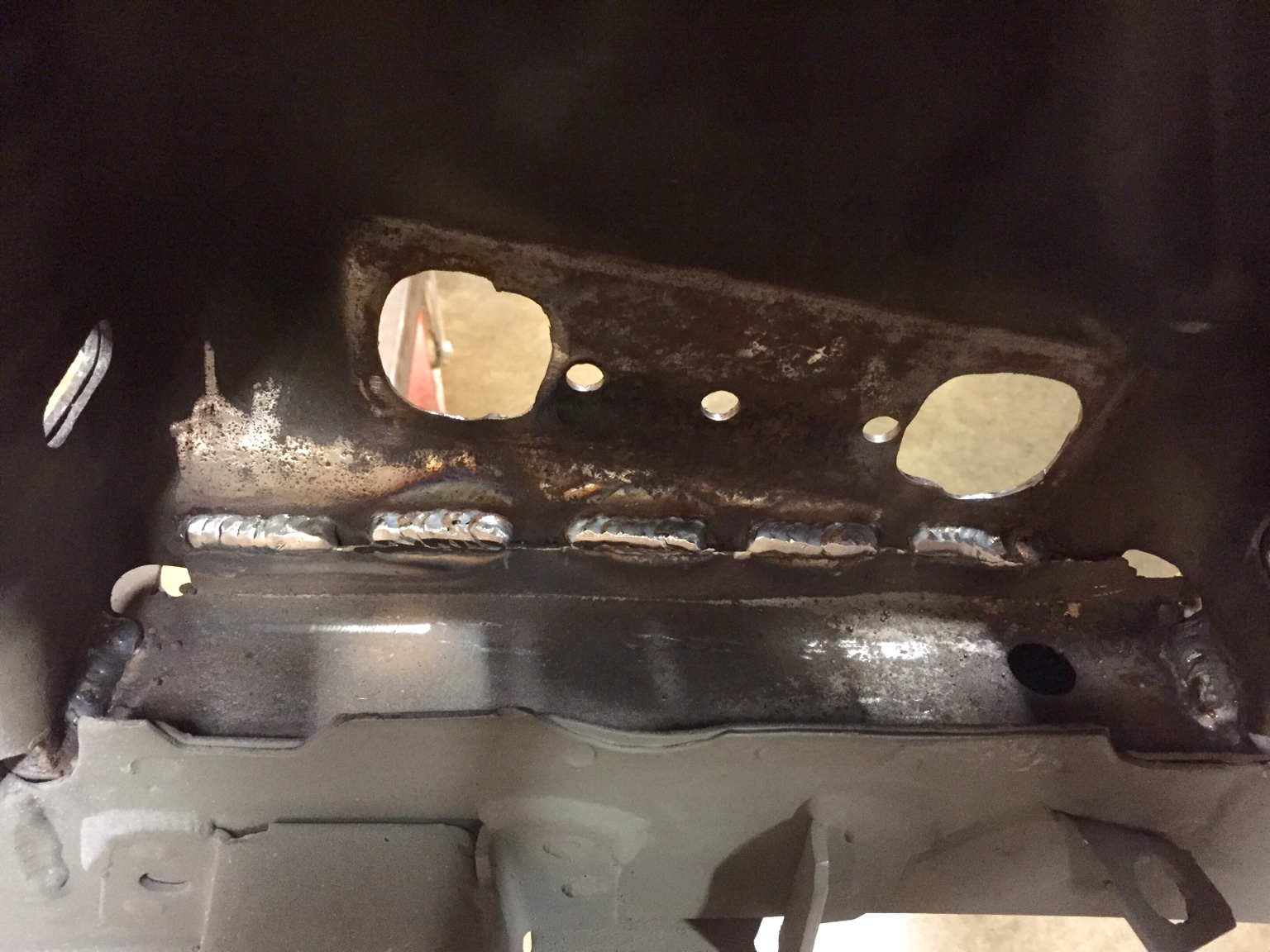

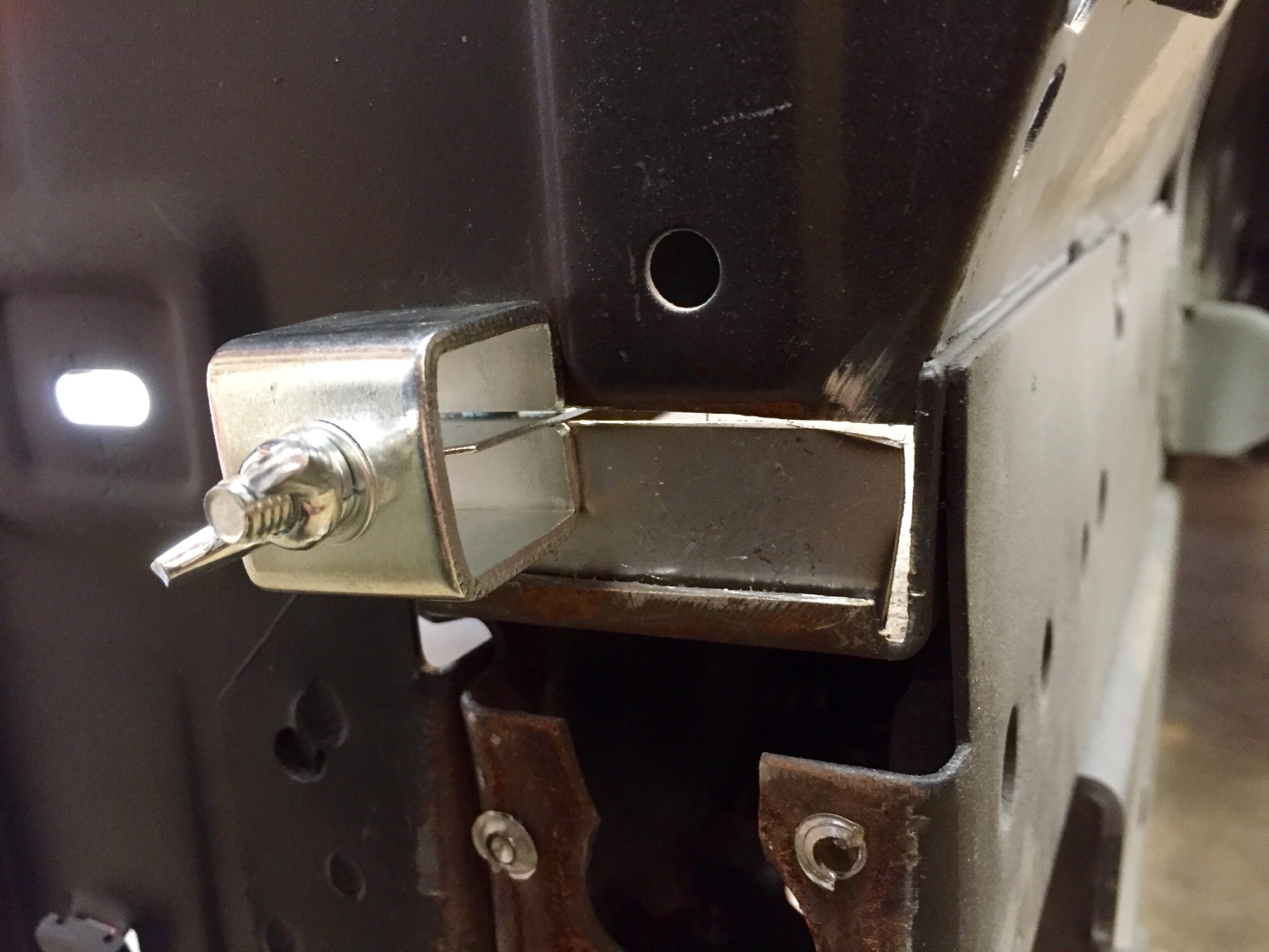

I spent some time focusing on the upper control arm mounts. Either they needed attention and strengthening, or I can't leave well enough alone. Both are fine with me, and probably true.
Removed:
Additional welds:
Make the stamped shape just a bit more resistant to twist and deflection:

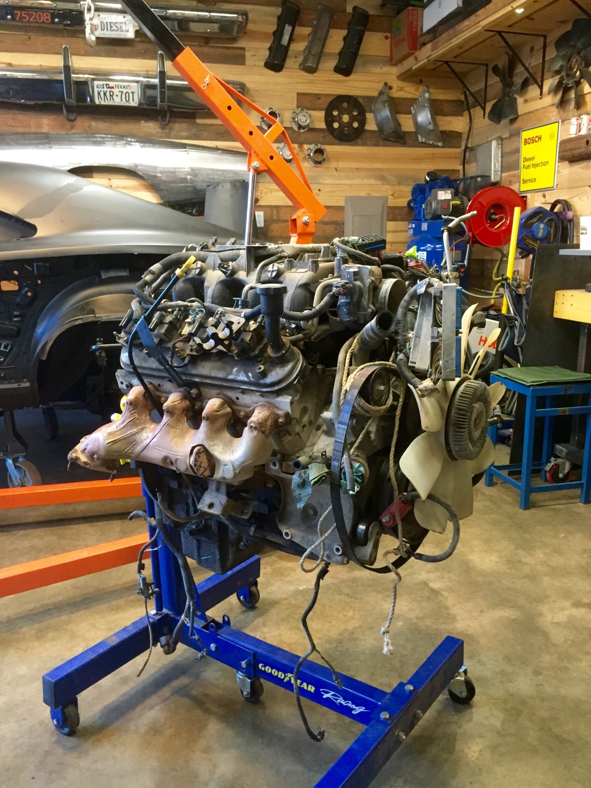

Oh, almost forgot. My most recent birthday present to myself:
...which I promptly took apart. No ridge on the upper cylinder walls, and the bearings seemed in very good shape. Good starting point for a build.

Hmm, no hemi for this?
It was an original 440 car, but came to me sans engine and transmission - part of the reason it was a bargain. A Gen II Hemi is just not (even close to) within my budget, and it wouldn't meet my weight/weight balance goals anyway. That same criteria eliminated a Duramax from consideration, too.
That looks like a solid Ls to start with.
I feel like I got lucky. A friend worked a trade for this engine a while back, ultimately abandoned his project, and was cleaning out. I got a nearly untouched takeout 6.0L for the price of a junkyard 4.8L. It's only job right now is to be a mockup for firewall and tunnel fabrication.
