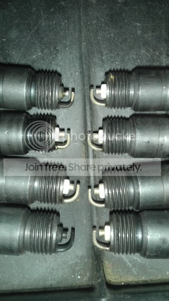

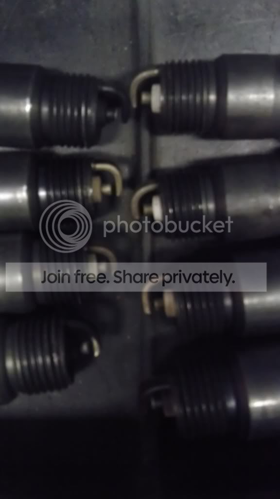

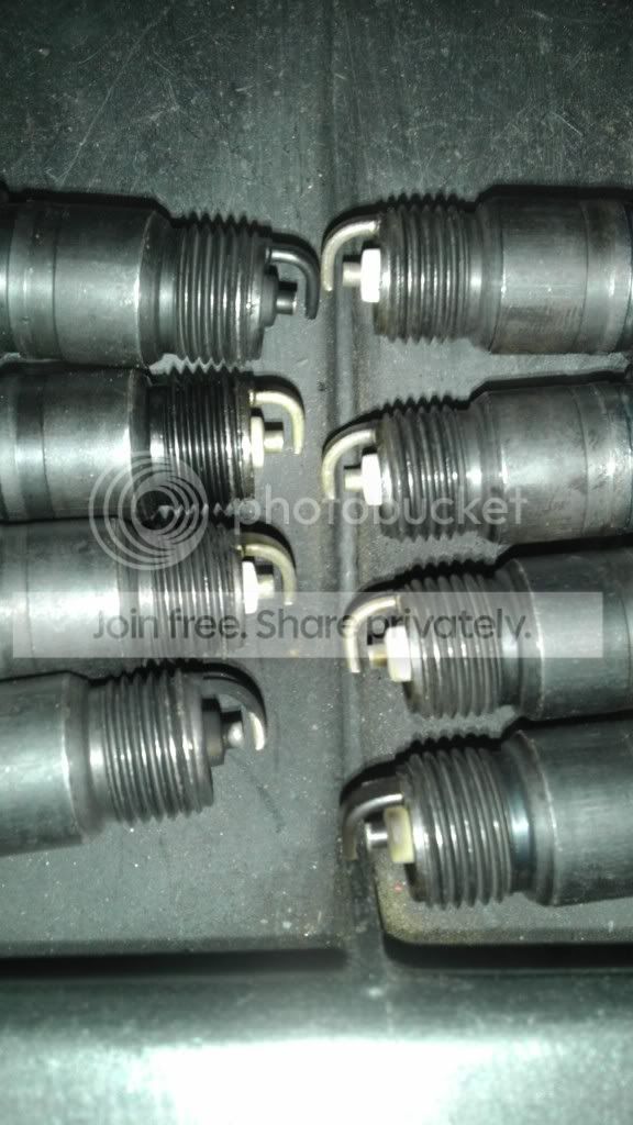

This is as they came out of the motor front to back. The front(1,2) being the near ones.

I just wonder what would cause those two plugs to look totally different then the other 6! Any way, im going to still give this motor a shot cause it would be nice to spend the money i could spend on a new engine, on something like paint. But if stuff doesnt go right soon, i think im going to pick up a 5.3 just after christmas. I would get a different tbi 350 but to find a good running one would cost me about $500. I can pick up a 5.3 for that much and then just have to buy the other stuff like comp and harness and only be into it another grand or so. So, we'll see how it goes. I would like to just get this motor running right! But after 5 years now, its pretty well time to consider throwing in the towel.

Its hard to be sure from pics, especially since the plugs don't have much time on them, but you have at least two dead holes I think.

It is interesting that the front and back plugs on the same side seem to be running rich.

You seem to have two cylinders running way rich, but firing. Some others that seem to be running right, and two that act like they are not getting any fuel at all.
