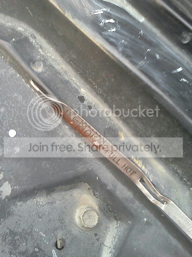

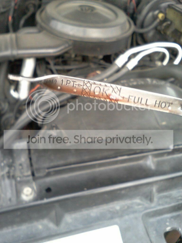

see what the fluid looks like...color wise and check for any particles in it.
i let it warm up and checked it, i didnt see any particals, it was full, but it was dark in color, not fresh looking by any means.

posting a pic of the color in a minute.
looks brownish to me, what do you think?
That ain't that bad... Apparent clutch dust in there. :D
