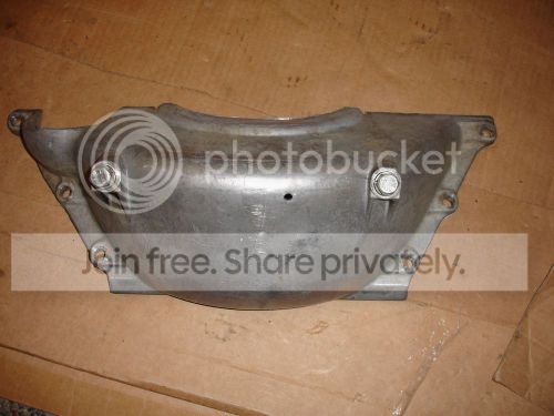

Your converter cover is held on by 6 (3/8") bolts along the sides. Once these and the bars to the motor mounts are unbolted you can move the cover out of the way exposing the nose of the starter where it engages the flexplate.

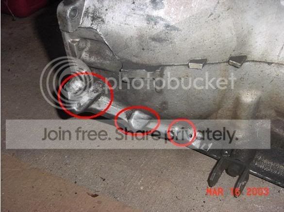

(pic of undrilled bosses on a 2wd trans)
