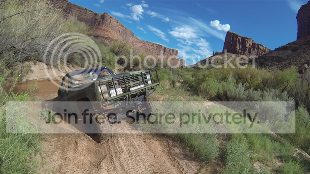

Here is a CUCV brush guard mounted to a winch cradle. This is the older version of the cradle with some bolts on the front that he used. The current winch cradle does not have any bolts on the front, so you'd have to drill them to match the guard. This was done by CK5 member "Richcz28", so please get in touch with him for more details about what he actually had to do.

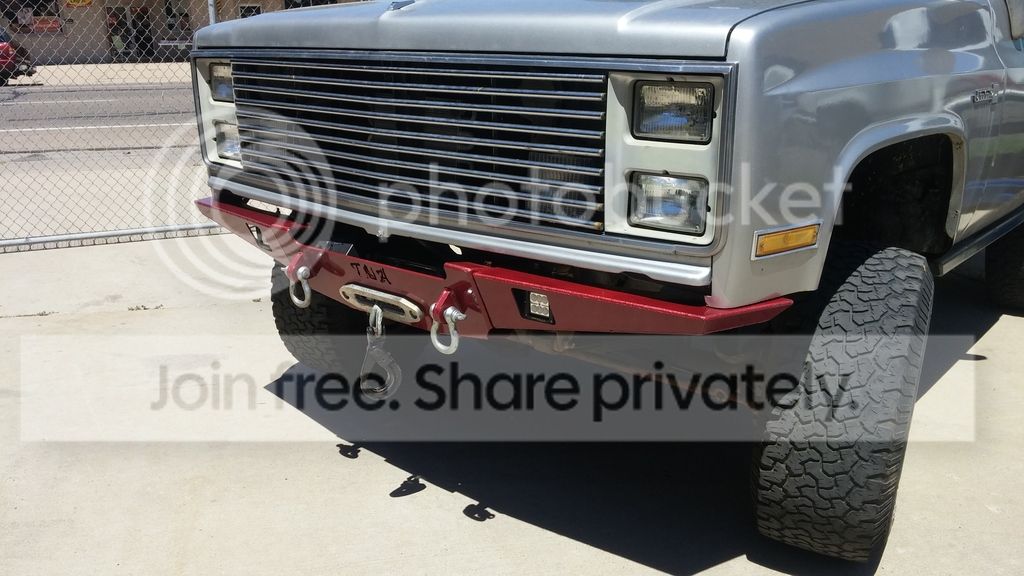

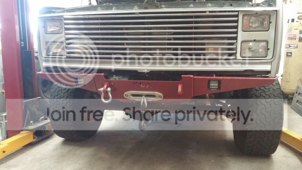

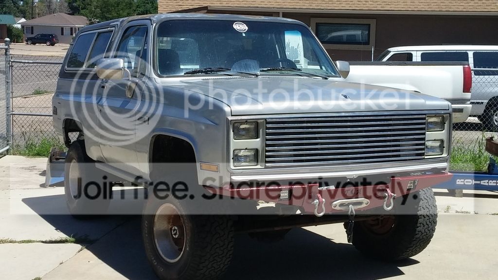

I am now offering the side "wings" with light cutouts specifically for the SideTracked 4 or 6 row LED lights. These lights are very well built, and have great sealed wiring connectors, plus they are from a great vendor here on CK5. No charge option for the cutouts!
Pics:
-Darren
