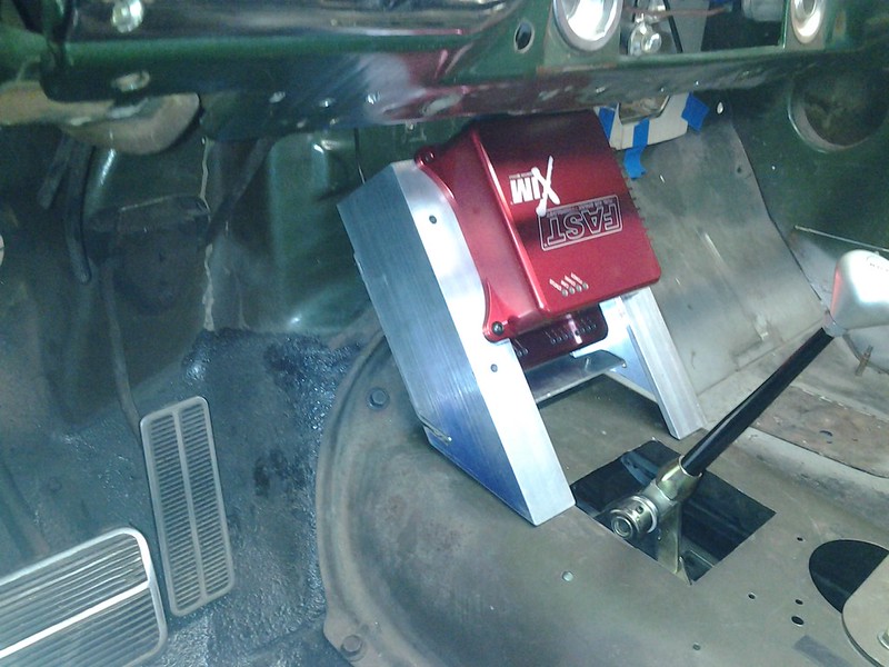

Right now I'm working on the ECU wiring, but mounting them took 2 years to figure out placement, until my son suggested 'C' channel

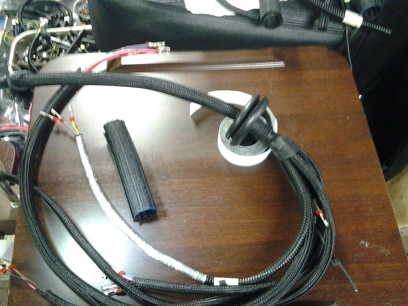

didn't like the corregated sheilding FAST uses, changed to spial wrap from Wire care
Plus the grommet they supplied with the harness was to small. Had to take off all the connecters to slide the grommet on
