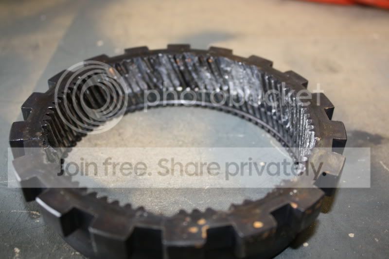

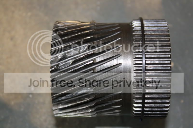

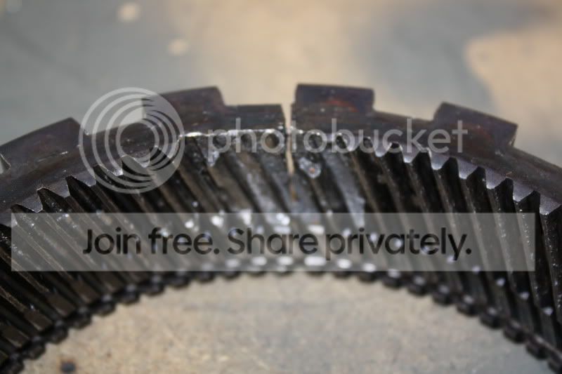

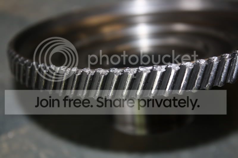

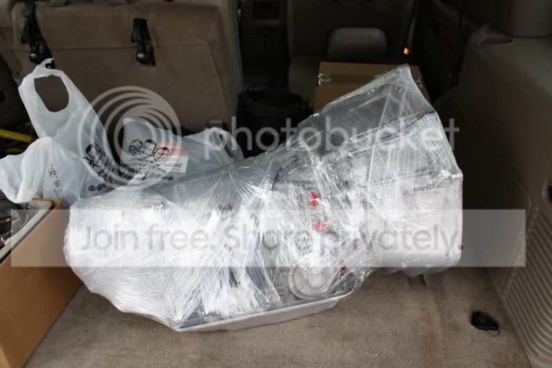

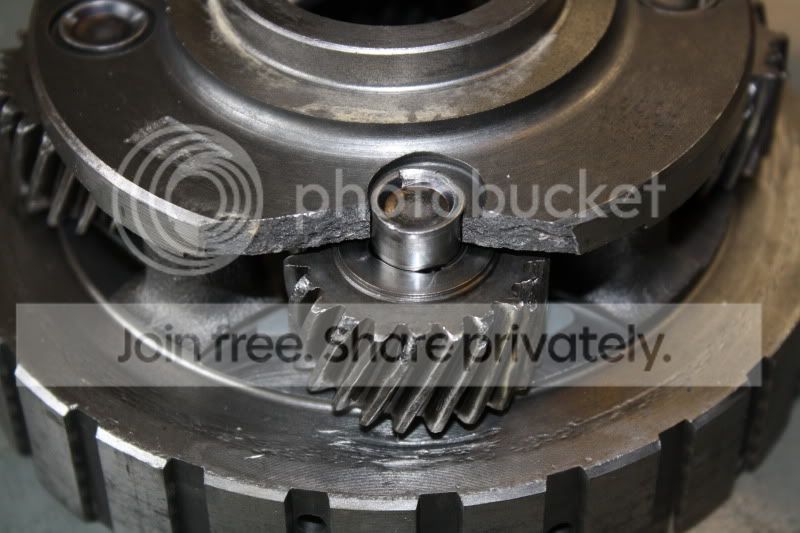

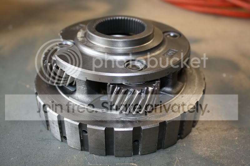

Well I just picked up my trans from a shop I found local to me a place called phoenix transmission they were great to work with and there shop was top notch. So heres some pics of a few of the parts that let go the rear sprag and sun shell. Now Im off to install wish it would just install its self.
All wrapped up and ready to go.

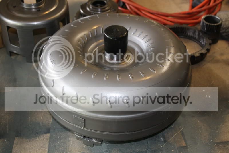

Rebuilt converter.

And now the broken parts!
Notice the large crack
Heres the sun shell it was on the verge of completely stripping.

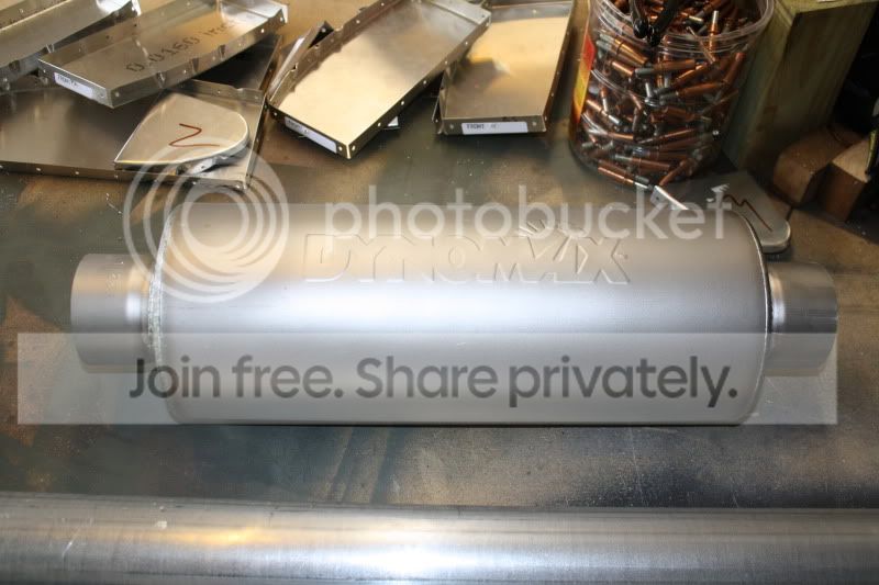

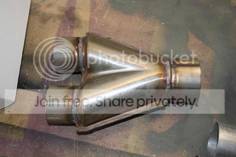

And then some new exhaust stuff to clean up the P.O. hack job it was true duels 2.5in with flowmasters. Now it will be 2.5 to 3in y with a single dynomax flowthrough muffler.
