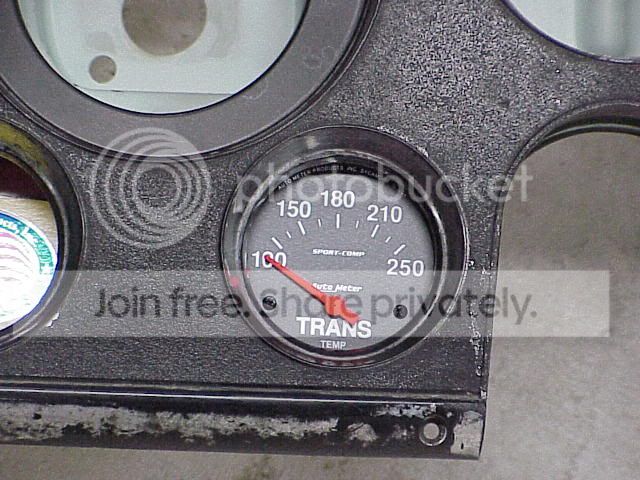

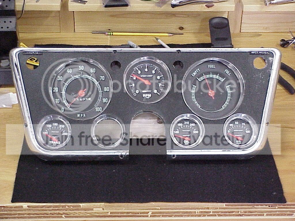

You could try this...
It's an Autometer gauge grafted in behind the stock cluster... a lot of work, but looks really cool and well integrated.
:usaflag:
I was worried you were going to link that or bigblock72's setup. Looking for something that won't take much time and work. Something like that pic would be the long term plan. I just want to grab the car and head back to UT. I'll figure something out.

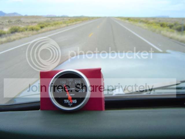

Sorry.....Here's the quick way!
Just remove the gauge from the outer box and leave it attached to the red cardboard on the inside of the box. Bend just above the top of the gauge, and just below it to form a triangular shape and then jam it onto the dash. The dash pad will hold it perfectly in place. :waytogo:
I did this before towing with the 'Burb as a quick-n-dirty solution, and it ended up sitting there for about 5 years! :doah:
