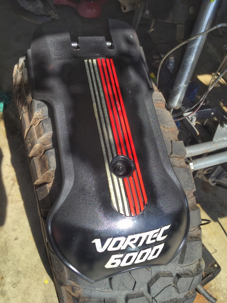

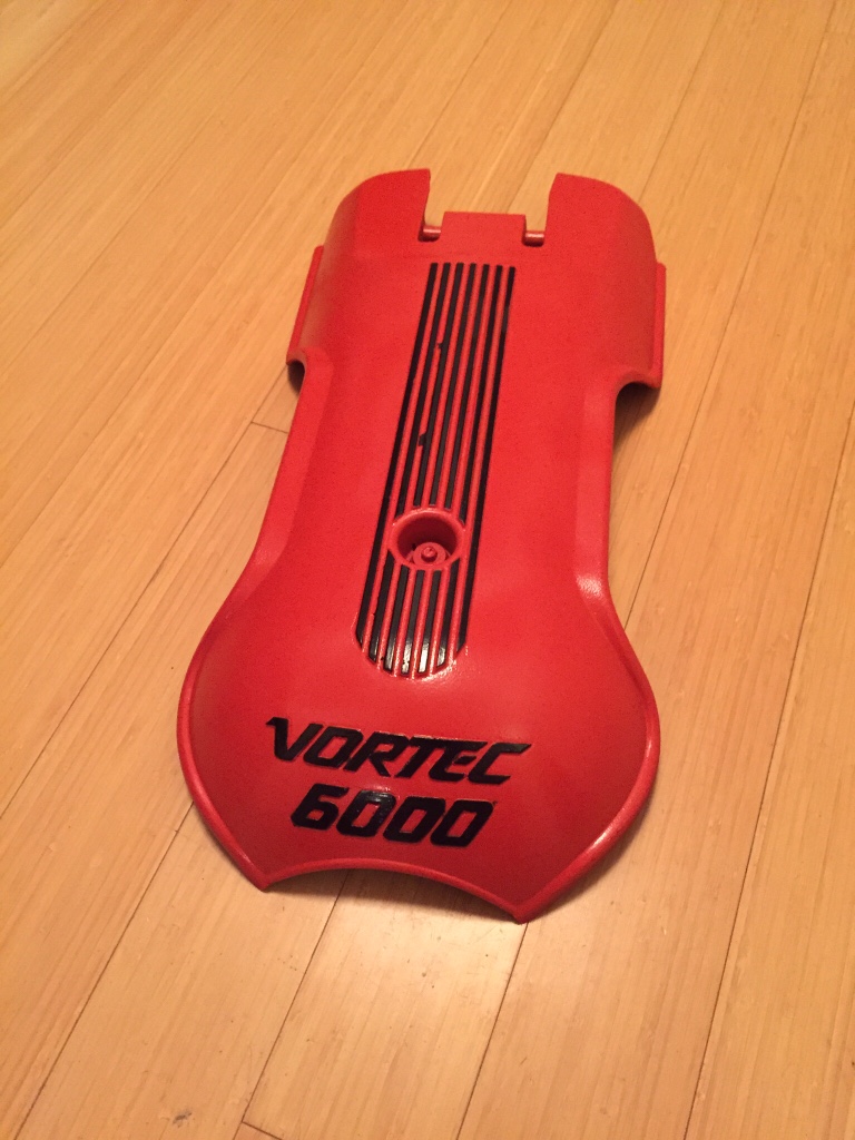

Its the small things right? Got my top cover painted tonight.
Before
And after

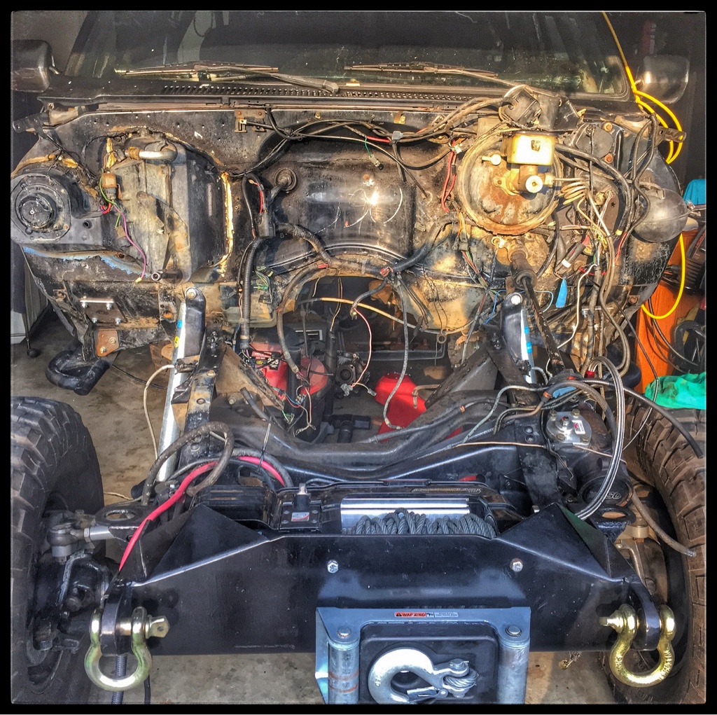

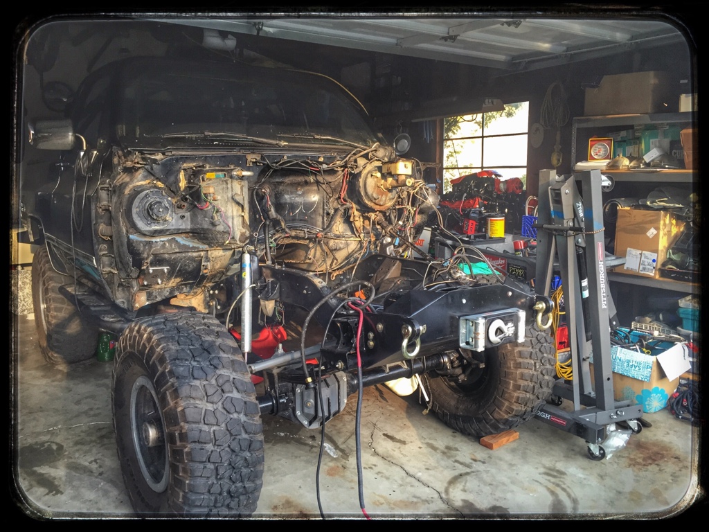

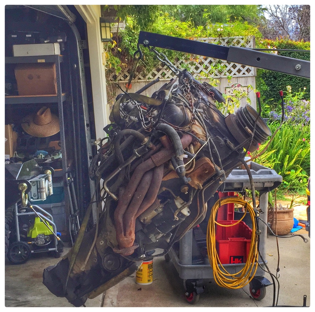

Engine, trans and TC are out. Had some help from a buddy of mine today. First time (apart from the axles) that I felt that I could use an extra set of hands. It just goes so much smoother when you have someone else helping. Especially when they know what they are doing, which he did.
I dropped (literally) the transfer case the other day so all that was left was the trans and engine. Came out fairly easily, we did need to end up cutting the headers as they were really getting in the way and were pretty thrashed. Apart from that took about two hours. No the real work begins....

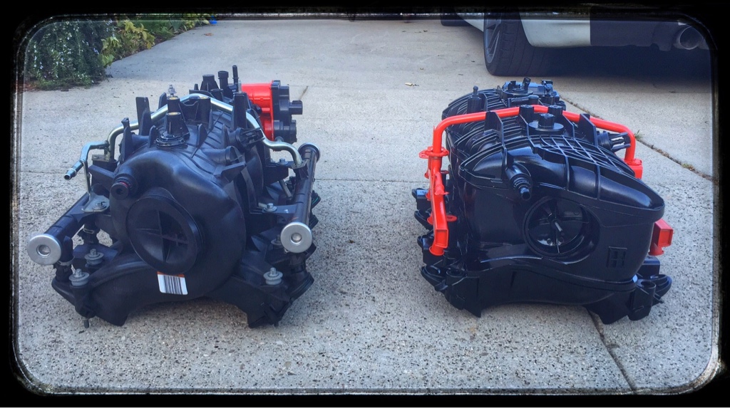

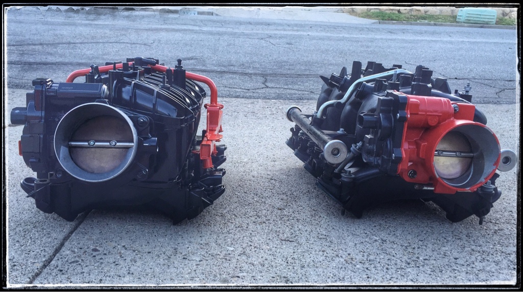

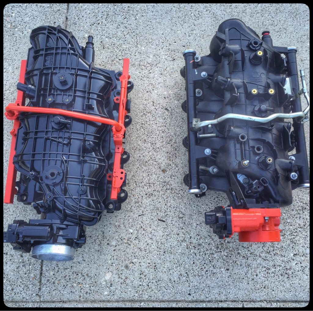

Picked up a TBSS intake this weekend. Larger injectors and throttle body. About a 20 hp pickup.
Thanks for posting comparison photos because I had no idea this intake was bigger. Is this still a cathedral port intake!
yes, it is a direct bolt on. I got the intake complete with injectors and fuel rail, but I am using the gaskets from my old intake. Sensors swap over (although there are a few in the wrong place).

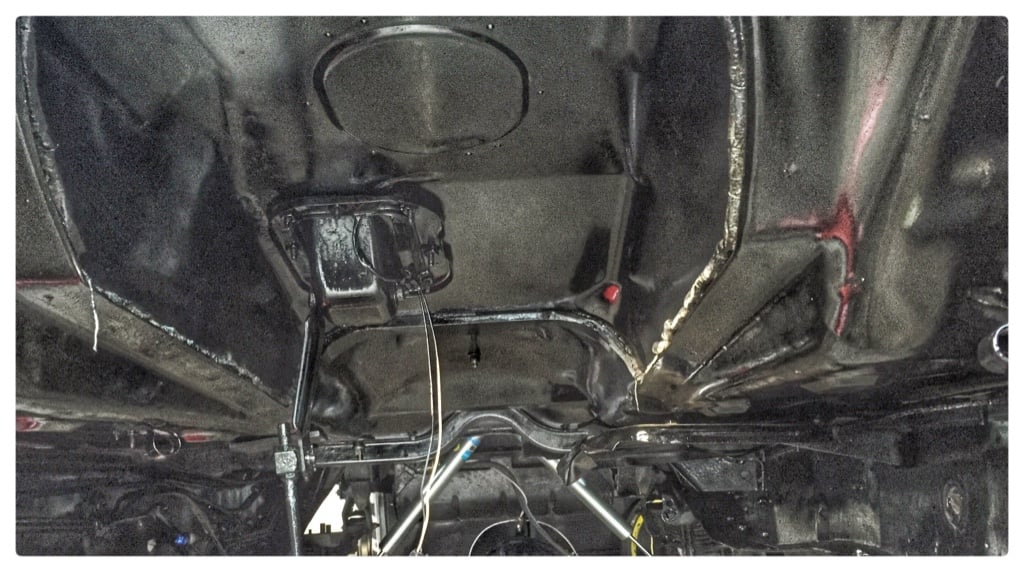

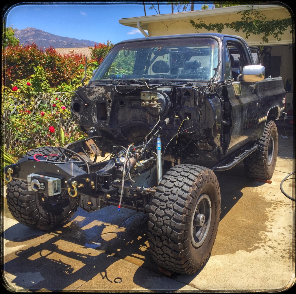

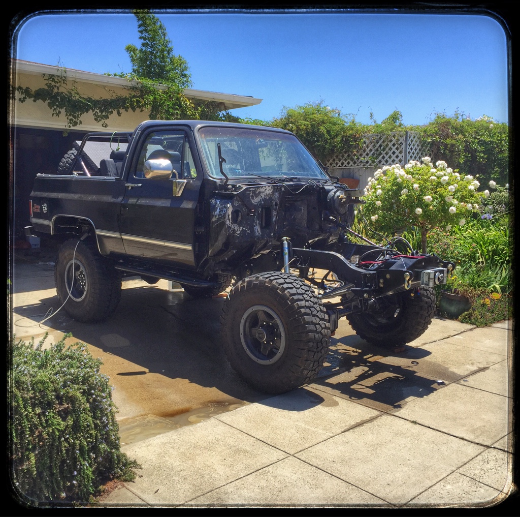

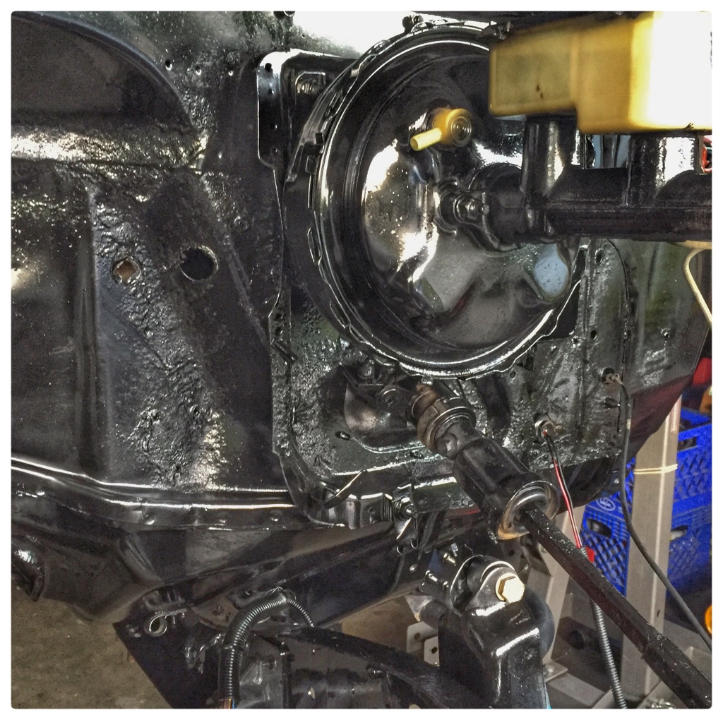

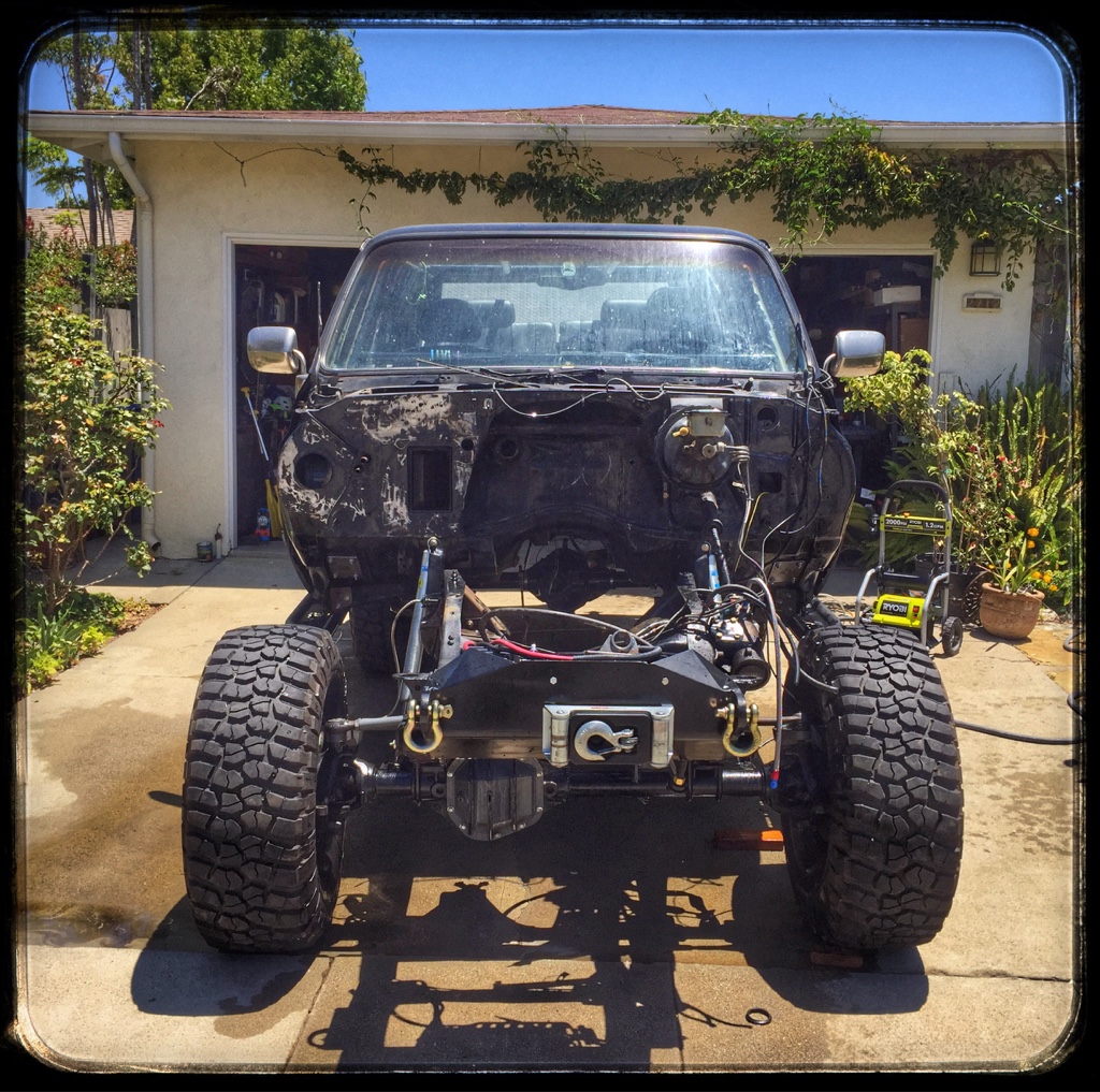

Rolled the truck out into the driveway to powerwash, clean, degrease and get ready for POR15. Took a few hours but got it 90% of the way there.

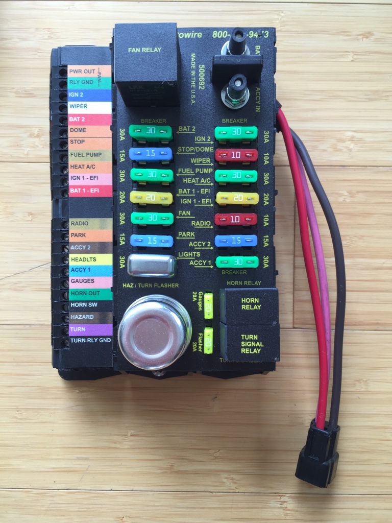

Got my American AutoWire Highway 22 kit in yesterday. Pretty intimidated by the wiring and how much work it represents. This project has just grown and grown and grown. Kinda overwhelming at times. Pretty worn out by how much work I have ahead of me. I used to think that the engine was gonna be the big part but that is looking like it will be one of he easier things now. Guess we will see.

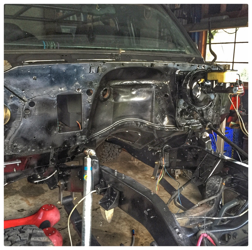

I am waiting on my crossmember so I can drop the LS in and see where everything lines up. In the meantime I have been painting, cleaning and prepping.
I decided to dump the gray and hit all the accent pieces in Chevy orange. I know I know really exciting and tech, but .....

I know this is gonna be sweet, but wiring is not my strong suite.
yea, I know it will be good in the end, it is just not something I particularly wanted to be dealing with. To be honest, it is not the wiring that I am concerned about, as that is pretty straight forward and the directions are pretty detailed, it is routing everything correctly and securely. I am not sure how many places I will need to gut the entire old assemblies and reinstall new ones.
