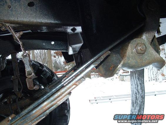

however there was another guy there looking at my truck and said he would have failed it..... but since he didnt originally inspect it, it had to go.... however he "asked" me to park the truck until it is fixed!!!!!
He said my rear leafs dont belong on that truck.. they are too long...
he said that they are binding and not allowing for any movement.....
and you know what... I believe him too... you can see it...
once again Hoper John's 4x4 truck shop has screwed me again.. thank god I dont do anything through him.... he put these leafs on the truck.... just asking to kill me as that can break a leaf....
so my question is ..... how long are leafs supposed to be?
he said my shackle should be more straight up and down... not angled like that....
can someone with a 8-12" leaf measure the length and height for me as I dont even know what size leaf it is as in lift.....
I am 54" from center of bolt to center of bolt....
I wonder if I take the leafs off to a shop and have the eye re-bent so it is a shorter leaf if that would work.. I vaguely remember a 53" leaf on these trucks....
ok pics...
you can see daylight through the leaf.. thus they are bending.. so there are problems here....
called superlift and they said these leafs belong on a truck with 56" leaf length... I need the 52"....
anyone wanna buy some leafs???
he said with loaded weight they are about a 10" rear lift leaf spring.....
so now i need to hunt down some springs... or take these to a spring shop and see if they can shorten it down to a smaller setup....

looks like time for a 2.5" shackle flip! take a couple leafs out, problem solved
well that is what im thinking.. I asked them about that and they said they had to see them first before they would tell me if the truck is legal with a shackle flip...
so if I do the 2.5" flip.... you say remove a couple of leafs.. like how many?
also just messagd ord to see... we will see..... doing the flip would be cheaper than buying new leafs..... :crazy:
if you took out the overload and 2 or 3 others, and then did the 2.5" flip that should put it about back at the same height it was at before

I moved the rear hanger back on my truck to fit 56's. It was easy and free.:D
ok... so if I did the flip.. and took 3 leafs plus overload out id have 3 leafs under there.. guess that would work...not gonna worry about it until summer....or spring.. too cold and that white stuff is falling... :haha:
yea thats what id try first, cuz u have to get the hanger off anyway to do the flip, so just try move it back a couple inches. if you mess up or dont like it, then you do the flip;)
What size bolts did you use? it is cold and snowing so dont want to go out to check... but gonna do this in a week or 2....
appreciate it..
