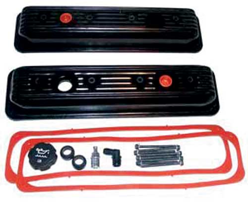

The crate GM motor I just bought has orange seals, and they have little tits on them that help indicate if the gasket stayed in place. No clue if that is their real reason to be, or if just part of the manufacturing process, but they work. This is really only an issue along the top rail of the valve cover, since that can fall into the rocker arm area which is almost impossible to see on my rig, while you would see the bottom if it fell out of the valve cover. The GM pieces are also much stiffer, holding their shape better. Cannot recall if the fel-pro's were that way when I got them, or already soft.
Here is what my GM (? or whoever GM sources them from) gaskets look like. Note the 4 tits. Installed, you can see these protruding from under the valve cover, if the gaskets stay in place on install:
While this is what my Fel-pro's look like:
