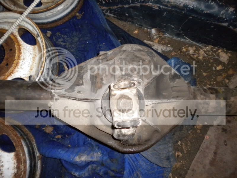

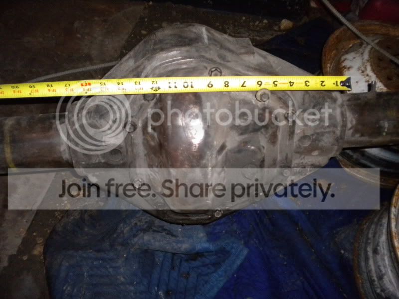

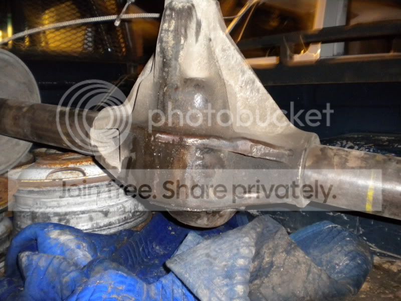

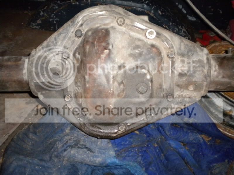

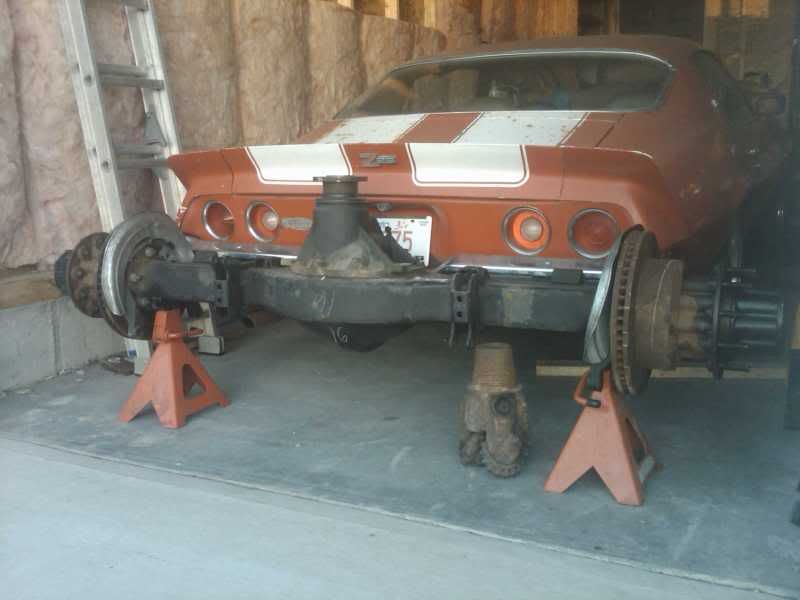

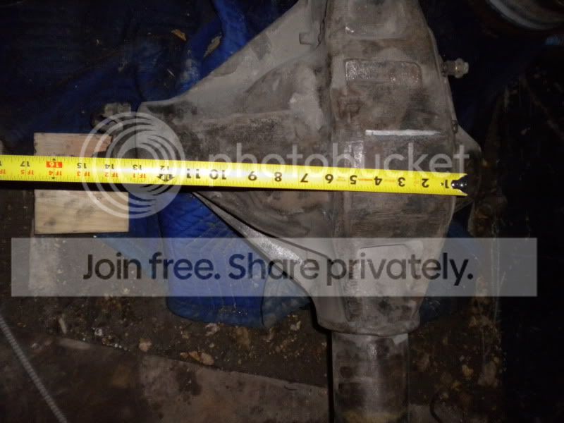

i took some more pics for ****s. this thing is MASSIVE.
over 18 inches wide and around 14 inches housing to yoke, its ****in huge.
That thing is sweet! :saweet: I wish I could have found a housing like that when I built my 70HD. :eek1:
Drum brakes, right? Any idea of drum diameter? Standard 8 on 6.5 lug pattern? Are the axles flanged like a typical 70 or are the splined on each end with a drive puck & cap? What's the wms?
Inquiring minds want to know! :ears: :D
15 inch total height drum brakes, same 8x6.5 dually wheel hubs youre used to, 4.5 hub diameter. shaft uses 8 bolts bolted on like the 14 bolt shaft. and 74 WMS.
