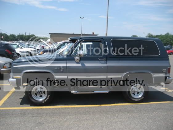

ITs stock, so i think they're 31s. I do notice the thing start to loose it going up long hills on the expressway. Think the 3.08 does not use the engines power most efficently? I was planning on a 4 inch lift and then putting 33 or 35s on it when the current rubber runs down. This is it now:
