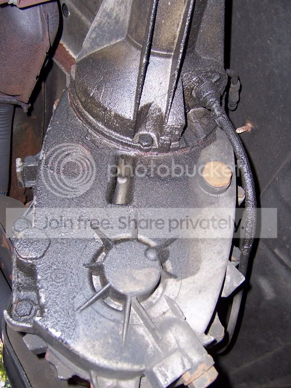

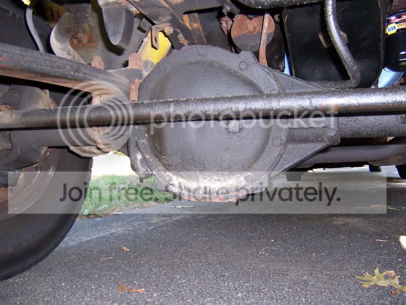

Yeah, it seems that alot of it isnt too hard, just need the tools and im sure once ive got through it once it wont be bad. My plan is to id the tranny t case and axes with the gears and see what i have. If shes still alive and kickin next summer ill probably purchase the lift and maybe 4.11 or whatever it is. I have the lmc truck catalog and it looks like 400 for the 2 sets of rings and pinions, if thats all i need (i assume thats it but im sure im wrong) pluss another 6 for the 4 inch lift. I plan to do it all myself and i have never worked that extensivily on a vehical before. But ill have my friends help and im sure ill get through it. I just wanna see if its worth it yet. Any way to id the axles or tranny? illpost up a pic of the t-case tommorow.

Post some pics of everything you want I.D.'d. Also your transfer case had a tag on it when it was new that told you what it was. Rear axle: count the # of bolts holding on the cover- 10, 12, or 14. Just be advised that there are 2 kinds of 14B. The fronts will all have 10 bolts on the cover. It doesn't matter if its a 10B, D44, or D60. You do not have a 60 so that leaves the 10 or 44. If it doesn't look like a Dana cover its the 10B. The pic of a 10B on the CK5 axle ID page doesn't look quite right. But the Dana one is perfect.

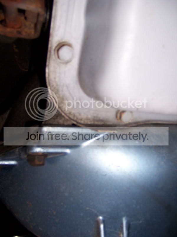

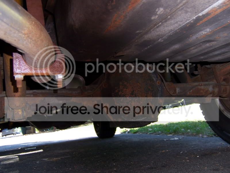

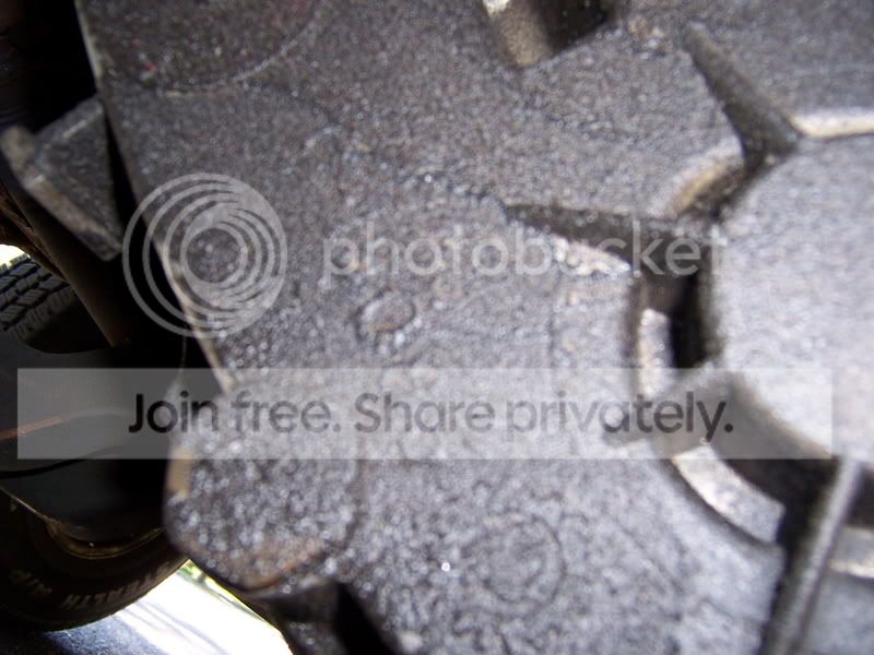

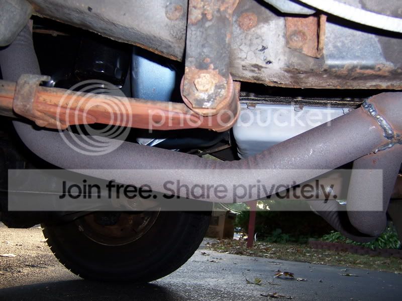

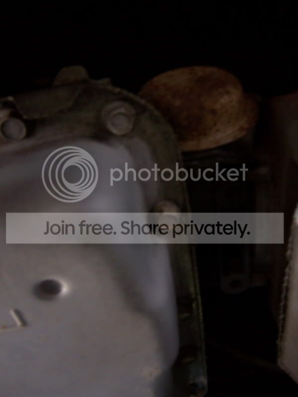

Alright here we go. Upon further inspection, it looks as if the front axle may be new, as well as the tranny was worked on as well as a new/reworked t case. So it looks as if my drivetrain is pretty new. Also, i noticed almost no rust under the middle of the truck. Only the usual little at the edge of the tailpan and by the doors/rockers. Is this normal or is my underbody pretty good? Im not sure. also i tried to get pics but it seemed very hard to get angles of the tranny. Let me know ill try for more if needed. Heres the pics. Oh yeah, it appears i have 10 bolts.
If you want morepics just ask me where to take em and i will, if someone knows wher the number on the tranny is then i can id it. i hope. Thanks!
http://i4.photobucket.com/albums/y117/Aragorn2087/100_0651.jpg
Yep...10 bolt axles front and back, NP208 transfer case... I can't make out enough of the transmission, but it's probably a 700R4. If you could back the camera away or zoom out and take a picture of the tranny pan, then it'd be easy to I.D.
Also...FYI...in the 2nd pic of the transfer case, there's a round, red tag held on with a screw in the center. It's covered by a lot of grease and grime. Wipe it off with a rag, and that should have the model number...

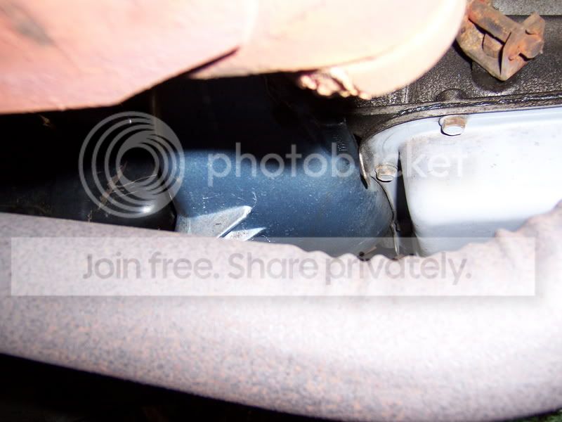

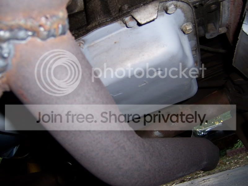

will do. yes it is a 208, just checked the tag. Heres the tranny pics..
Its really hard to get the whole angle. Thanks for the help.
Given the year of your truck and fact that the axles and t-case are probably stock (even if they've been worked on), the tranny is almost certainly a 700R4. As for the motor, do you know it's a 350?

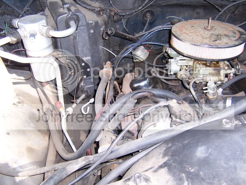

i was told by my machanic its a 350 and i know alot of people swap out the 305 in favor of the 350. Ive know its hard to tell the difference between a 305 and 350 and you need to check the numbers on the block. Ive looked at all the places i was told and its just bare metal. So im relying on what the mechanic told me. As far as the gears, its 3.08 stock, but if i go with 33 or 35s do you think i should change them or would it be fine with the 3.08? Im still going to check to see if its really a 3.08 eventually.
i read about the 700r4 that it wouldnt be able to handle the power of a 350? Was that just the early ones or what? IS that why you think it might not be a 305? Any other possible way to ID a 305 from 350 because im having a really hard time with this.:confused:

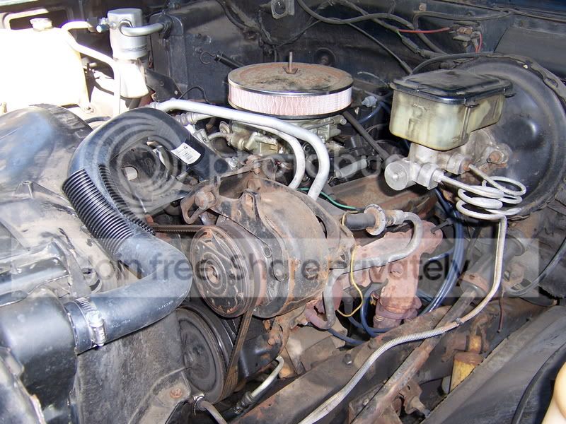

bumppppppp Anyone know any way to ID the motor without ripping it apart? I tried looking for the numbers behind the altenator on the pass side of the front of the block, i even tried whipping it down but its just flat metal. I heard theres numbers on the driver side rear of the block but theres no way im getting back there. Any other way? I mean my mechanic told me it was a 350 and i believed him because i mean if it had a 305 and it was blown, i would assume it would be more worthwhile to put a 350 in. Plus it looks like the whole drivetrain had an overhaul. But do you guys think its a 305 being its pre 1987 withthe 700r4 tranny? IF anyone has any ideas how to id the thing let me know. Thanks! I eventually wanna put an exhaust on it with headers. and in case i need any parts. Thanks1:confused:

At this point, your two options are tearing it down or finding a casting number...somewhere. Beyond that, I'm afraid you're out of luck. GM engineering dictated that pretty much all small blocks look the same and, for the most part, can interchange parts. But that's a good thing :D
Can't you slide your hand back there and feel around for the casting numbers? You don't have to see it, just find it. Use Silly Putty (or similar) to make a negative of the casting marks once you find 'em. If you can't find it from the top, try from underneath.
