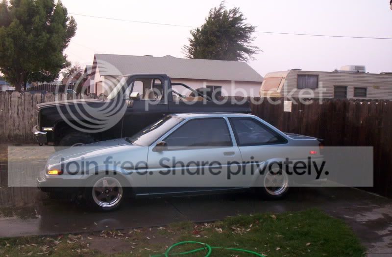

imho if you want to "drift"? do like i did and buy a car like this for around $400.00 and your set!:D
