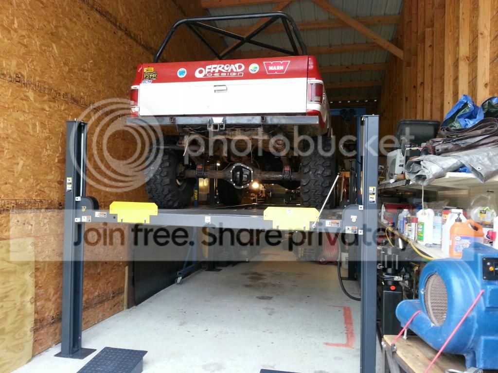

Well..I pulled the trigger today...BendPak Lift
I have to pull out the shelves on the right hand side and move all my crap down into my second storage space.... recenter the lift in the doorway and call it done... :D
I picked up a Bendpak HD-9XW-B and an RJ-45 rolling jack for normal shop use and discovered an additional use for it.
Gus
Well, she's installed, kinda.
Far more work than I imagined. Airs line plumbing, concrete grinding, never ending adjusting and tweaking...but...it works....very well.
Now, all I need is for the jackhole door guy to show up who said he would do the job a month ago and convert my door to a high lift door so I can get the additional 5' of lift. I have an 8' door, but the opener sits down another 1' on that, I have 12' ceilings so I'm being pimped out of 5', the difference between I can walk under the car or not. Anyway, that's a minor issue.
This thing is a beast! It does not hesitate, bend, move, have any issues as all.

Maybe you could extend the straight section of door track and add another panel to it to gain another 2 feet?..
These wall mount openers work really well, we used one at my Dads place after we installed the lifts.
