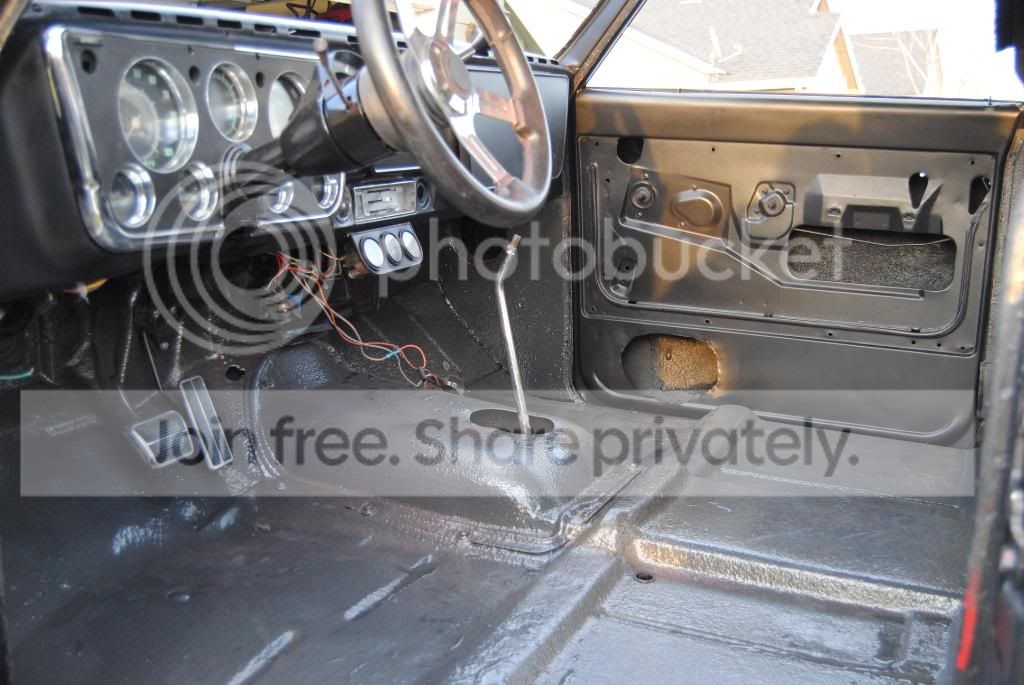

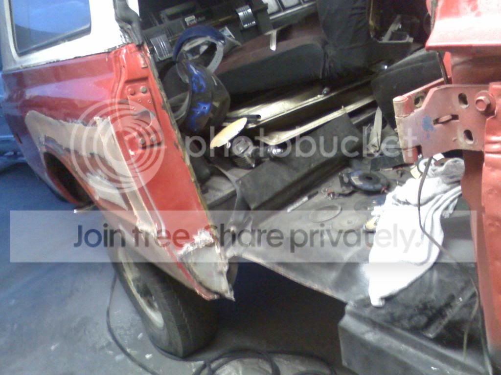

So what better time to cut out all of the rot in the floorboards, and to finally fix the bedsides. I wanted to ditch all the factory CST trim and make it a little cleaner to look at.
When I first bought the Blazer the previous owner had done numerous "upgrades" that I was not fond of. He had cut out the factory rocker boxes in favor of some hickey saddle tanks and cut some fuel doors in the bedside for them. I welded in some patches and threw some filler over it, That had started to crack after I started to wheel it. He also cut a hole under the tailgate band in the VRO area, I never messed with it because I was going for a quick and dirty paint job to get the thing on the road.
I ended up grafting a new VRO into the tailgate, I still had the bedsides from my 67' and replaced a large portion of each bedside, new floorpans, kick panels, and rockers.

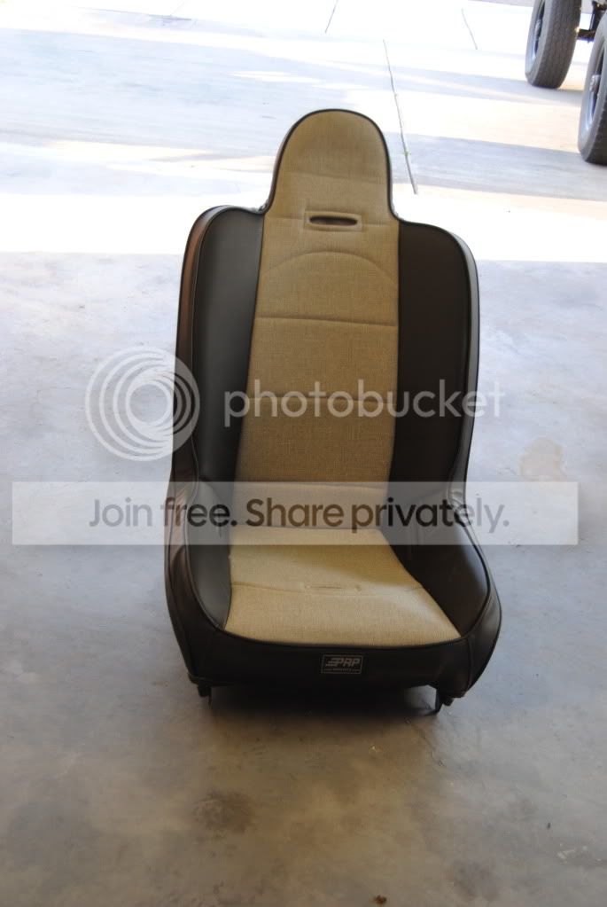

At this point I Picked up a 2006 cummins megacab. Now that i have a tow rig I can get a little more into wheeling with the Blazer now that I can tow it there and bring it home broke without worrying how Im gonna drive it home. I ordered up some PRP suspension seats and am going to do a full family cage for it. I ended up giving my hardtop away and ordered a softtopper for it as well. I got a 14bolt ff that I am getting the 4.56s and Detroit installed into and picked up a DIY disc kit for it as well.

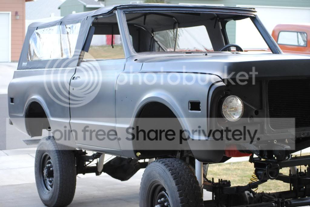

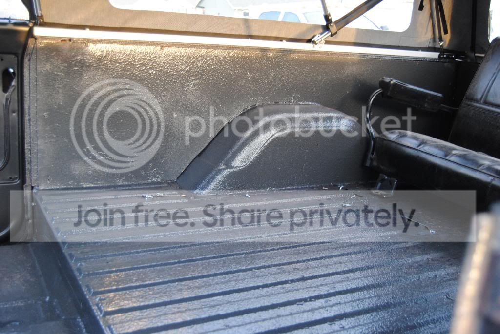

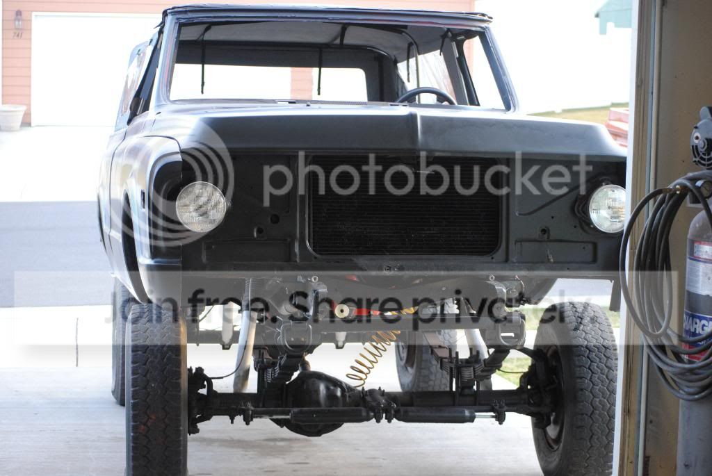

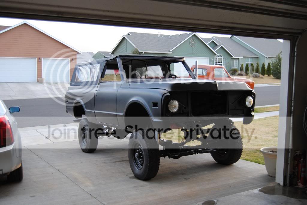

I ended up settling on painting it a medium charcoal metallic paint and Picked up some ALs liner and tinted it body color as well. I just pulled it out of the garage and hopefully I will be taking it over to a buddys house so we can start on the cage.
I am wanting a rig that can do a little of everything. I am not a cut it till it clears kind of guy, I am going to have one of my buddys that has been doing bodywork for close to 20 years come by and help me open up the wheel wells, So I can drop it down. It was always a daily driver before so the height never bothered me. As soon as I find me a dana60 that isnt made of gold, I am wanting to do a 52" spring in the front and some longer ones in the rear. Then do crossover and maybe hydro assist. We dont have a whole lot of rocks nearby, but as soon as I get it dialed in, our group is willing to travel.

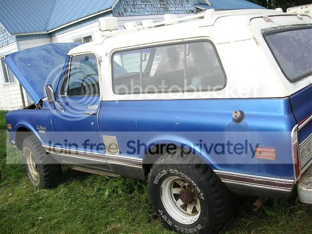

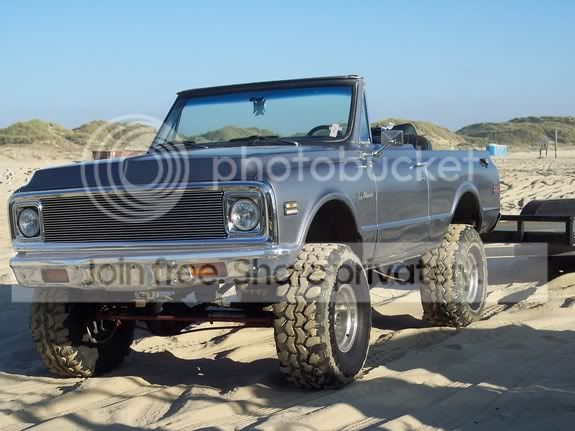

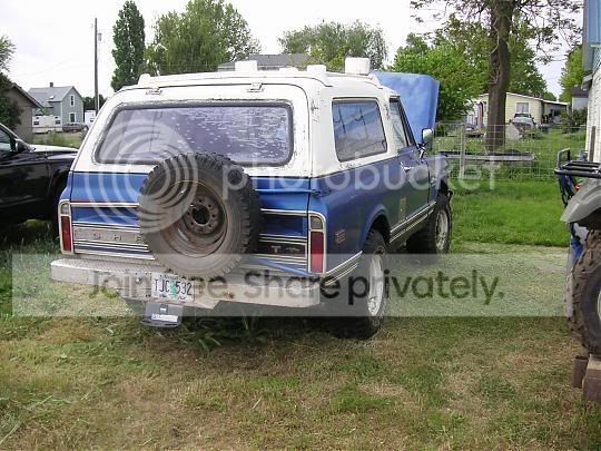

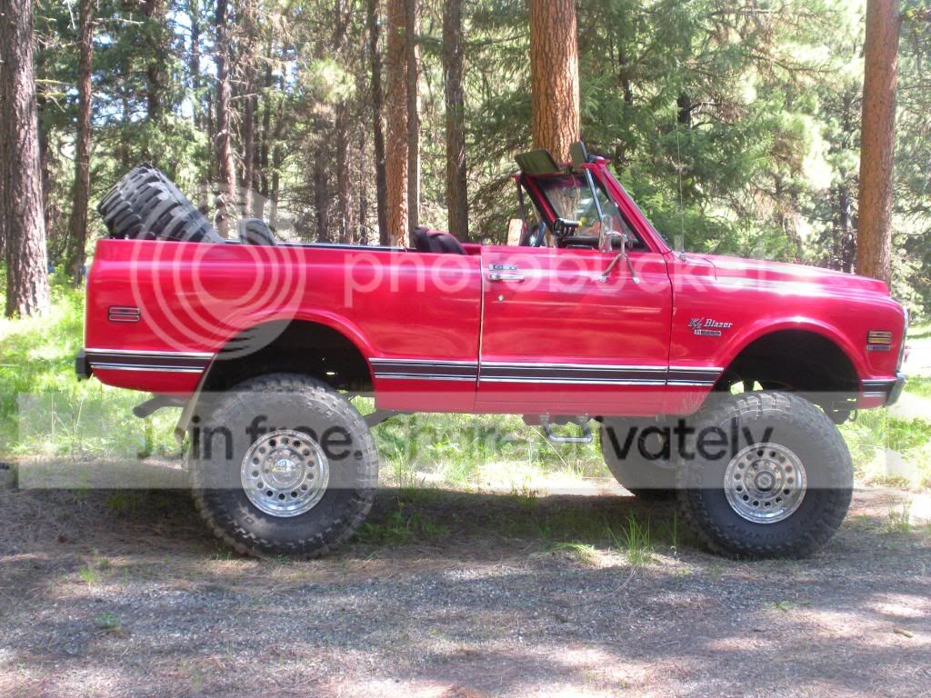

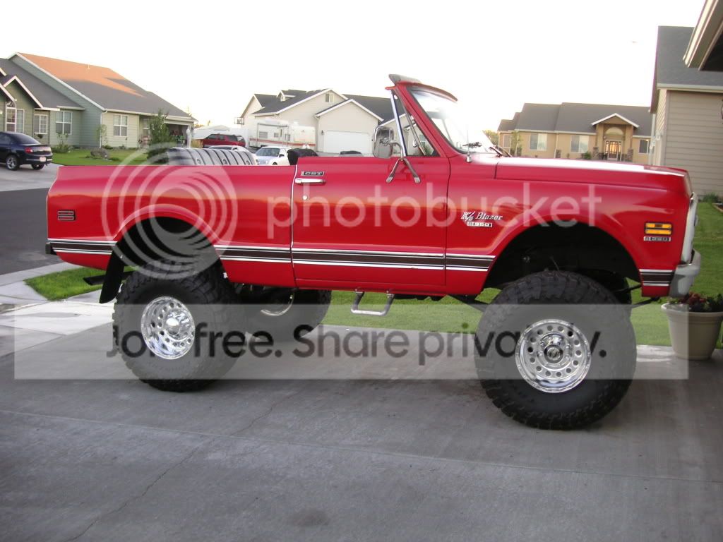

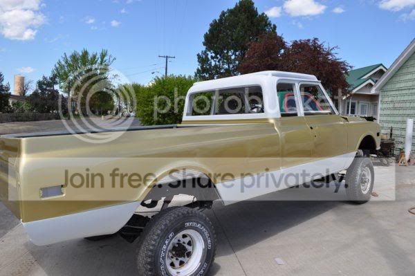

Heres when I picked it up

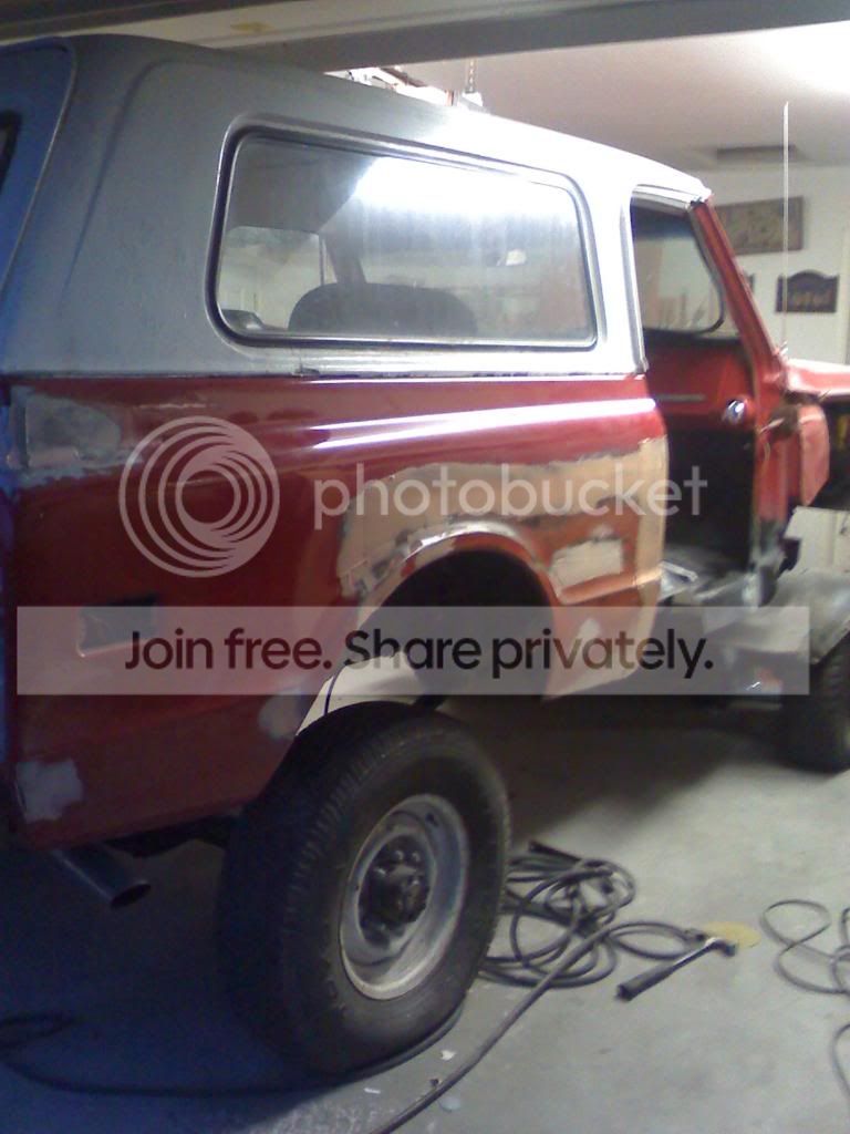

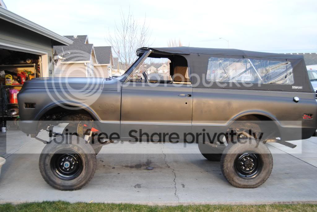

After I finished it the first time

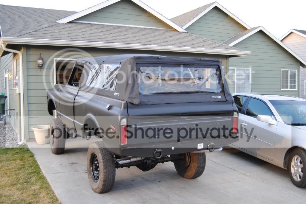

And now.

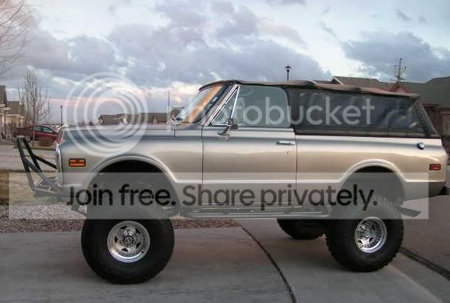

Here is the inspiration
How the heck did i never realize you were in Hermiston? That means there is a slim chance i could see this thing in person some day! Either way, I really liked the red also but im always a fan of the metalic greys. Really love the darker ones. I like your tinted liner! Cant wait to see more progress!

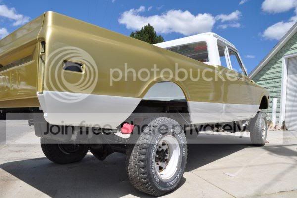

Really love these two pics! They scream eastern oregon! I got a cabin down in ukiah i go to alot. Love that country!
dude i loved the red!! why change?
I was tired of all the upkeep on a single stage paint, Plus I had body filler cracking and some pretty bad rust in the floorboards and what was left of the rocker boxes(PO used a torch to cut what he needed out of the way)
I change my mind more than a woman and flipped and flopped on going red again or not. I finally made a compulsive decision at the paint store picking out the color to tint my liner.

hows the soft top? did you ever get it figured out?
Loved the red, but have not doubt the new truck will be smokin as well. I'll keep an eye on this one.
Got the softtop figured out, Not too much fun getting it all streched out, That thing is a tight fit. It is top notch quality though.

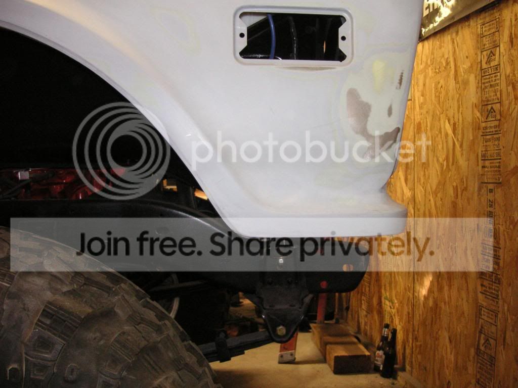

Im probably not a good guy to get some solid info on where to cut. I am using 73-91 8" lift springs, plus a zero rate. I did have some rubbing on the front fenders. Mind you 8" springs dont have a whole lot of flex to them. Here is a pic in paint of my problem area. I had to bend it back and weld it while i was doing all the body work.

Thanks for posting up those photos Justin. I really like how your buddy did the front fang. I have been thinking about taking the "lip" all the way to the front of the body after I removed the front fang. I really like the look of this better, the way the lip dies into the bottom of the wheel well.
