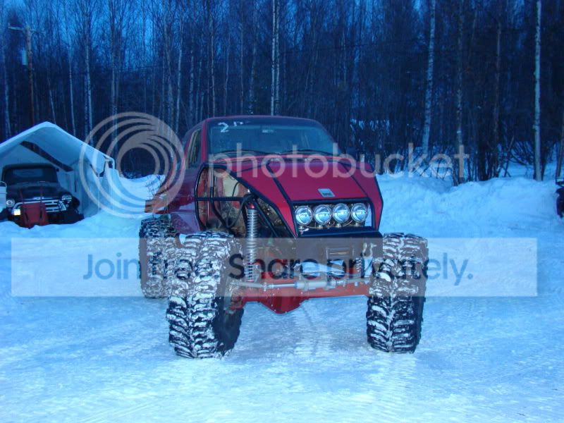

so guys im at a crossroads. the truck is too big, heavy, long, wide, etc. you get it.
so my current options are all assuming a 115" wheelbase:
1. narrow front, ditch bed, boatside
2. swap body......usig a sidekick, s10 pickup, s10 blazer?
3. full tube......using a 12pt truck cage...plus tube
so give my your ideas and suggestions
anyone else have soem views?
Start with #1. Unless you can find a real good deal on a body to swap. I think a sidekick would look a little ridiculous with that wheelbase and not be linked front and rear. You would have frame sticking out in front and back for the spring hangers
I agree, #1, maybe something along the lines of twoslo4five0's

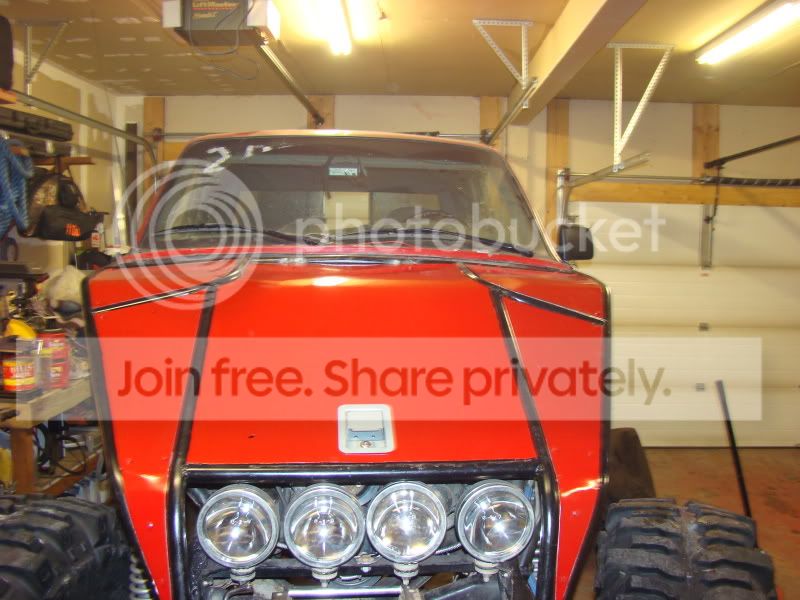

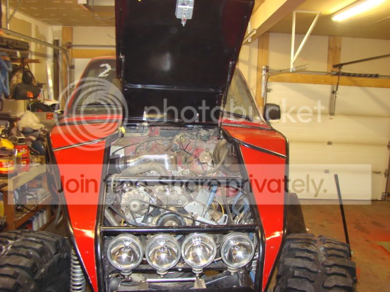

Update
Ok. So an update is due. As I had asked before I was looking for a way to shorten my truck. I shortened the truck to 112” wheelbase, did a shackle flip, I rotated my pinion using BTF perches, and a BTF dif guard. I also reworked my springs. In the from I took 6” lift springs took 2 plies out and added a long one from the rear, I also moved the shackle mount forward like in a 52” swap. In the rear I took out the overload, add a leaf, and 1 other ply. I also added a traction bar, went to a fuel cell, and reworked the shocks. Also added a smittybilt 12XRC winch
