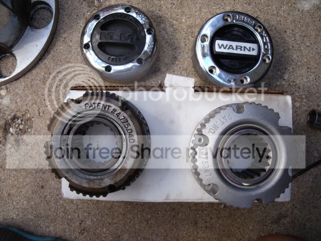

I got mine for a steal at $45 new.. Normally go for $90.
The internals look much better than the milemarker hubs I had before..

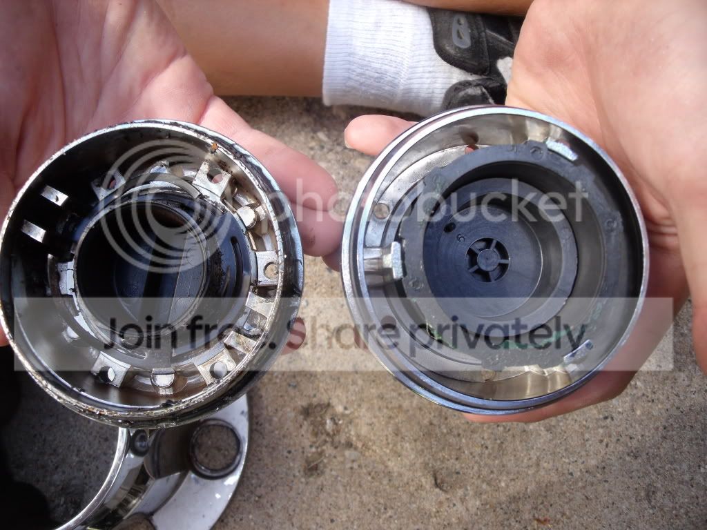

This last pic is flipped. Warn coil spring on the left.
For sure, the 10 bolt locking hubs (internal style) should be nowhere near $200.
The earlier, 3/4 ton Dana 44 external locking hubs are more expensive but the internal (later) hubs are cheap.
I vote Warn and don't look back.
Nope. Warn on the right. MM on the left.
You can tell cuz the one on the right is super clean and brand new, and the left is dirty.

Hm. Cause the warn premiums have that wave style spring in them. The standard warn's don't do it for me. But to each their own.
