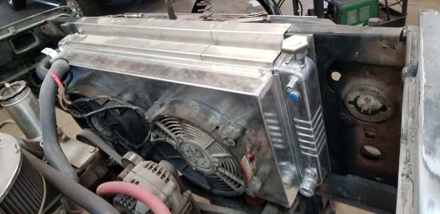

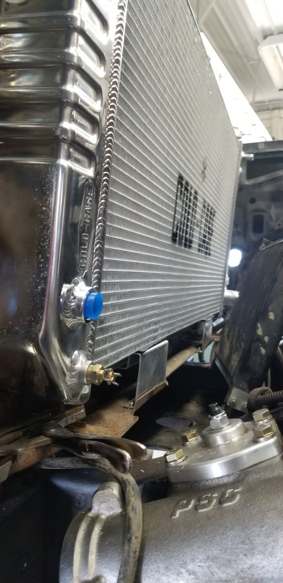

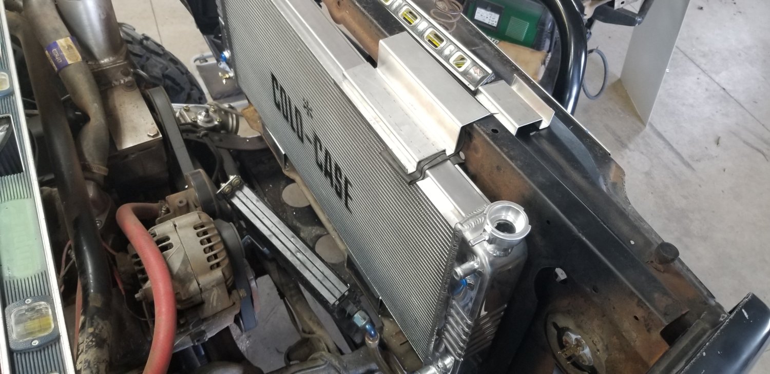

I recently put a Coldcase radiator in. I think they are a relatively new name? Bought it from summit or Jegs can't remember. It wasn't the cheapest nor the most expensive. Its an aluminum large 2 row and was a direct replacement for a late 90s gm truck. I had to build some custom mounts for it but it wasn't to hard to fit in. It was the widest one I could find. My thoughts were mor
e area more cooling. I believed it has about a 35" wide core so I have enough room for 2- 16" electric fans if needed. So far its working great with 2 - 12" electrics. It has a real nice finish and the welds look top notch for what its worth? It also came packed in quality package with foam packing all around it so it was as it should be when it arrived. Only time will tell if it holds up? I'd recommend.
