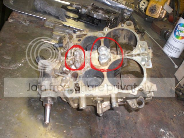

So Im guessing its the 2 on the left but thinking it wouldnt hurt to epoxy all the plugs? When I took it apart it was obvious it had been leaking for a long time.. Thick gooey varnish about 1/8" thick was all around the area circled on the left. Its cleaned up and epoxied now. Everything else was dirty but not too obstructed. I did find 2 dip tubes that had fallen free from the holes and are now back where they belong with a dab of epoxy on each of them?
What a night! I got the Q-jet back together and slapped it on the truck. Hit the fuel pump and fuel came out every orifice on the carb. Figured the float was stuck so off it came and and opened again. Back on and fuel flowed everywhere again. Tapped on it with a mallet hoping to shake the float loose with no luck. I had an old Holly 600cfm model 4010 laying around for Im guessing 10 years. I opened it up and cleaned it out with carb cleaner and put it back together. Threw an adapter on the manifold and bolted it up. Turned on the pump and no leaks! Turned the key and it fired right off and just purred. Set the idle down a bit and took it for a spin... Problem solved! :whistle:
