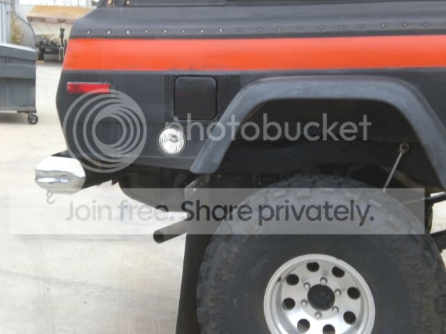

I cheated and cut in an access panel over the gas tank sender hole. Made my life much easier and I wont hesitate to keep on top of the hose upkeep from here on out. Might be the first place to look if your having similar issues. :dunno:
Id post up a few pics but I have a Jeep fsj Cherokee body on my K5 frame so it would be different. I also cut in a Burb filler door and spout a couple nights ago. I know you guys cant appreciate this but not having to baby sit a fuel nozzle for 10 minutes to put in 20$ worth of gas is just flat ass awesome! Throw the nozzle in and actually being able to us the nozzle lock is a dream come true!
