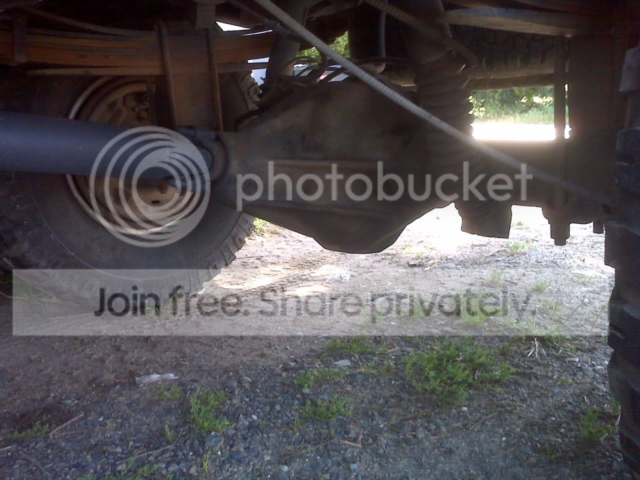

My '90 V3500 dually w/ D70-
"Normal" regular cab duallys got the same Dana 70. You sure you weren't looking under cab and chassis trucks?
