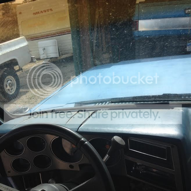

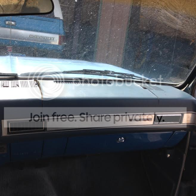

I now realized I never put some updated photos of my LMC molded dash cover up here in this thread for you guys. Sorry about that.
This things was really easy to install and fit like a glove. It's very seamless and to be honest, looks like a brand new dash but at a fraction of the cost. Essentially all I did was clean the factory dash real good to get all the dust/dirt off it. Then, like most all these square dash's, mine had cracks all over it and the wholes for the speakers were a complete joke. I ended up taking a razor blade and knocked down all the raised portions on the dash from the cracks so it was as close to a flat surface as I could get it. Sense the new dash cover is held on with adhesive, you want to make sure you have as much contact as you can get.
Then I used the entire tube of adhesive that was included with the dash cover and put it all over the factory dash pad. I then got some sand bags and placed it on the installed cover and left it there overnight....and that's it.
I think there really isn't anything that can be better than a replacement full dash pad, but if you don't want to spend that type of coin...I think this turned out pretty good IMO. Here are some pics for you guys so see
pics of factory dash with cracks:

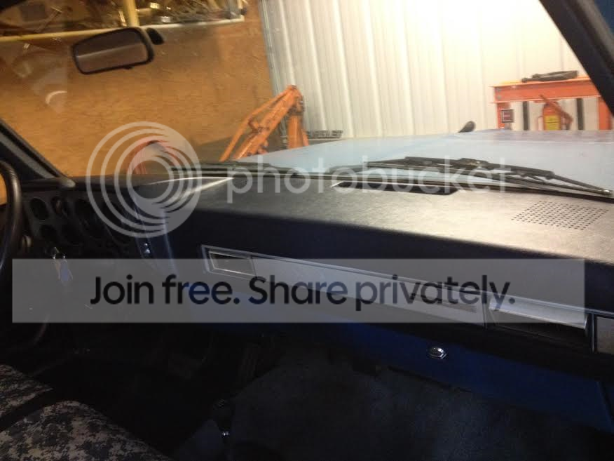

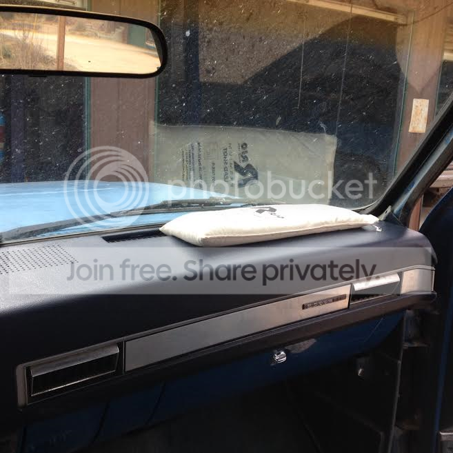

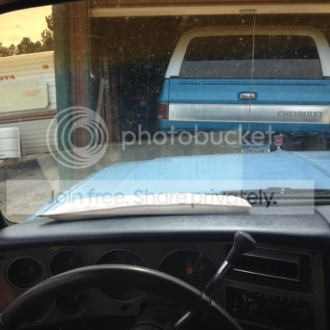

pics of molded dash cover with sand bags on it to hold it down while adhesive dried
And of the finished product

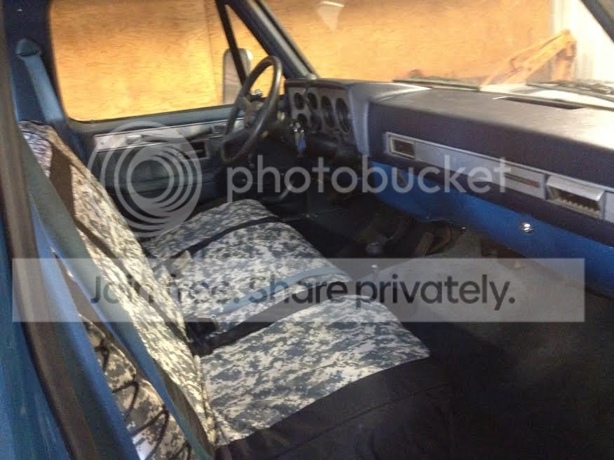

I don't think my pictures really do it justice....it was a huge improvement on the overall look of the interior. Hope that helps!
