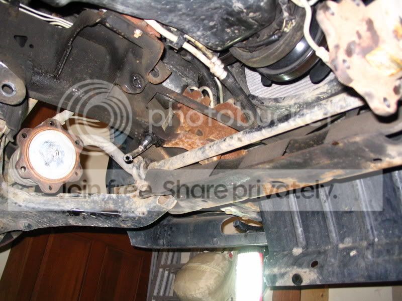

Dropping the differential isnt that hard, and Im pretty sure its the only way the pan is coming off of there...
Didnt take but a few minutes to get it out really, no more than 30 min. Here's what it looks like with it out of the way
U SIR ARE THE FRIGGIN MAN That could be the most helpful pic I've ever gooten in a group Thanks
No problem, now mind you, that picture is of my 1/2 ton but the only difference really is the diff in your truck is slightly larger, so shouldnt be anything to different between the 2.
