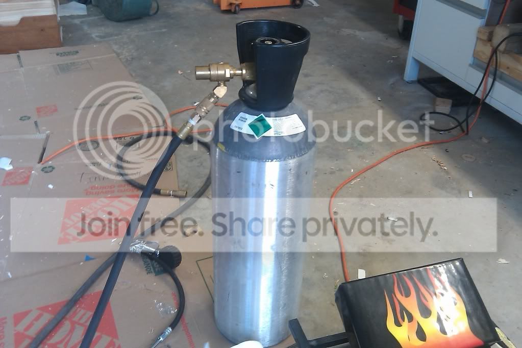

why can't I make my own CO2 tank system?
You can! It's easy and simple. I don't have a compressor right now, so its all I use. Go to wheelersoffroad.com and get the 150psi fixed regulator. $49.00. Get a tank off Craigslist and fill it. That's what I did. Under a hundred dollars. And, I have a 20lb tank.
I checked out your power tank link. Don't waste your money on that. You don't need a gauge with O2. The handle is nice, but WAY too much $. Also, find a tank on CL. Good luck.
Take a 15# DOT/CGA approved aluminum tank, http://www.beveragefactory.com/draftbeer/tanks/co2/C15.shtml
add a Powertank Superflow regulator kit, https://www.powertank.com/products/sfID1/38/productID/8
and save about $150?
I've had a 'custom' CO2 system for a few years - tank + regulator procured from the local welding place. A regulator is nice to have so you can set outlet pressure - however, it won't tell you how much is left in the tank (because of the properties of compressed/liquid CO2) until the tank is almost empty. For that, you'd have to weigh the tank... but overall, I'd say it worked very well for my purposes.
Only reason I went to an air compressor - primarily for airing up after a run; my 3/8 IR impact is somewhat of an air hog - was logistics/timeliness of refills.
P.S. I think it's a good thing to have your CO2 tank certified. Compressed gases shouldn't be trifled with.

Certified as in DOT/CGA? or something else?

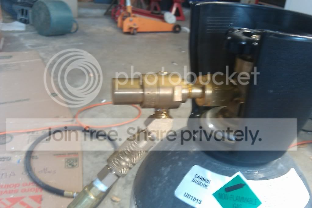

I was going with a Powertank Superflow regulator only because of the possibility of needing to reseat a tire on the rim....you know my 16.5's don't have a very big bead seat width to them. The powertank Superflow provides higher flow up to 48cfm, do you guys know what your regulator will flow?
I read to Michael that the weight of the tank is the only way to know how much you have, perhaps a portable fish scale would be handy to have???
Also, I will be using CO2, not O2 in it.

The places that handle compressed gases have a means to certify a container to meet certain specs, withstand x amount of pressure and the like. 'Some tank off CL' would leave me a bit nervous, but that might just be me.
Don't know the flow rate of my old 2-stage regulator, but I'd bet it was significantly lower that the 48cfm quoted above; some of these things are rated only up to 50 scfh...:eek1:. But keep in mind the intended usage: I (still...:laugh:) have 16" rims and 35s...
I should have clarified myself better. I bought a 20lb. Tank off CO for $20.00. It was out of date. It has to be pressure tested every 5 yrs. I believe. Anyhoo, I took that tank to a gas place, and paid $15.00 to get it recertified. They didn't do it on site, so they gave me a different aluminium tank. It looked brand new too. And then paid $15.00 to fill it. So, for $35, I got a new tank.
Hope that cleared thing up a little. I wouldn't trust a tank off CL without getting it tested. A lot cheaper than a new tank + shipping.
There will be a date stamped on the tank. It has to be static tested every so many years. 5, if I remember right.
This you must do!
Not just for legal reasons, but for safety reasons. Also, there is a rupture disk on the valve on the opposite side of the nozzle.
Take the tank to a compressed gas refiller, and get it tested or swapped out. If they give you the same tank back, make sure they replace the rupture disk.
The place I spent most of my life working at, went through about 200 20# cylinders and probably 60 50# cylinders per week in the summer.
So, I know a little about CO2 cylinders.
We bought the gas from a dealer instead of filling them ourselves. We had the ability, but not the ability to test them.

If you are going to mount a cylinder in your vehicle, make darn sure it is well strapped down, the valve is not pointing at anyone in case it gets snapped off, and try to put it in a well protected position so that if something happens to the truck, it will be unlikely to receive a penetrating injury.

really appreciate the input guys, Fordum sounds like you've had your share of fun with em.
The tank I was looking at is new for 113 with shipping, has the certs and the proper valve/w rupture disc and is rated for 1800 lbs. w/ a 3000 burst limit.
I think I'll check my local gas supplier for pricing too.
The regulator specs say it will increase pressure by 10# in a 40x15 tire in 41 seconds, and with a 15# bottle will do it 14 times.

You are dealing with a phase change when you release this stuff. Unlike an air tank, where you are just releasing pressure, you are converting this from a solid or liquid to a gas. Which means it is going to suck in large amounts of heat.
Everything that the "liquid" touches is going to hit about -100F.
If you are dumping it fast enough, the brass regulator and any metal fittings will cause bad freeze burns. As will the solid dry ice that will come out with fast release.
Not to mention that it could damage the rubber tire or valve stem.
If you were to get some of the solid into the tire, unlikely but possible, it would continue to sublime inside the tire until either it was all gone, the tire pressure reached about 1500psi, or it blew. Whichever came first.
I'm not trying to dissuade you from using it. But, its like a really strong winch. If you treat it with respect and know how to use it, it will do you a great job.
Handle it wrong, and it will hurt you.
