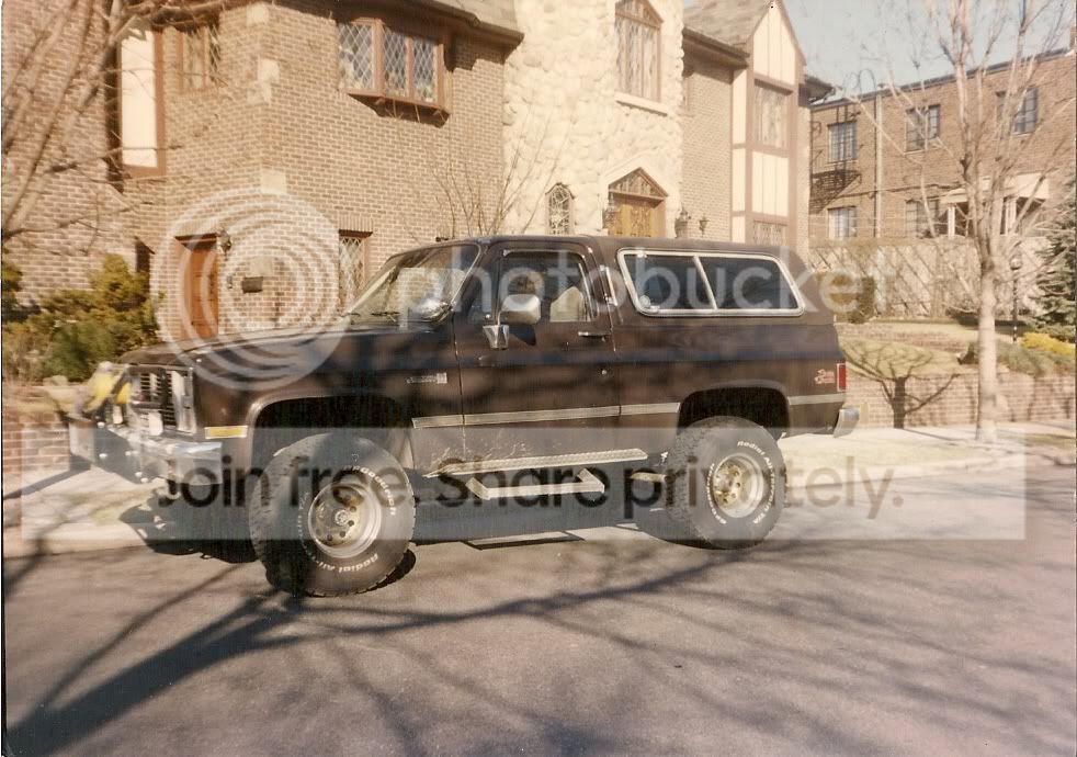

here's my truck on 35's with a 10" rim and a 2 1/2" lift.....i drove it for a day or so to test it........sawzall fixed it fine and i had 4.10:1. went to an 8" rim too
nice pics. shovelbill80 i know 35s would be pushing the mechanical boundaries of my stock suspension and running gear but $200 is hard to pass up for 4 new tires, and although my 33s appear to be in good shape they all have dead spots and thus is probably just as abusive driving it the way it is. (quite a bumpy ride till i get above 25-30:dunno:) still, i appreciate the feedback, and i think i'll hold off till i can find a set of 33s for a good price, stay patient, probably the most logical thing i can do at the moment. probably not a good idea to trade one problem for another in my particular situation. i think the brown one's lift/tire combo is very porportinate to its body size, and i don't think i'd like 35s on mine w/o more lift. it was mainly the availability of these tires that got me thinking, and looks, yes looks are important. if they weren't i would have bought a hyundai lol. thanks again for feedback.
