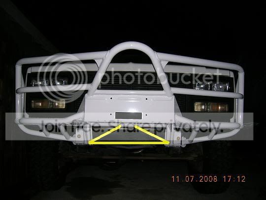

Here are the powder coated pics. It came out BAD ASS, I like the White. Makes my burb look like crap though lol! When I Line-X the interior I will have then coat the top of the diamond plate plateform for good traction. Now I need a back bumper. In this pic it only has two bolts holding it on. Will bolt it up tomorrow. Wanted to get it on tinight. Picked it up by myself and put it on. I have to get my upper body in the stinger and leverage it back and up onto the frame horns. It AIN'T easy! but I can do it. The frame adapters are not installed yet. 3 more pics in the next post too.
last of them. I actually completed my first bumper FINALLY!! The picture from inside is my view, held the camera up to my brain bucket and took the pic.

I like the white. Got anything goin on under the winch?
Do you mean the open area underneath in the center in the pic? No not really, It just worked out that way. Might be a good idea to build a cross member towards the frame horns that ties into the bumper mounts though. Would make it hella strong up there. Thanks Kert for bringing that up, a light bulb just went on over my head! :D.

Yep like it If you added a bar to the bottom between the frame horns it would be almost perfect. Im not sure but a diamond plate alum skid plate like filler might look pretty trick too.
Yep like it If you added a bar top the bottom between the frame horns it would be almost perfect. Im not sure but a diamond plate alum skid plate like filler might look pretty trick too.
Clarify a bar, top to bottom, between the frame horns? I'm not picturing it. The "top to bottom" is losing me. I like a crossmember skid plate tied into everything idea. I will work on that idea.
Sorry spelling error subtract the "p" from top :haha:Fixed it! My fingers type faster than my brain works.
I mean a horizontal bar as low as you can between the frame horns. Then for the skid plate attach it to the winch mount base and run diagnal back and down so that it basically fills in the whole bottom part between the frame horns. The bottom would attach to the bar im talking about.
This is just what I would do I think it would add a TON of strenth. It would add support to the winch and also side to side in the event of an inpact.
Then cover the yellow bars up with the alum skid plate.
I will have to view the pic when I get home, At work it doen not show up, is only a red X. Thanks for the suggestions! I get what your describing. :waytogo:
