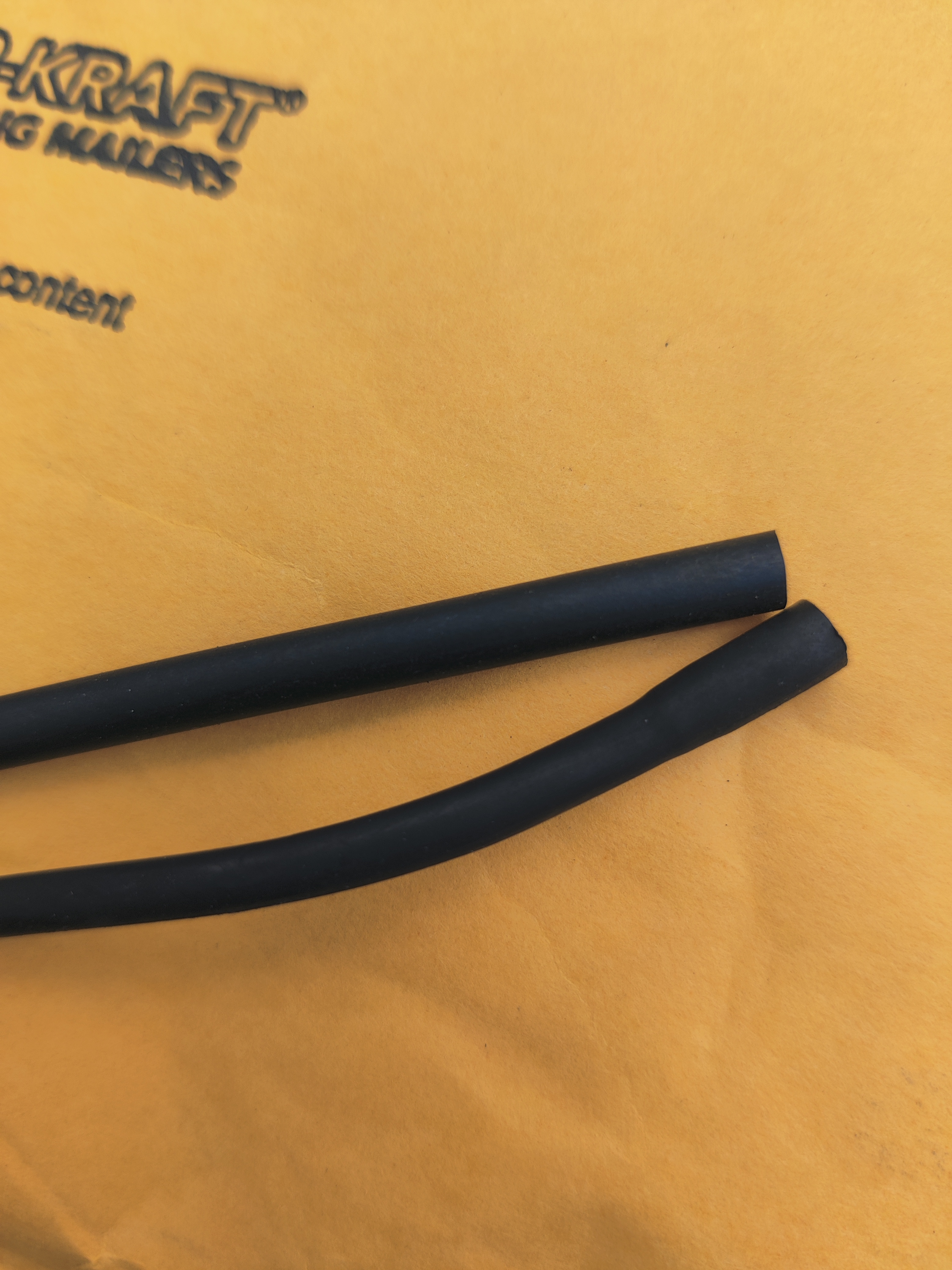

With heat it may be possible. Hadn't considered that. The end that didn't break has a pretty good flare to it from age, so it would need to expand a fair bit.

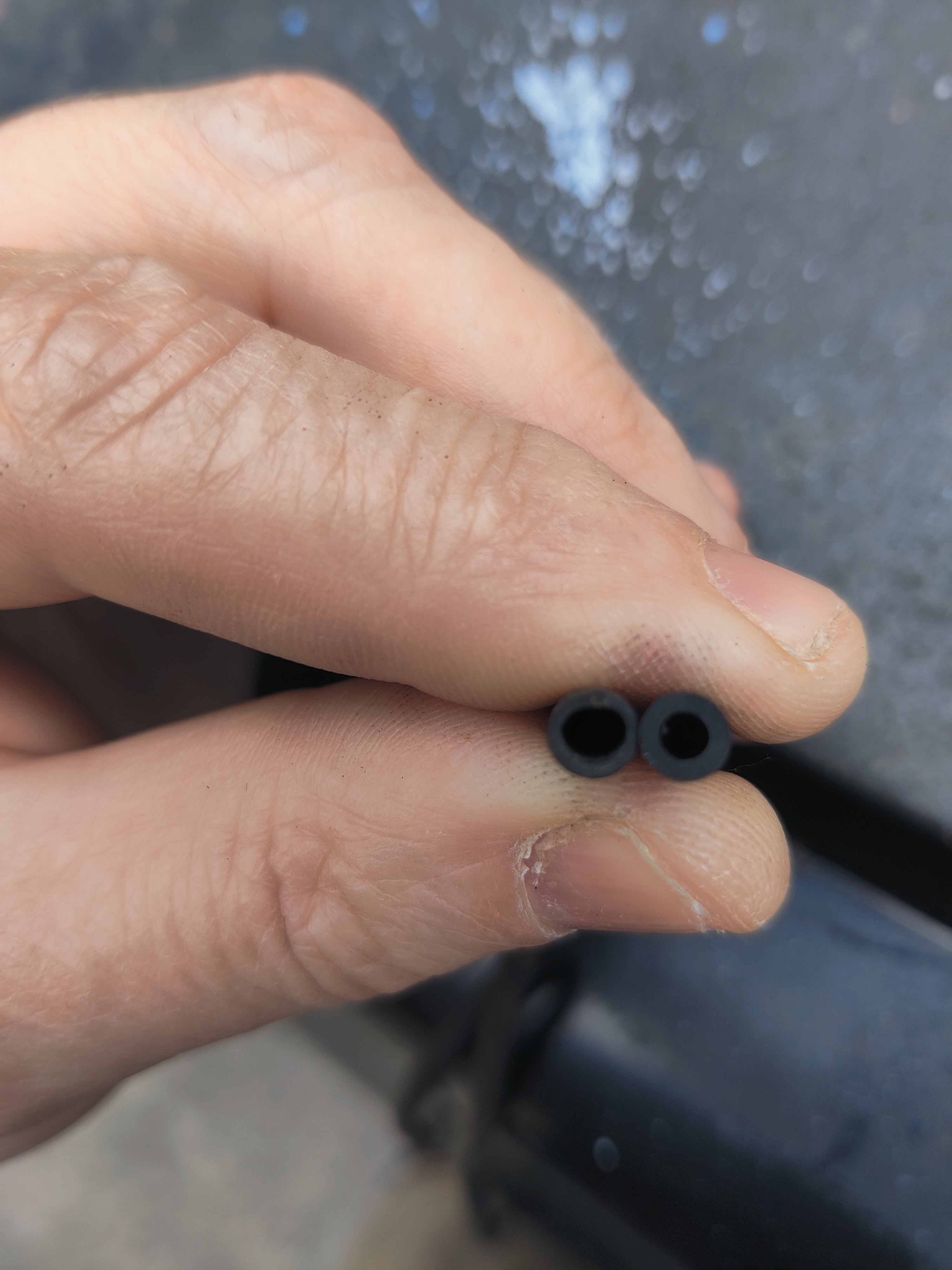

$10 isn't going to kill me to buy from LMC and (apparently) have stuff that is correct. But I'm pessimistic it IS correct...GM manual says its 3/32, which is exactly what I measured, but ALL the 3/32nd hose being sold, to include GM "NOS" off eBay, has the wrong outer diameter and wall thickness. The OEM hose is .156" OD (5/32), .093" ID (3/32) and approximately .025" wall thickness as measured with my calipers. The difference between what I got and what the online vendors show is more than just measurement error.

Alright, got the LMC stuff. At least they give you enough for ~3 wiper arms. 51". OEM hose length is 15.5" per wiper arm.
They are selling the wrong stuff. Theirs is .175 OD, .043 wall, and .10 ID.
It does, however, fit. I had to remove the wiper arms to be able to use a jewelers screwdriver to force it into the spring, then bend it enough to pull it out the other end. But the ends fit over the nipples and it will work.
