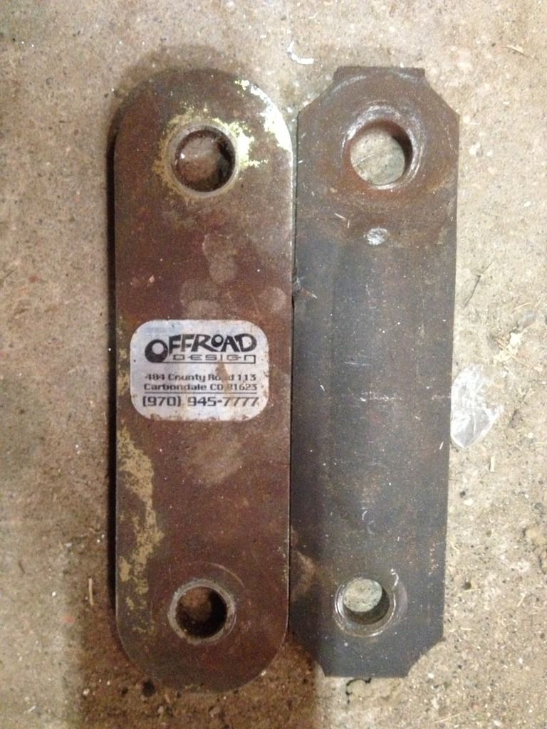

I also assumed (always a mistake.....) that the bolts that came with my FUSH's were the same size at both ends of the shackle.
They were not.

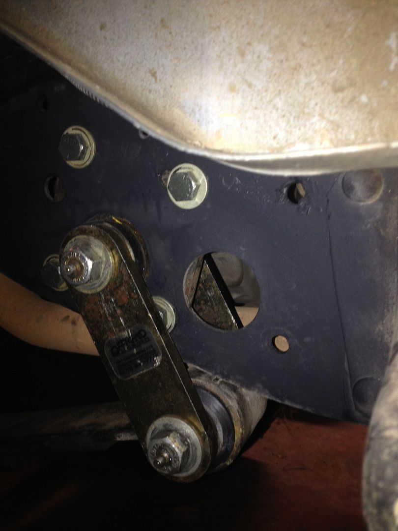

Here are how mine sat when I first installed them. They have sagged some so the angle is a little steeper now, but works great.
On ord's Web page, it says it's shackles are the same length as the 89-91 factory shackles which are either 1/4" or 1/2" longer than the rest. And they also have bigger bolts on the leaf spring side. And possibly the fush side, but I can't remember for certain. I just remember it was a bitch when I put 73-88 lift Springs in the front of my 90 cause then the hole in the shackle was a different size than the hole in the leaf spring bushing sleeve.
When I had 52's in the front of my blazer and the shackle mount moved forward I started out with 7.25" shackles. That increased my caster angle which gave me deathwobble. So I switched to some 6" (I think) shackles, but the spring end would hit the frame where yours is hitting when flexed or just hitting bums in the road. I also put on DIY4X's front spring mount and moved the spring all the way forward and still had the same problem. Eventually I just swapped back in my lift springs and 4" shackles (stock length) with the springs all the way forward on Kurt's mount to keep my axle moved forward.
I added some small (I think 4 degree) shims under my front springs to correct the caster. I don't drive mine on the street, but I was having binding issues at the pinion joint when the pass side would flex way down.
Well ORD didn't have different length shackles on their site, so I called DIY4X and ordered both a 6" and a 7.25" shackle. Ordered two greasable bolts and the hardware to bolt up the FUSH's.

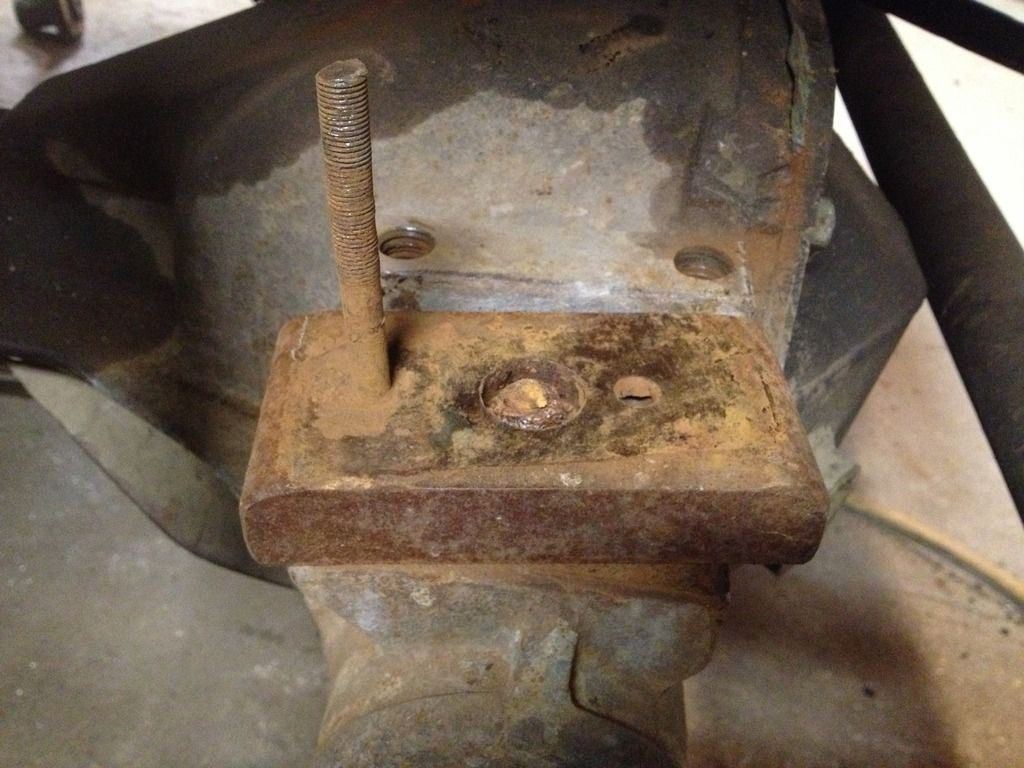

I forgot to post this picture.
The center pin on the zero rate is stuck in the Dana 60. I had to take the center pin loose from the spring pack. and pull the spring pack off. A real pain in the ass. Especially with the crossover steering drag link right over the top of it. I'll have to fight that loose to get it all back together.
