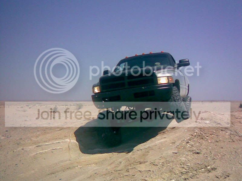

you got it....cure to my DW???...pics inside...

My panhard/trac bar solved my death wobble issues. I had it bad and now it is all gone. Everything on the front axle was redone with new stuff and still had it bad. I know my caster is off by 4* but it works well now.
That crossmember and track bar are really nice looking, but I fixed my DW with 6800 airsoft BBs. 20 bucks and an hour worth of work.
